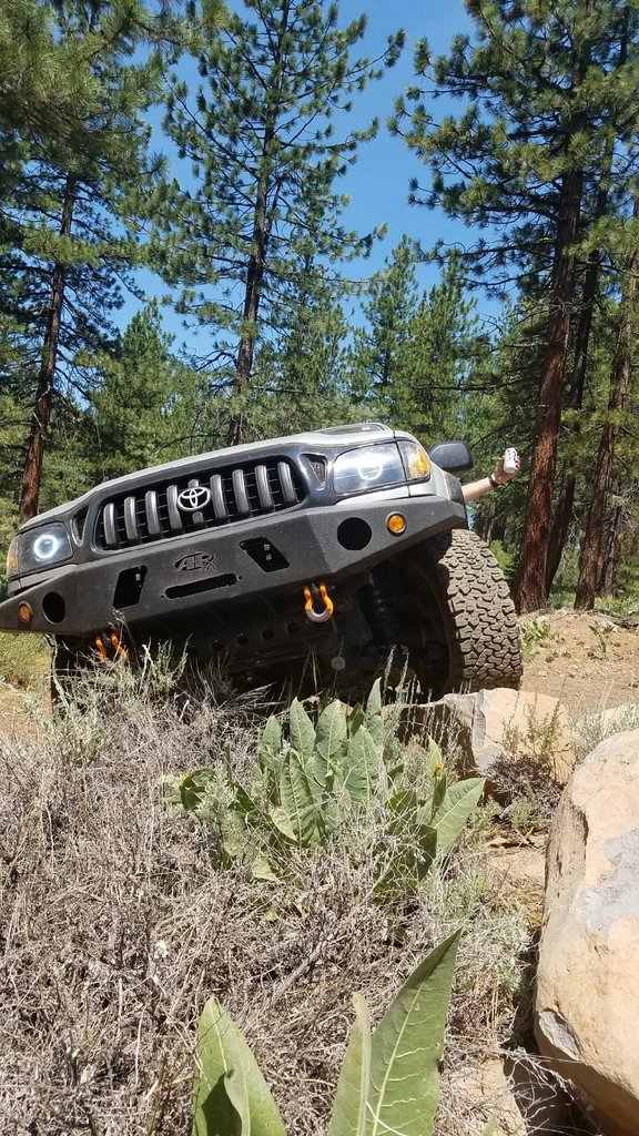

    Couple more pics from the weekend.

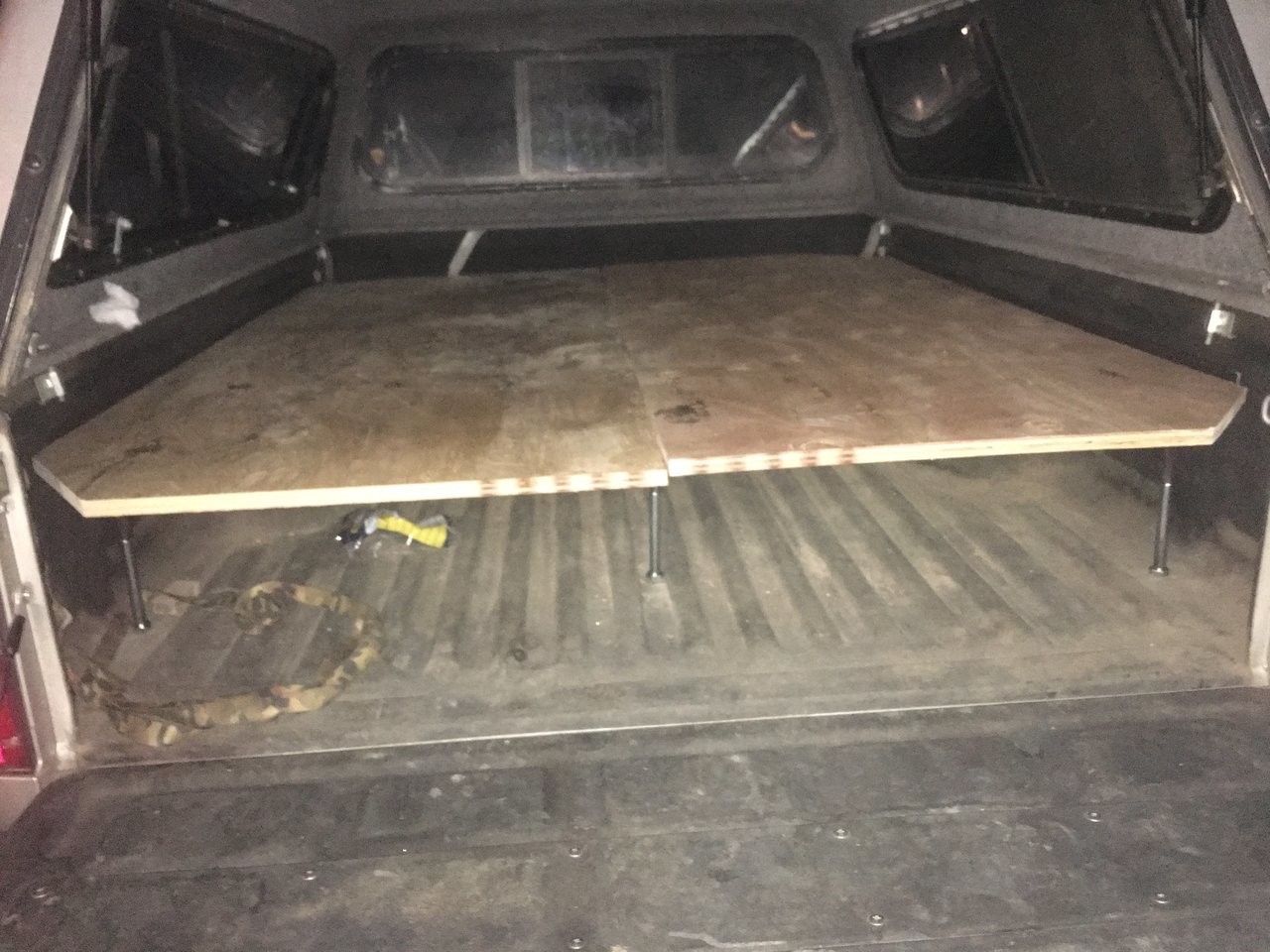

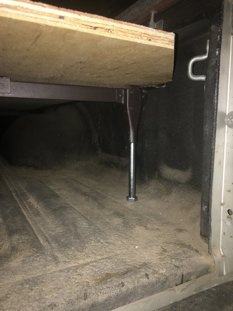

    Made a bed platform tonight. I found the idea on here in the mist of a random thread. Used a metal bed frame. Hammered in 5/8 bolts in to the legs to clear the wheel wells and 3/4" plywood. Turned out pretty good and leaves me with good space under.IMG_6425.jpgIMG_6426.jpg

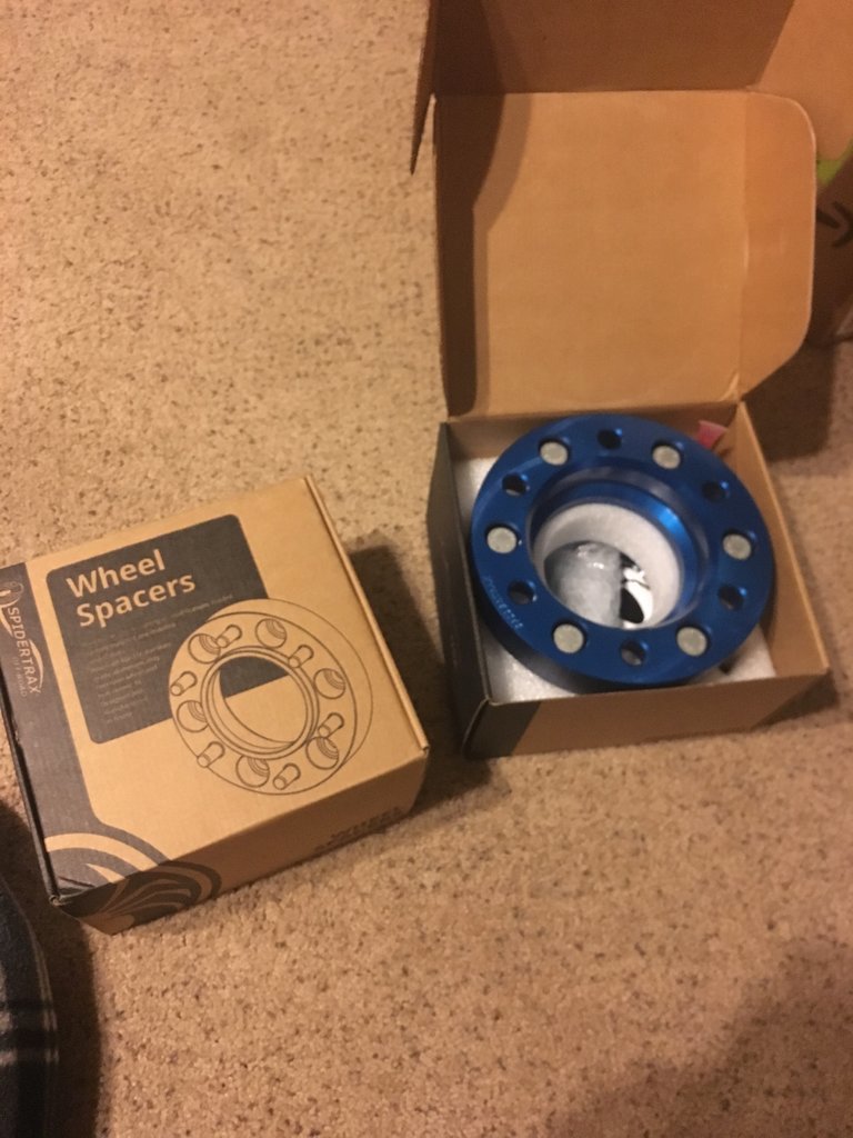

    Tires are on! Looks like I need some wheel spacers though as I am getting some frame rub. Any suggestions? IMG_6481.jpgIMG_6479.jpg

    How bad is the rub? With those rims it's typical to run spacers or you can get different rims

    It's not horrible. Only on full turns. Thinking a 1.25" spacer will be good.

    Could try a 1" if you can find some, but 1.25 would have a better stance

    Wheel spacers came in late tonight. Was hoping to get them on today but I'll throw them on tomorrow after work.

    Wheel spacers are onsbd it clears the frame. Now it's slightly rubbing the very bottom of the fender. I trimmed the plastic and that helped but its still rubs
