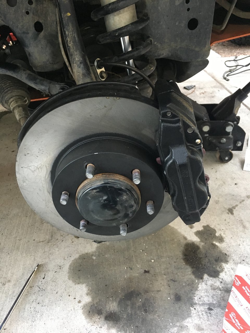

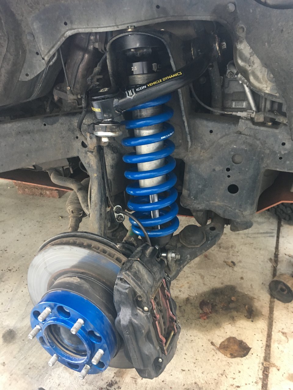

    Tundra brake swap is completed! Actually did the mod last weekend. I love the smooth braking now. I have much more petal and fantastic stopping power. I don’t feel like I need to slam the brakes to stop at a red light anymore. Overall very happy I did the upgrade.

    That looks like it came out awesome! Nice work :thumbsup:

    Definitely! The hardest part was breaking the upper brake line nut loose.

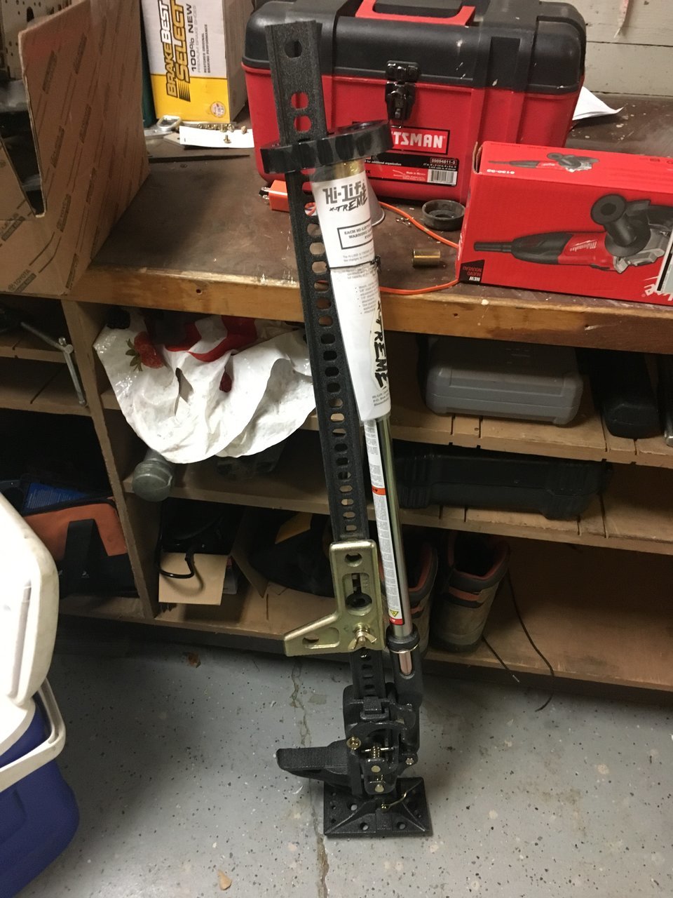

    Where am I going to put this? I have no clue lol My pops gave it to me for Christmas!

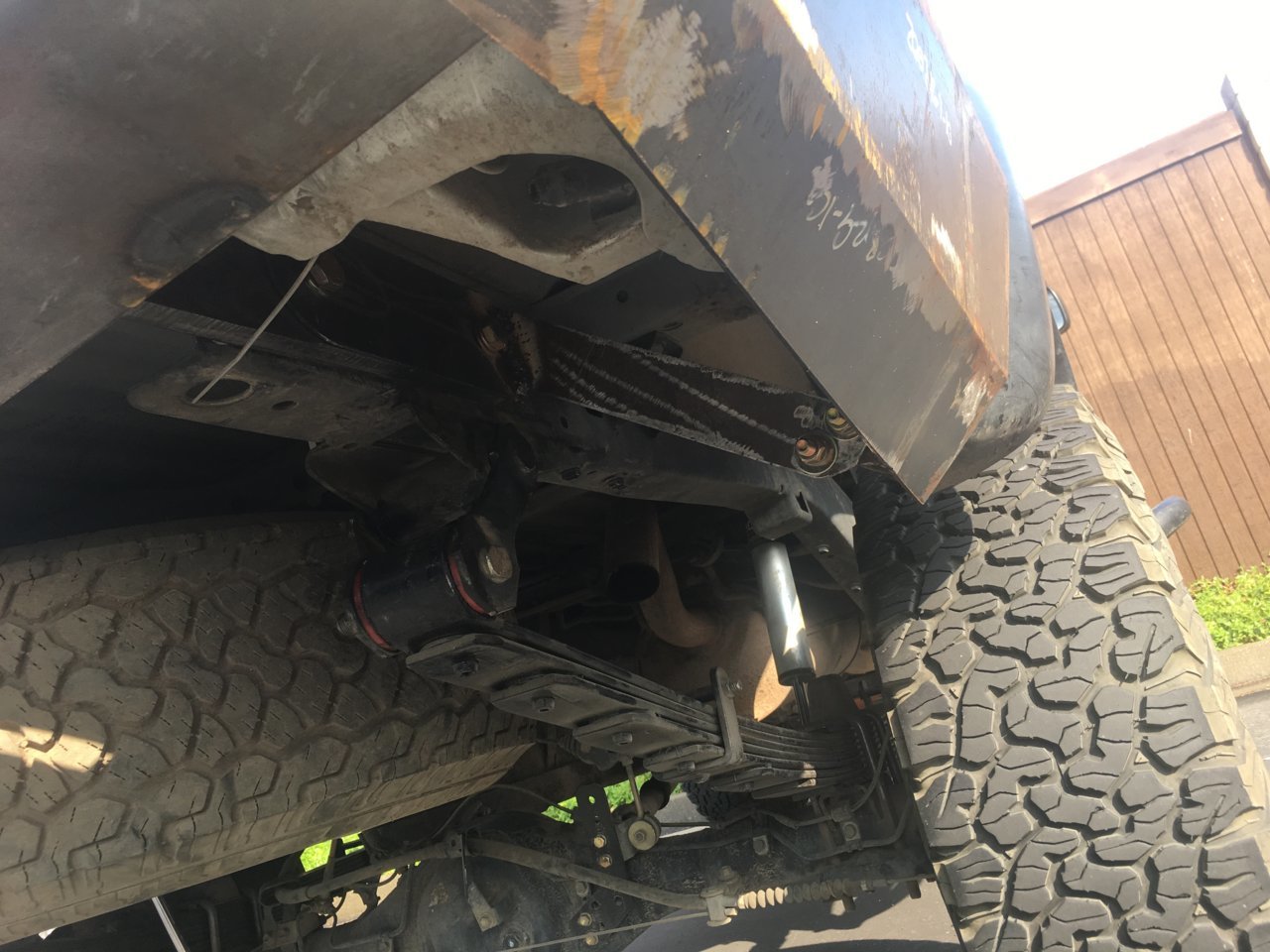

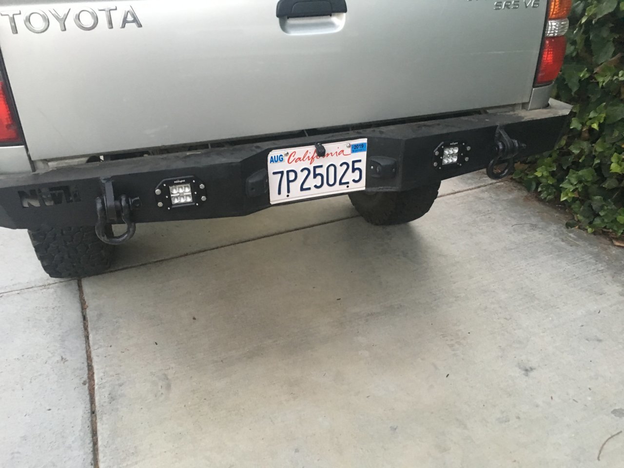

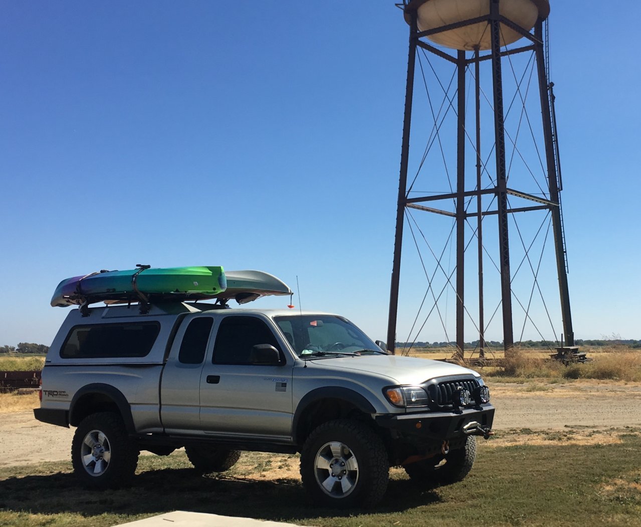

    Bumper is welded and on! Alcan springs are on. This is from today on my way home. You can see the new springs handle the load great and still provide good lift.
    Arctic Taco and boostedka like this.

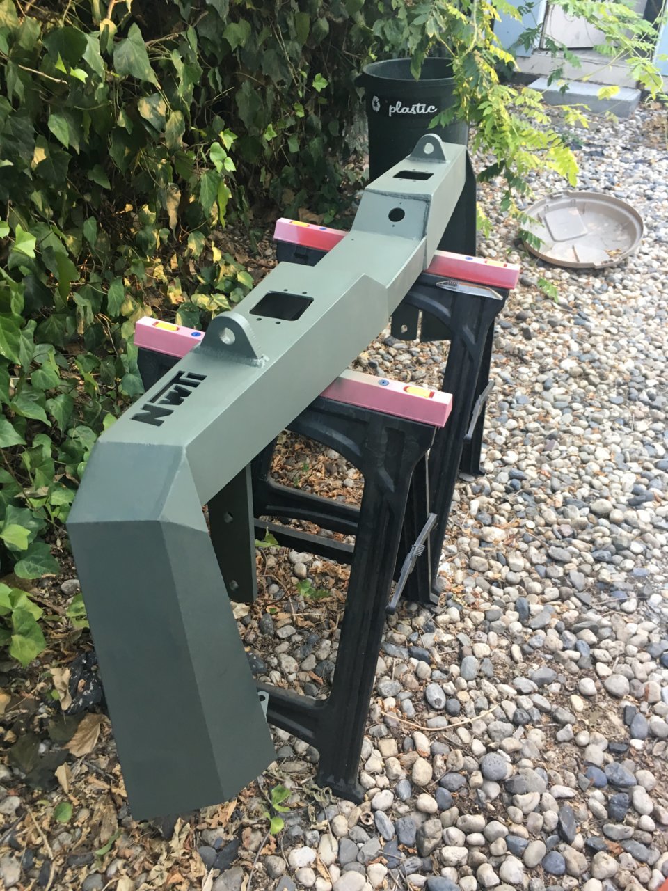

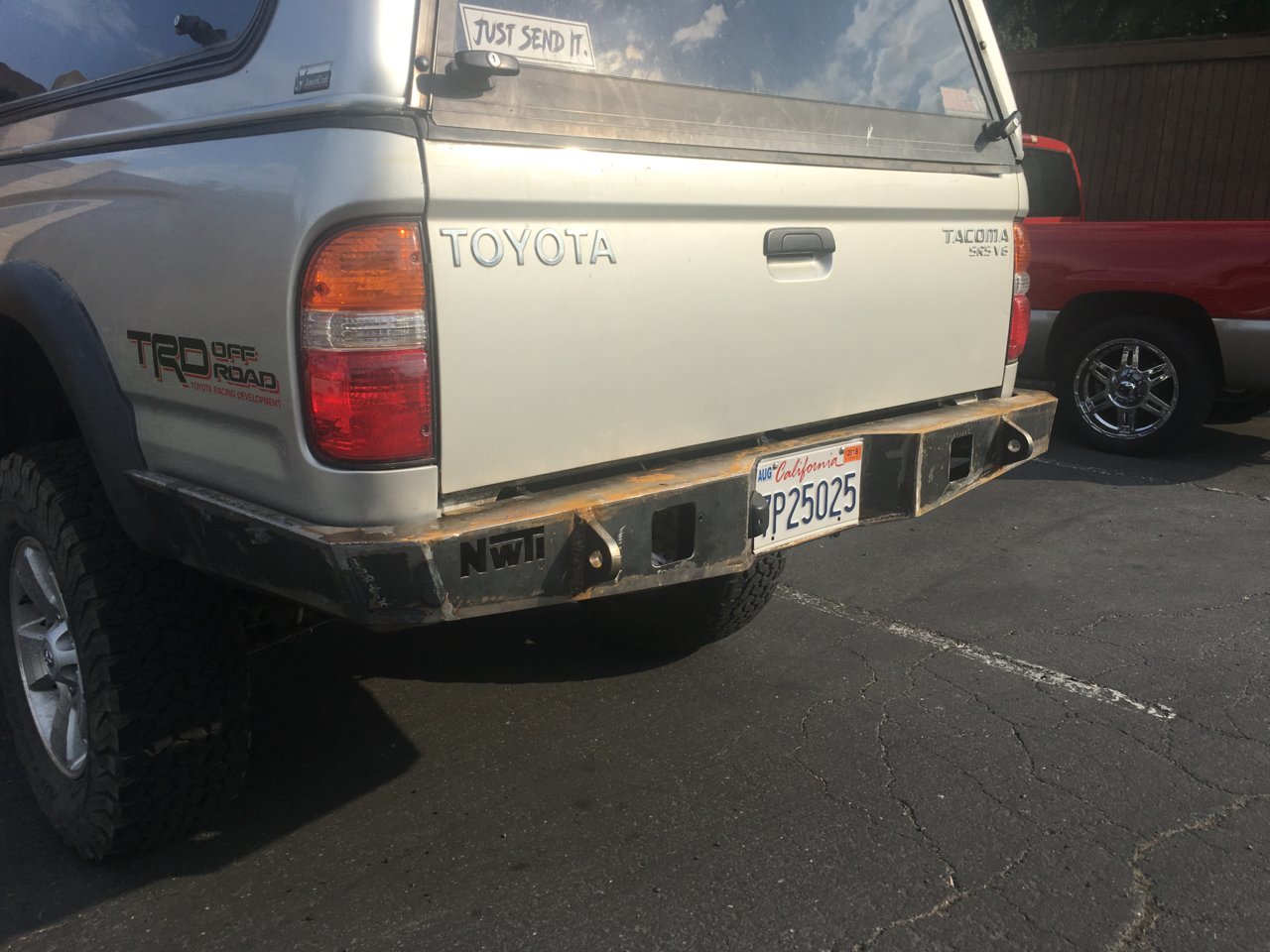

    Do you have any more pics of the rear bumper? How did the process of welding it up go?

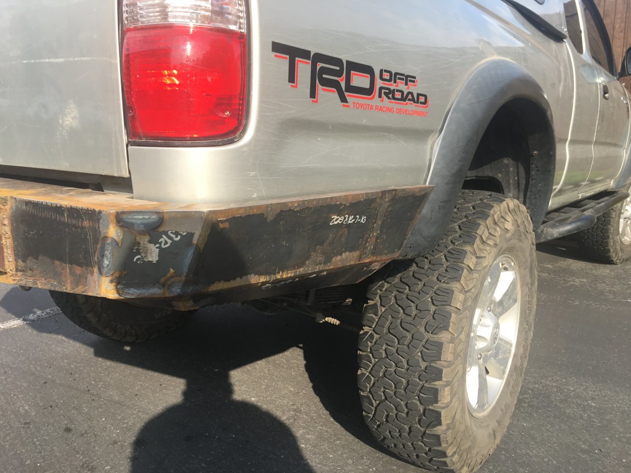

    So my uncle did most of the welding. He’s a retired welder from the iron workers trade. He welded pretty much all of it on the bench and then we put the mounts on the truck and welded the bumper to them.
    Took quite a bit of filament cutting and grinding. The tolerances of the pieces were loose thus took some extra work. I think for the price of the bumper the kit could use some work and would have better instructions.
    With that being said I’m happy with the bumper and I think it looks great as well will be good protection.

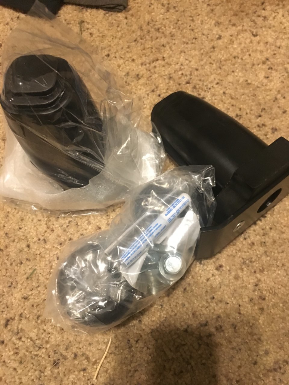

    Haven’t done much on my list above, hoping to tackle some of those things next weekend.
    Picked up a few other things that I plan to do as well.
    Durobumps front and rear bump stops.
    Also got one of these on cyber Monday!
