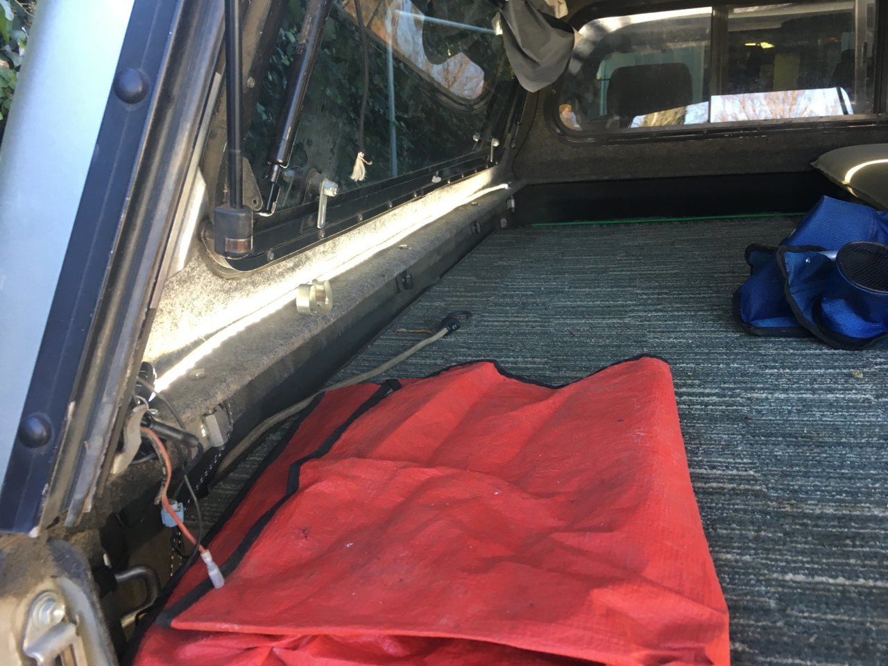

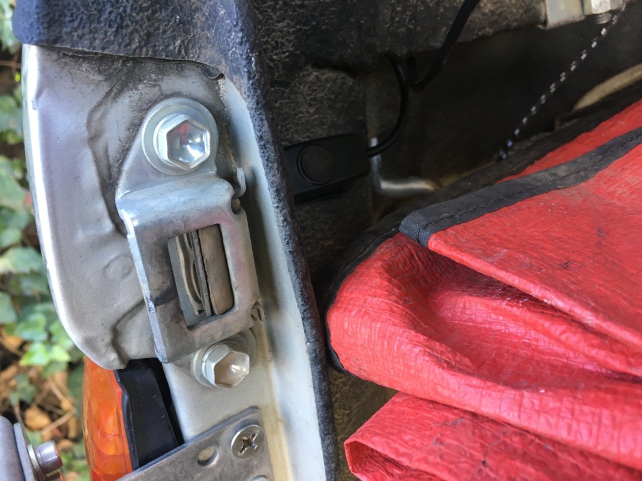

  6. Dec 27, 2018 at 6:31 PM
    #166
    Dan8906
    Dan8906 [OP] Well-Known Member
    Jul 26, 2016
    #192977
    5,150
    Daniel
    Concord, California
    2004 Tacoma ext cab TRD 4x4
    CBI sliders, ADS extend travel with compression adjuster coil overs, 9” Bilstein 5125 rear shocks, Icon Tubular UCA, Alcan custom leafs, All Pro Apex bumper and skids, NWTI rear diy bumper, 295/70/17 Cooper St Maxxs and nitro 4.88s.
    Installed some lights in the bed so I can see a little better.
    E5D46526-8890-4D77-9D61-055D52FB9244.jpg 0A46A4D2-9D2E-4E67-8E61-71CE6BCB8858.jpg 67E712A7-C3EB-49C8-99F7-7A252F12869D.jpg 48C57C55-5734-45F8-9175-990257B05149.jpg

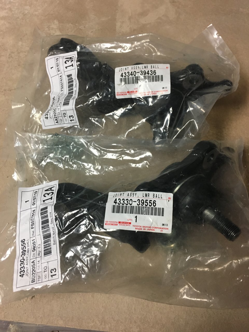

  15. Feb 1, 2019 at 1:01 PM
    #175
    Dan8906
    Jul 26, 2016
    #192977
    5,150
    Daniel
    Concord, California
    Got some new lower ball joints. Plan on doing a 90k overhaul(6k miles to go) trying to spread the purchases out some. Next I want to get new inner and outer tie rods, steering rack bushing and possibly a new uni ball for my icon uppers. I will also be doing the timingbelt at the same time.
    I want to do it while the used parts are still good and can be used as trail spares. Figured those will all be nice things to have in an event something breaks
    BYJOSHCOOK and boostedka like this.

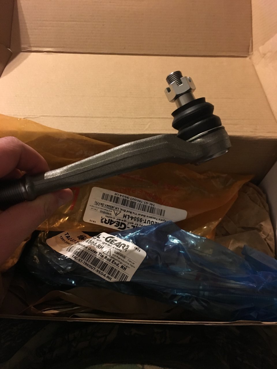

  20. Feb 26, 2019 at 8:43 PM
    #180
    Dan8906
    Jul 26, 2016
    #192977
    5,150
    Daniel
    Concord, California
    So these showed up today.
    Inner tie rods and new boots are showing up tomorrow.
    So Friday the truck is getting new tires. 295/70/17 Cooper ST Maxxs
    And Saturday I’ll put on the new LBJs, outer tie rods, inner tie rods w/ new boots and new energy steering rack bushing. Hopefully Sunday I can get an alignment.
    cazinpa, BYJOSHCOOK and boostedka like this.
