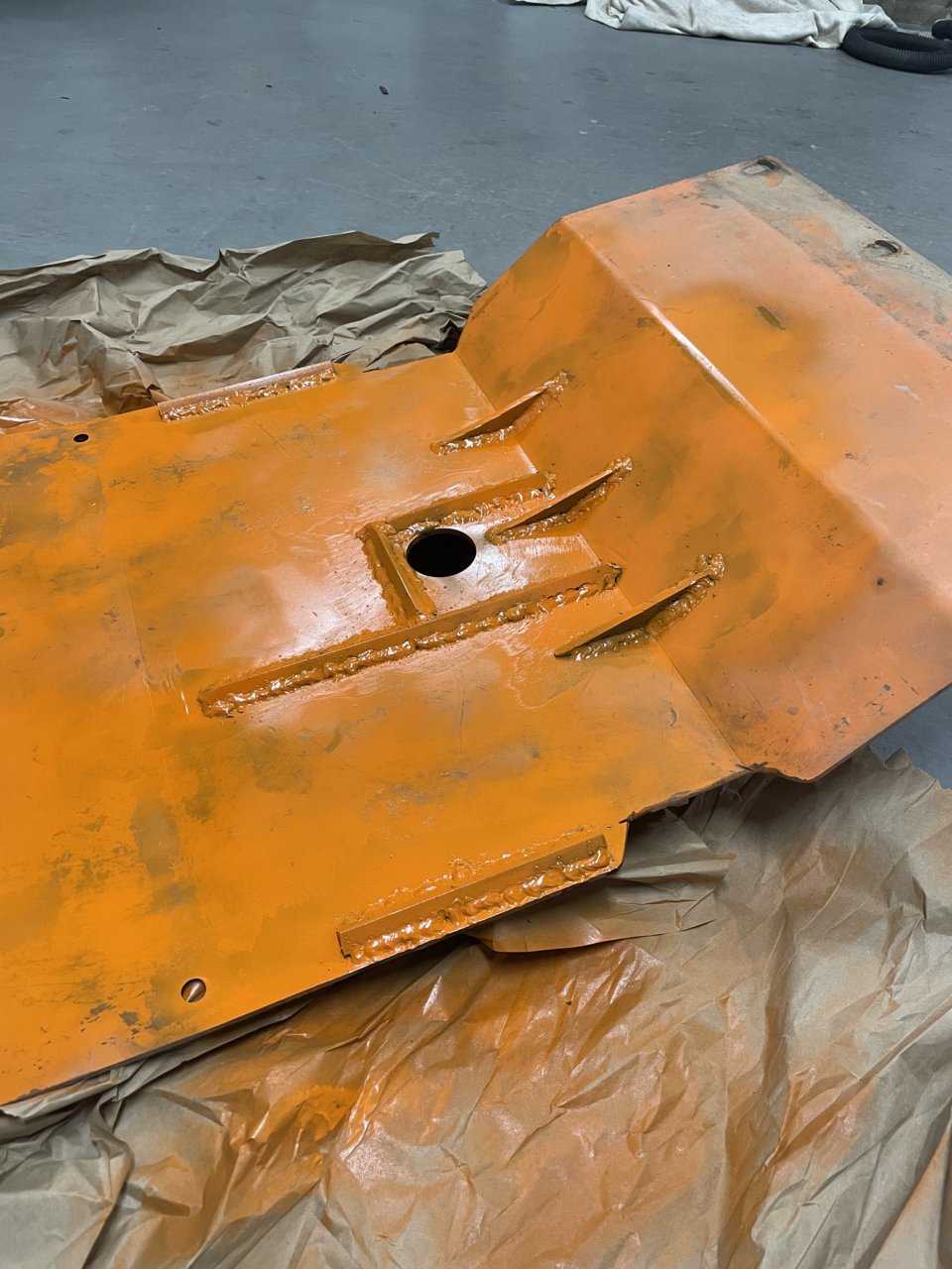

    Added some beef to my skid plates to help keep it from bending. 21873035-99F6-46D5-A0C7-B1399958D846.jpg

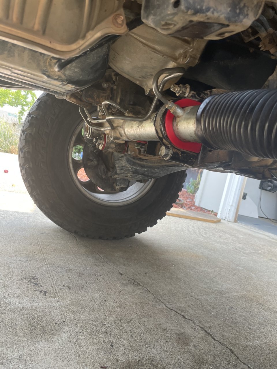

    Also replaced my rack bushings. Went with Total Chaos bushing this time as the ES ones have not lasted me very long in the past.

    betterbuckleup
    betterbuckleup Well-Known Member
    Jun 26, 2017
    #222483
    4,230
    Ian
    Concord, CA
    2000 Tacoma SC 2.7 4x4 5spd
    You'll get much better life out of the TC bushings.
    Mine have been solid for 38k miles since I installed them in 2018

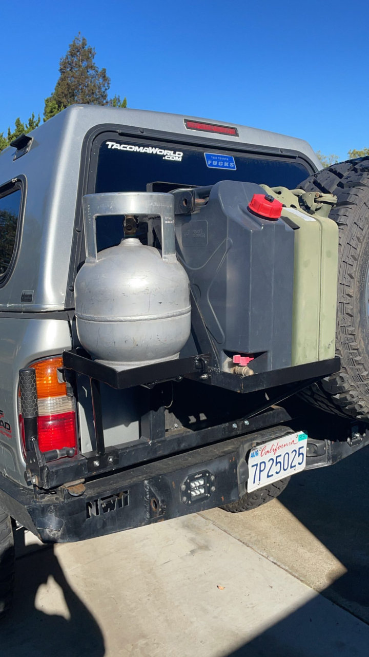

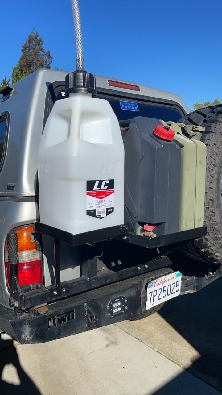

    Threw together a little bolt on mount for either a moto gas tank for trips that require more than 5 gallons of gas (have a Death Valley trip coming up that I need it) and also works with my newer 10 lb propane tank that I have been bringing camping to fuel my propane fire pit(super nice to have to use during fire bans). Both just get strapped in with a racket strap.05B1FF82-0244-46FA-A59B-2A1BA48E68E9.jpg 27937753-3116-4934-AE4B-32784FC5C255.jpg

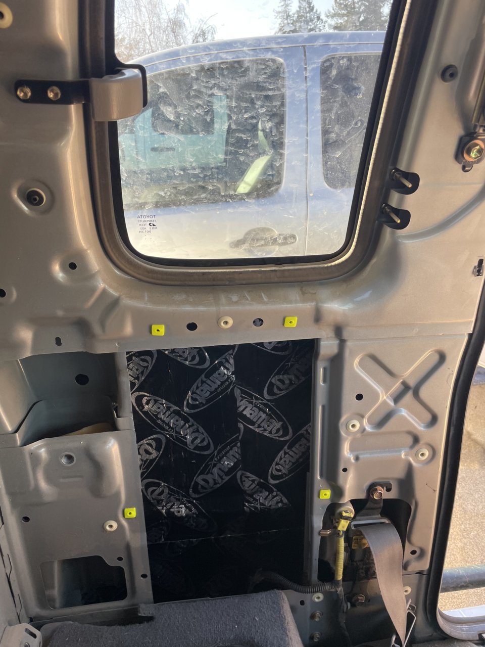

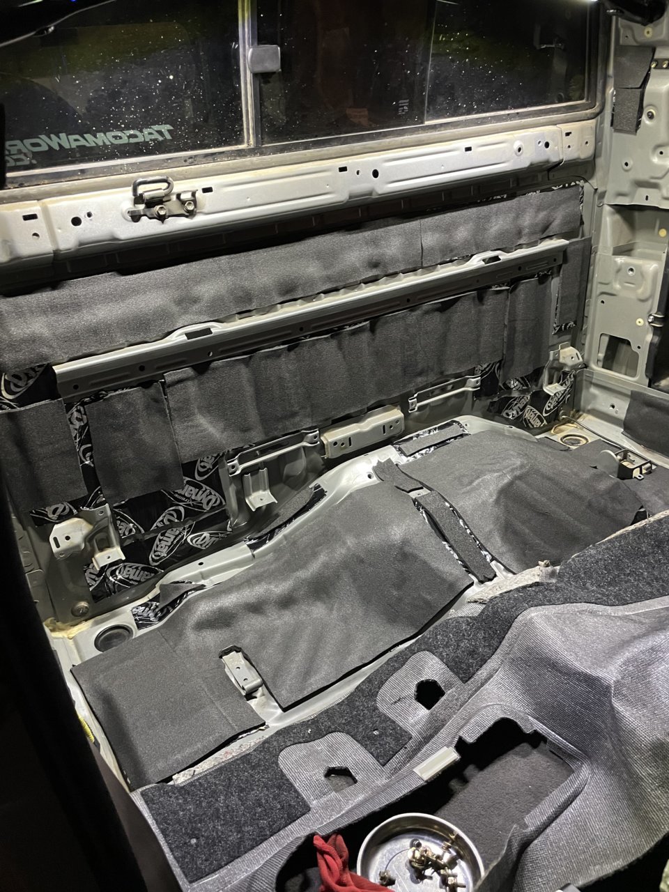

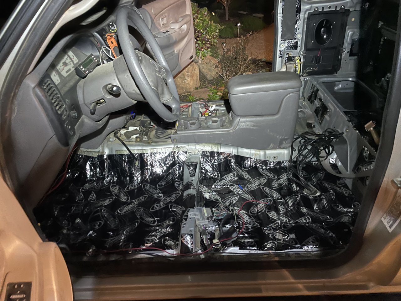

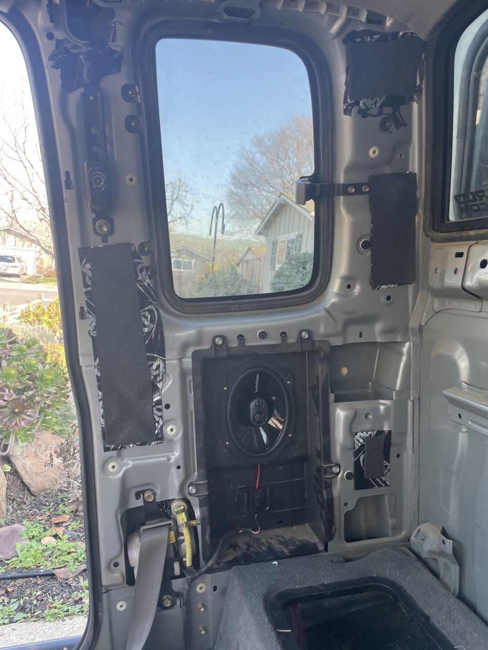

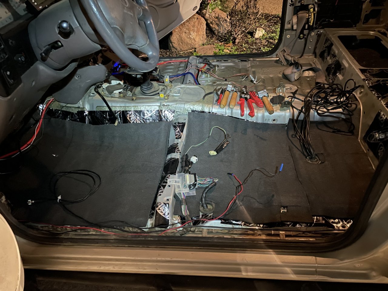

    Since I’m here I’ll make a update:
    This week I’ve been working on sound damping the truck and boy let me tell you it’s boring work haha as well as getting my dual cases installed
    E4DB7B94-EA6F-403B-8CB2-38C81A989FA5.jpg 654C7499-F5F1-4842-ABAC-4D4958C09F54.jpg 76CEBE91-EB9B-4EE8-8AF3-68B7411C979C.jpg
    got this all finished up on the weekend
    Tomorrow I have a few goals:
    • Pull the rest of the trim
    • Pull the carpet
    • Pull the drive lines so I can drop them off Friday
    Friday goals:
    • Drop off drivelines
    • Pull my transfer case
    • Mate my duals
    Saturday goals:
    • Test fit
    • Make cross member
    • Extend wiring harness
    • And hopefully get my cases installed
    Sunday goals:
    • Dynamat the rest of the cab
    • Install vinyl floor
    • Reinstall trim
    Not sure how ambitious those goals are but I think they are doable. Also have some small things like getting fluids and more RTV.

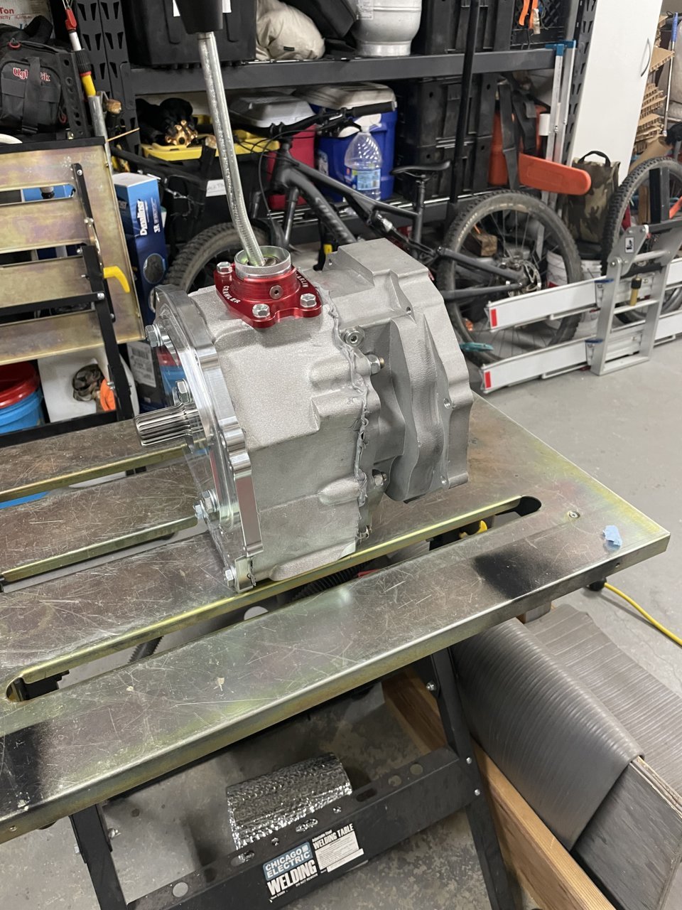

    I went with TG adapters, advance adaptors housing, and marlin crawler chromoly 4.7 gears. A little frankenbox. Tried to get the best available option

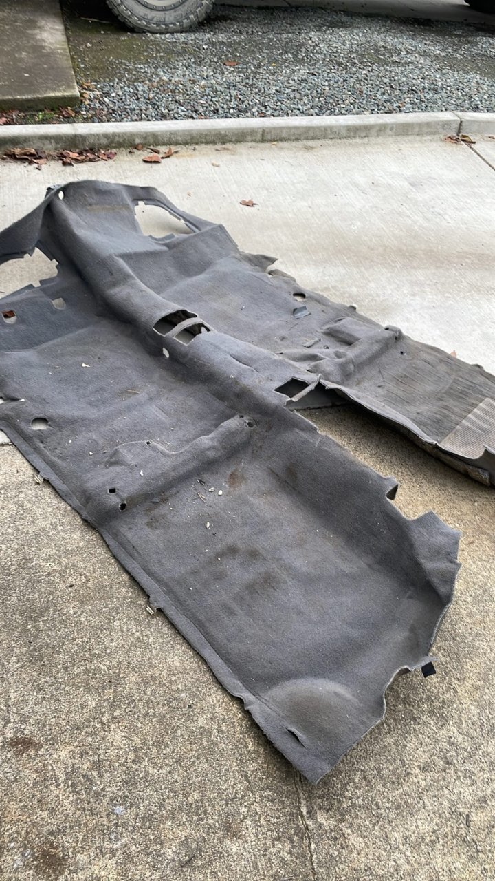

    Okay I nailed my goals for the day. Got the drivelines pulled. Got the trim off and carpet out. Then got the driver side dynamat and dyna liner in. I’m out of dyna mat at this point but have another box that is suppose to be here today. 6B4641B9-1EC1-4F8F-86AB-DA2F3D7FCB43.jpg89071355-4381-4419-BBE7-2237F26EED3F.jpg537386B3-54F7-4408-94F3-95502913B264.jpgA7CA528C-5B5B-4C8C-8810-0CF1CC06339A.jpg

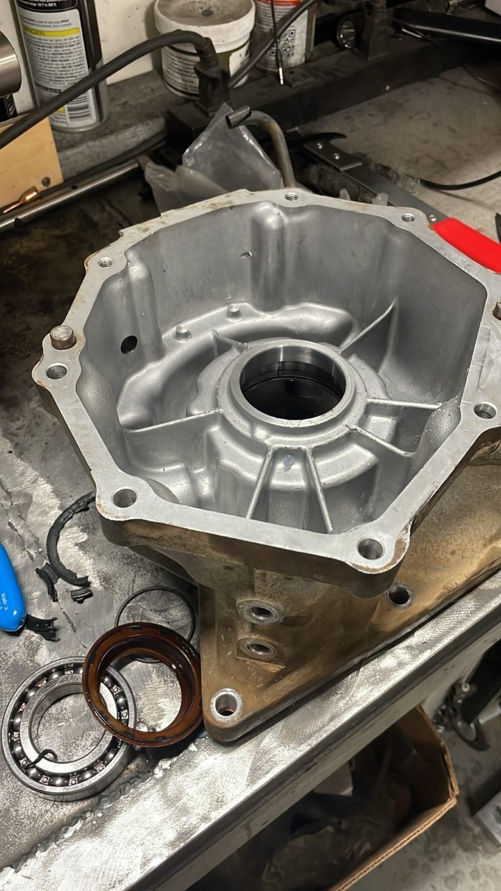

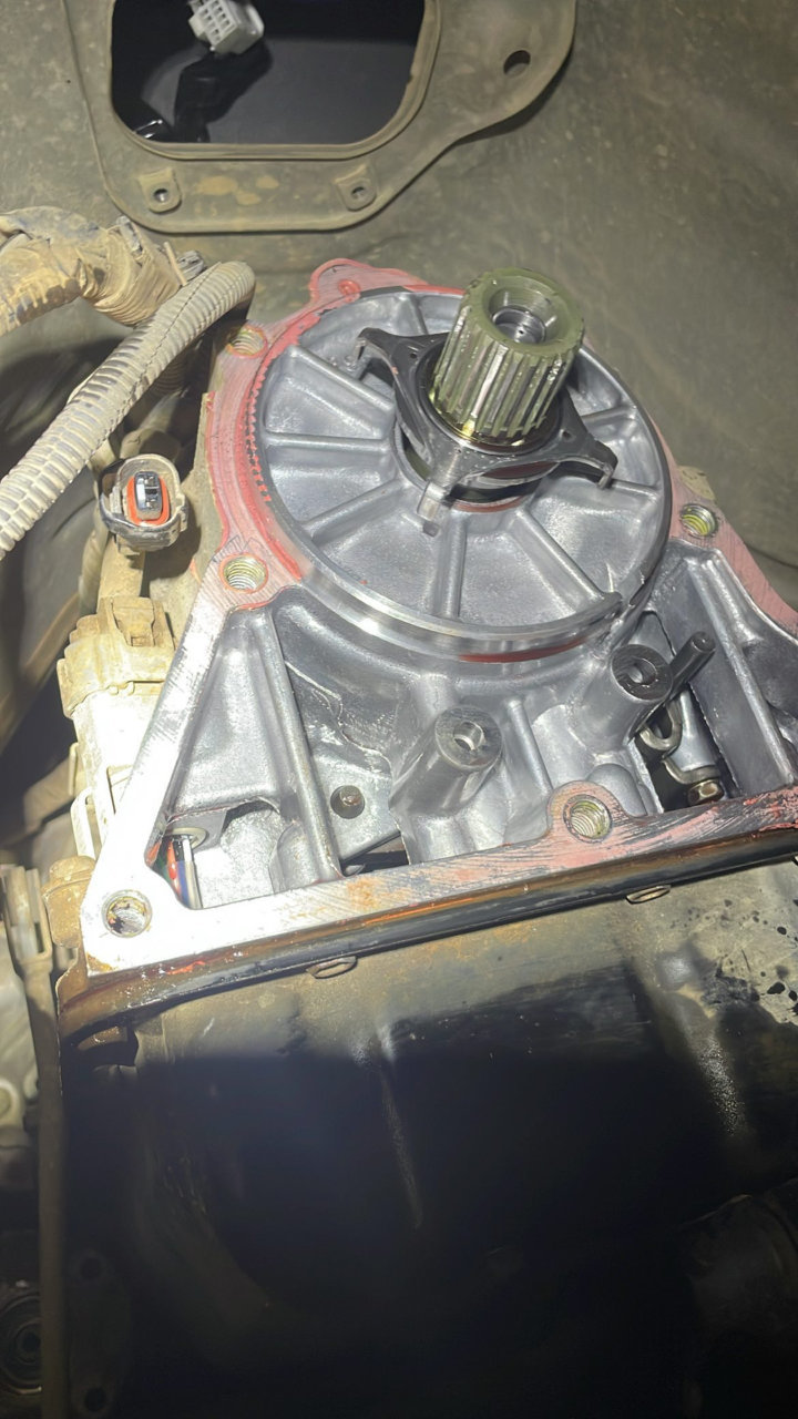

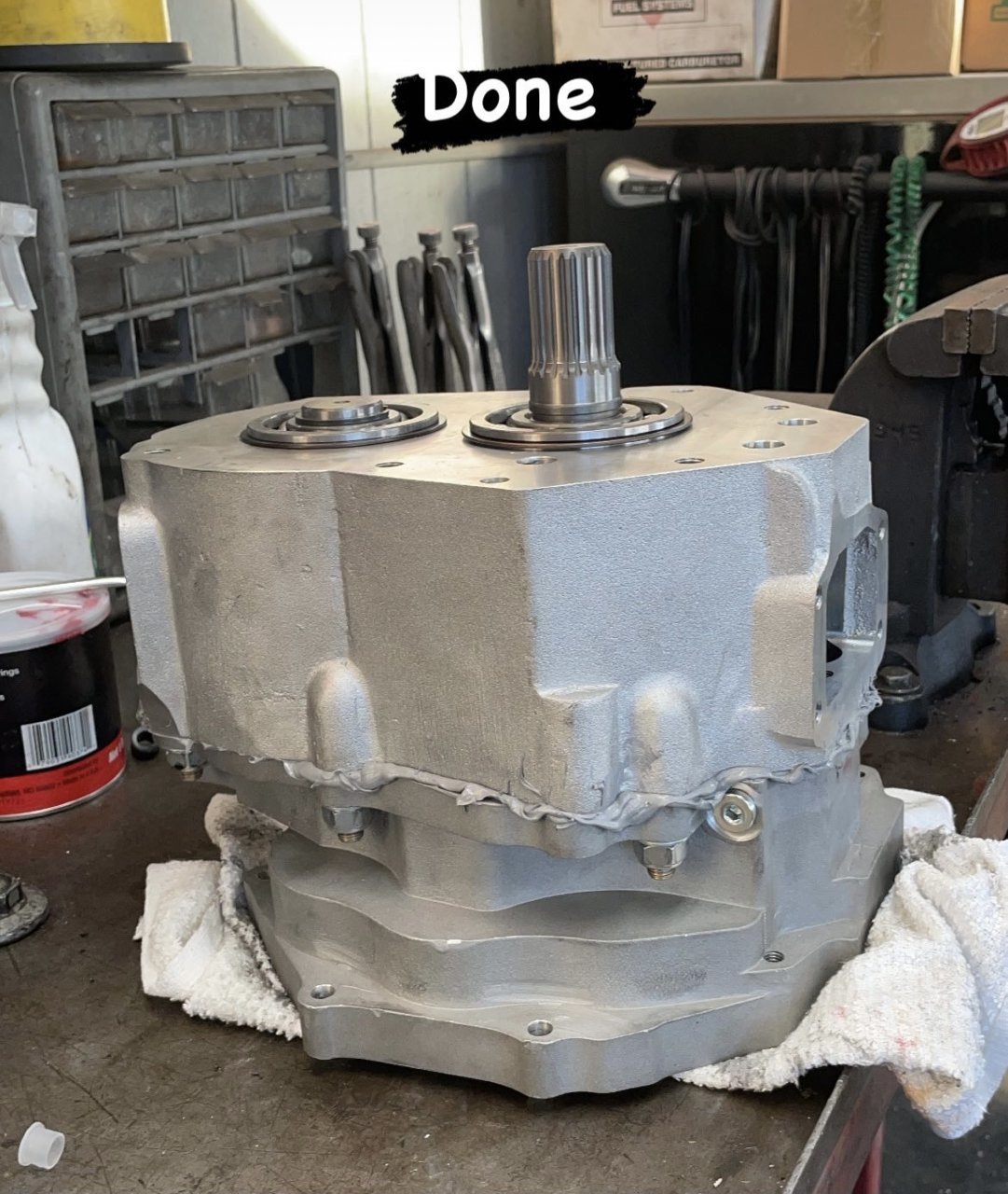

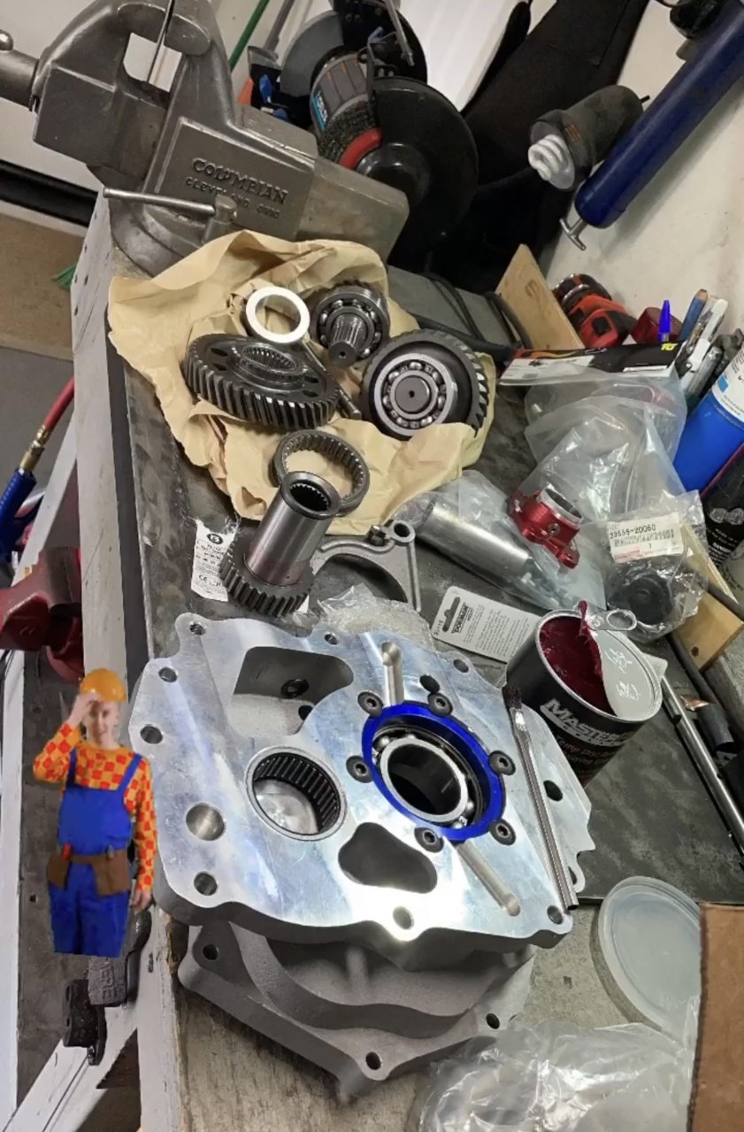

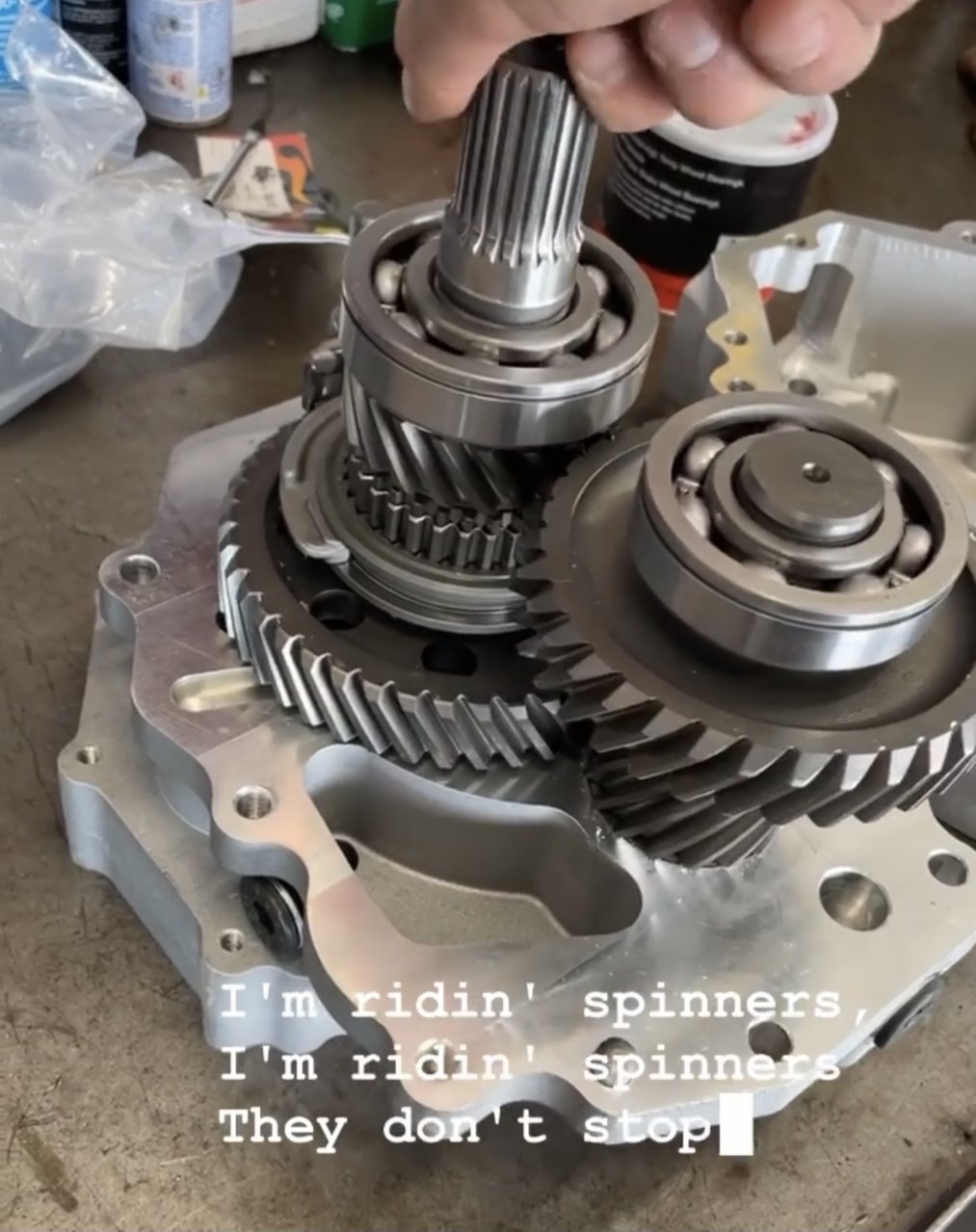

    Okay todays accomplishments:
    • Dropped off my drivelines
    • Picked up tranny jack
    • Got the tcase pulled

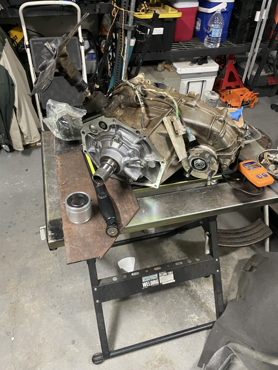

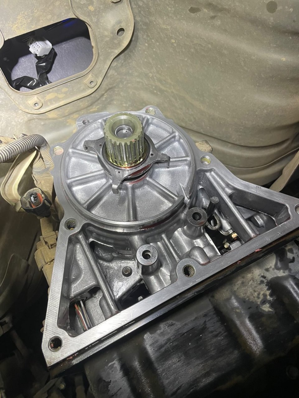

    • Pulled the rear trans housing and pulled the seal and bearing
    • Got the rear trans housing rtv back on the to the trans
    • Put on coupling and rtv the seal on.
    2815E339-5B0D-4866-A3E5-D3103DA651AE.jpg 24B665C5-4A29-4E9D-8A0D-AB9FD5B8DF20.jpg 386A24D7-DF64-488A-9520-B5D39B3EB4E8.jpg FDE4CEB3-7B29-4D86-9EC2-95C4C69B1615.jpg DBF57ECE-B1B3-4A4A-8E42-F9777EE6F543.jpg

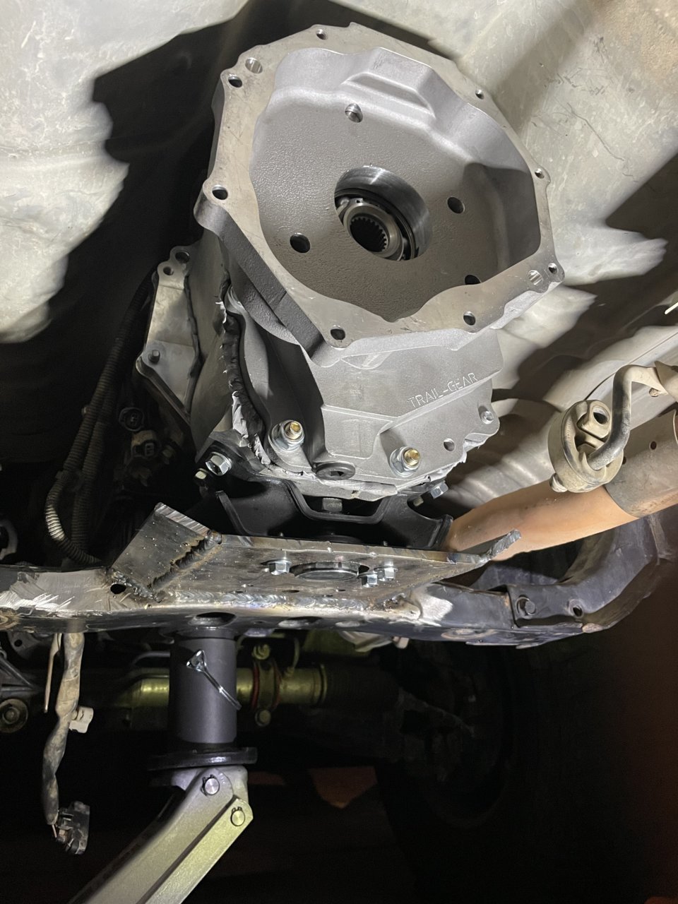

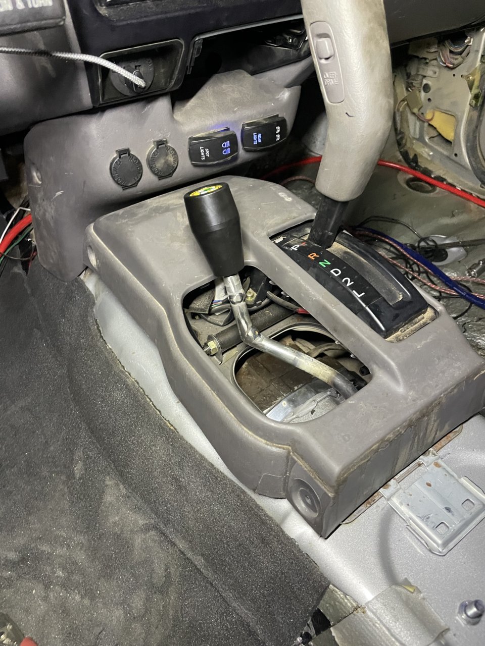

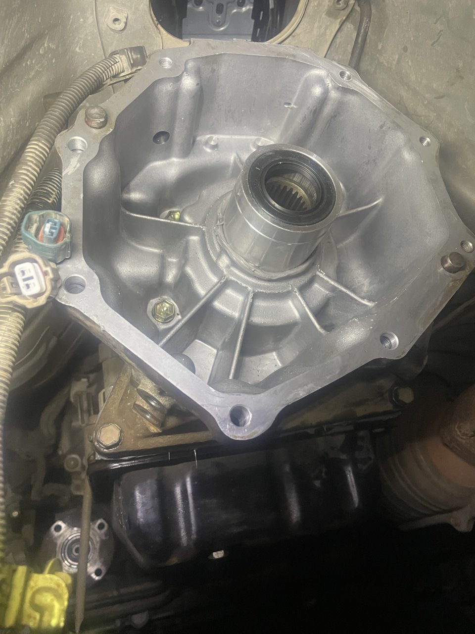

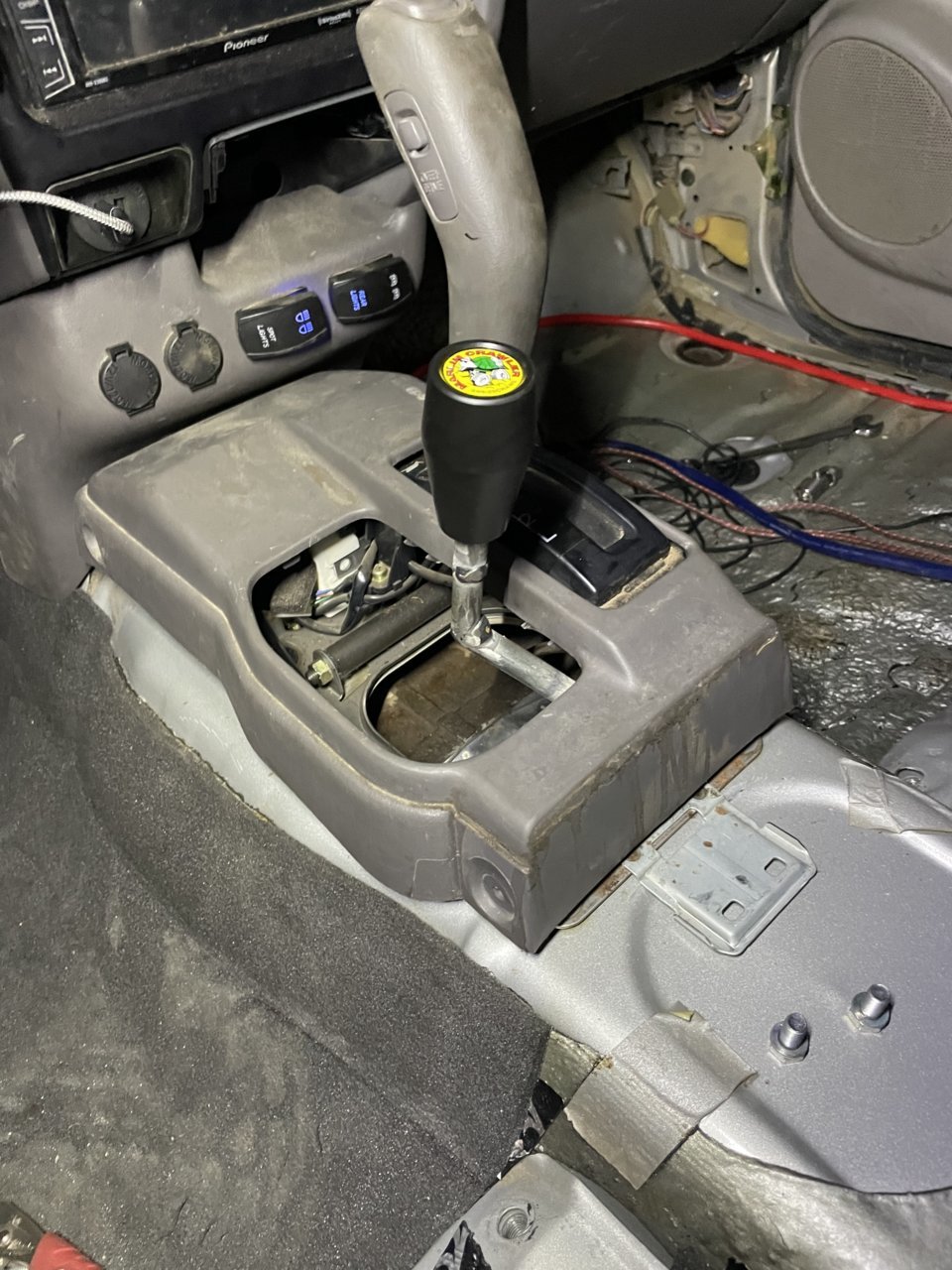

    Okay, so goals were not met today. I got a few things done.
    • Crawl box on the truck to test fit
    • Got the shifter to a place it works and it took way to long
    • Got the cross member made
    Tomorrow I hope to make more progress
    • Throw the cross member back on(letting paint dry over night)
    • Get the TCase on
    • Clearance the trans tunnel and get the tcase shifter fitted
    • Extend the wiring harnesses I think there’s 6 total
    • Then pull everything back out to RTV and install
    BYJOSHCOOK and chrslefty like this.
