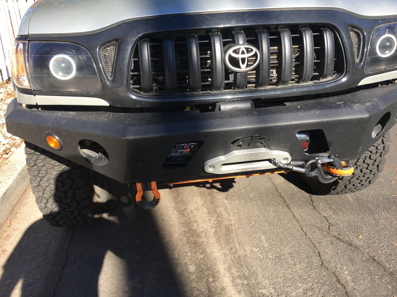

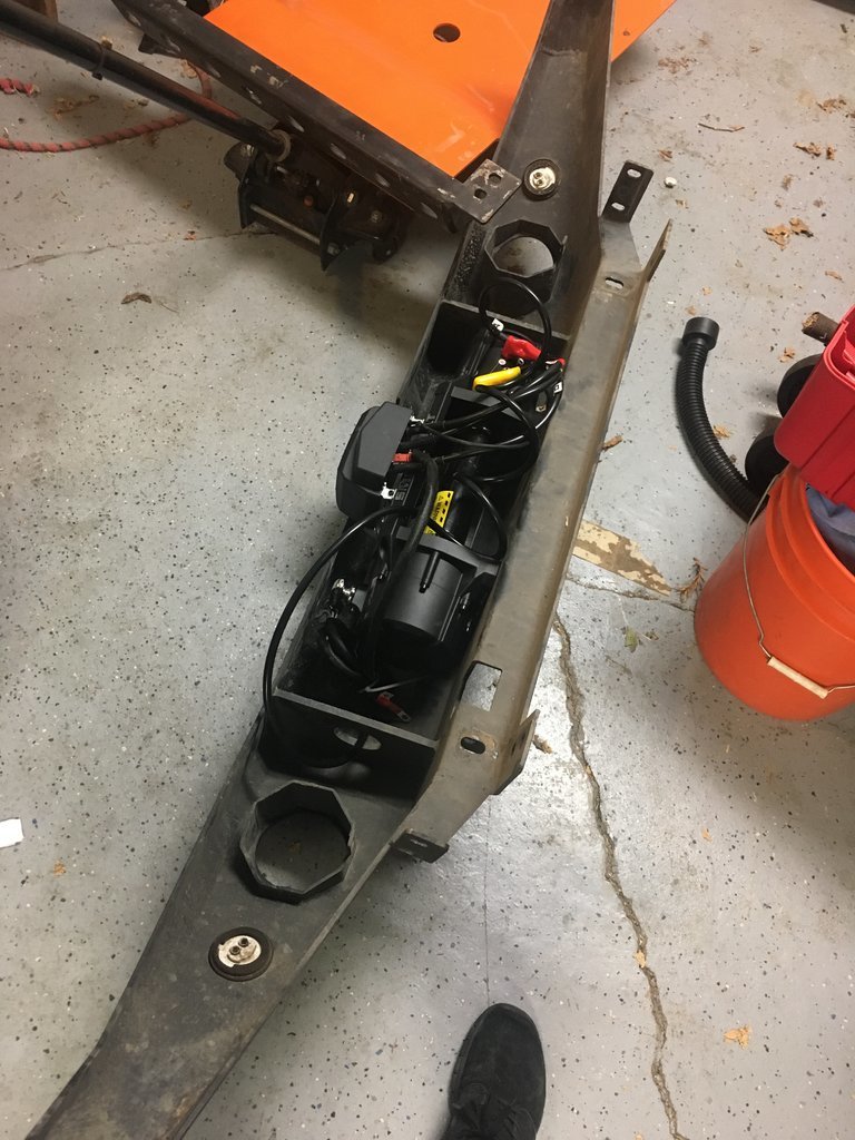

    Got my winch mounted to the bumper. The top housing was a SOB to get mounted(seen this in reviews). I stripped the bolts then ran to the hardware store and used a few washers to make it all fit better. By the time I had it on the bumper I was ready to call it quits for the night. I'll get on the truck tomorrow and wired. I just have to drive to work with no front bumper. IMG_6920.jpg

  4. Oct 19, 2017 at 7:09 AM
    #104
    BYJOSHCOOK
    BYJOSHCOOK Mr. Mojo Risin
    Jun 9, 2013
    #105887
    27,699
    Josh
    Woodstock and Alpharetta Ga
    2000 SR5 4WD Lunar Mist
    Check Out My Builds
    All-Pro Apex
    boostedka[QUOTED] likes this.

    What he said! fits in there pretty good! kinda worried about the wires in the back being tight

    All installed and working!

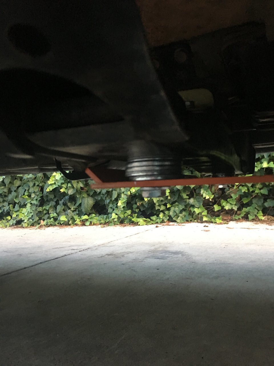

    So the AllPro transmission skid apparently isn't made to be used with a sway bar, it rubs. Which is really annoying that they don't mention that anywhere on there website. Any way I used some big washers where it mounts to the rear cross member to give it a bit of space. Hopefully it's enough if not I'll grab longer bolts and more washers.

    Subbed! I think I might have to do that with my skids...its pretty tight but my sway bar clears it barely

    Yeah the skid plate thing was pretty annoying, I feel like All Pro doesnt do a very good when it comes to stuff like that. They also gave me hardware that wouldnt work and advised me to get the Standard leaf pack when looking back the expo leafs would have been a much better option. Overall, I think if i were to do it again I would go with relentless or CBI over the All Pro products.

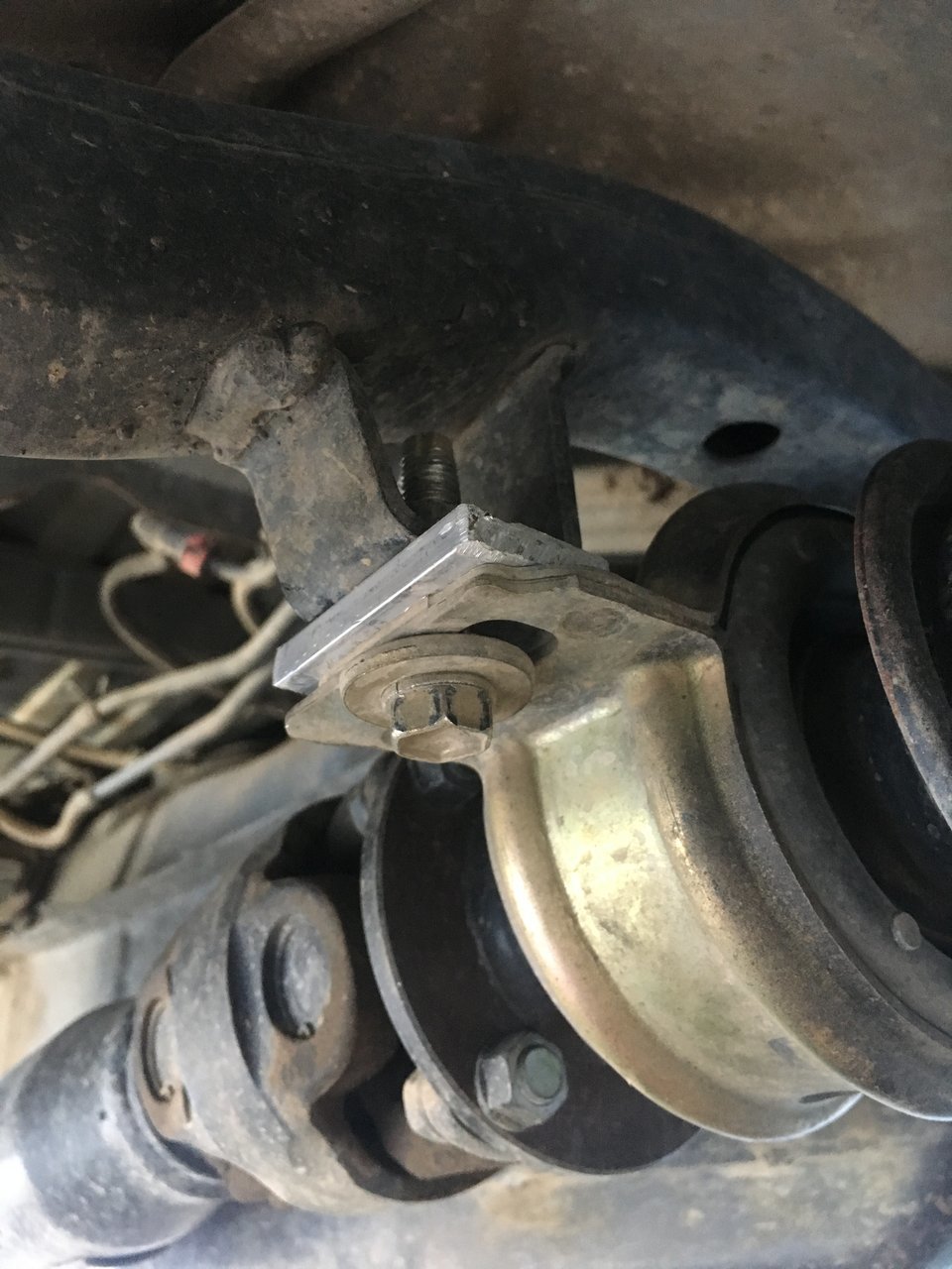

    Made some 1/4” carrier bearing spacers. Hopefully to help with axle wrap/vibrations. I made two sets so I’m going to start with 1/4” and if I need to jump up to 1/2”.

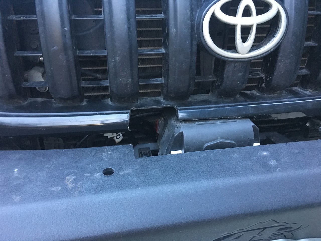

    Made a notch in my grill so that it’s easier to access my power button and plug. Figured in the time of “oh shit I need to use the winch” I don’t want to be fumbling around trying to get it on and running. Lol I’d probably end up breaking it.

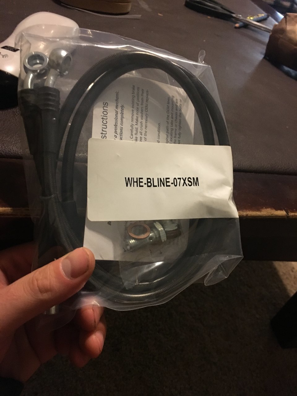

    Step one towards tundra brakes: wheelers SS brake lines. For 50% off can’t beat that! 8AEF8E86-75B7-4257-A6CF-11895E746A93.jpg

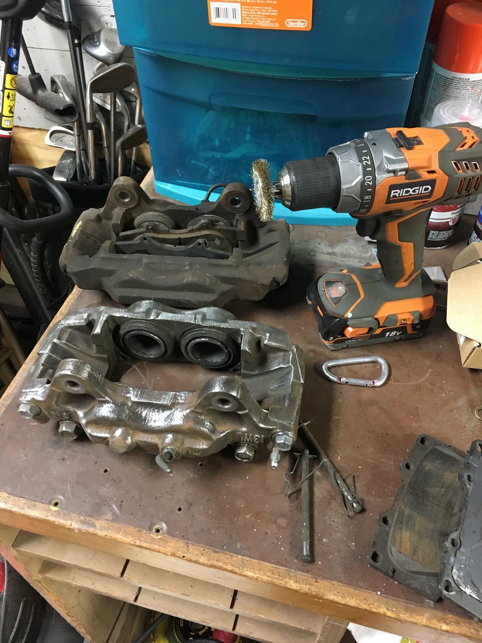

    Picked up some 13WL calipers off a 07 sequoia. Started to clean them up, going to call toyota tomorrow and get the rebuild kit, rotors and brake pads ordered up. I was thinking I about painting them a bright color(orange like my skids) but I think I will do black as I think it will look cleaner that way.690F493F-B5EE-4786-BB94-18F2A2D8D697.jpg

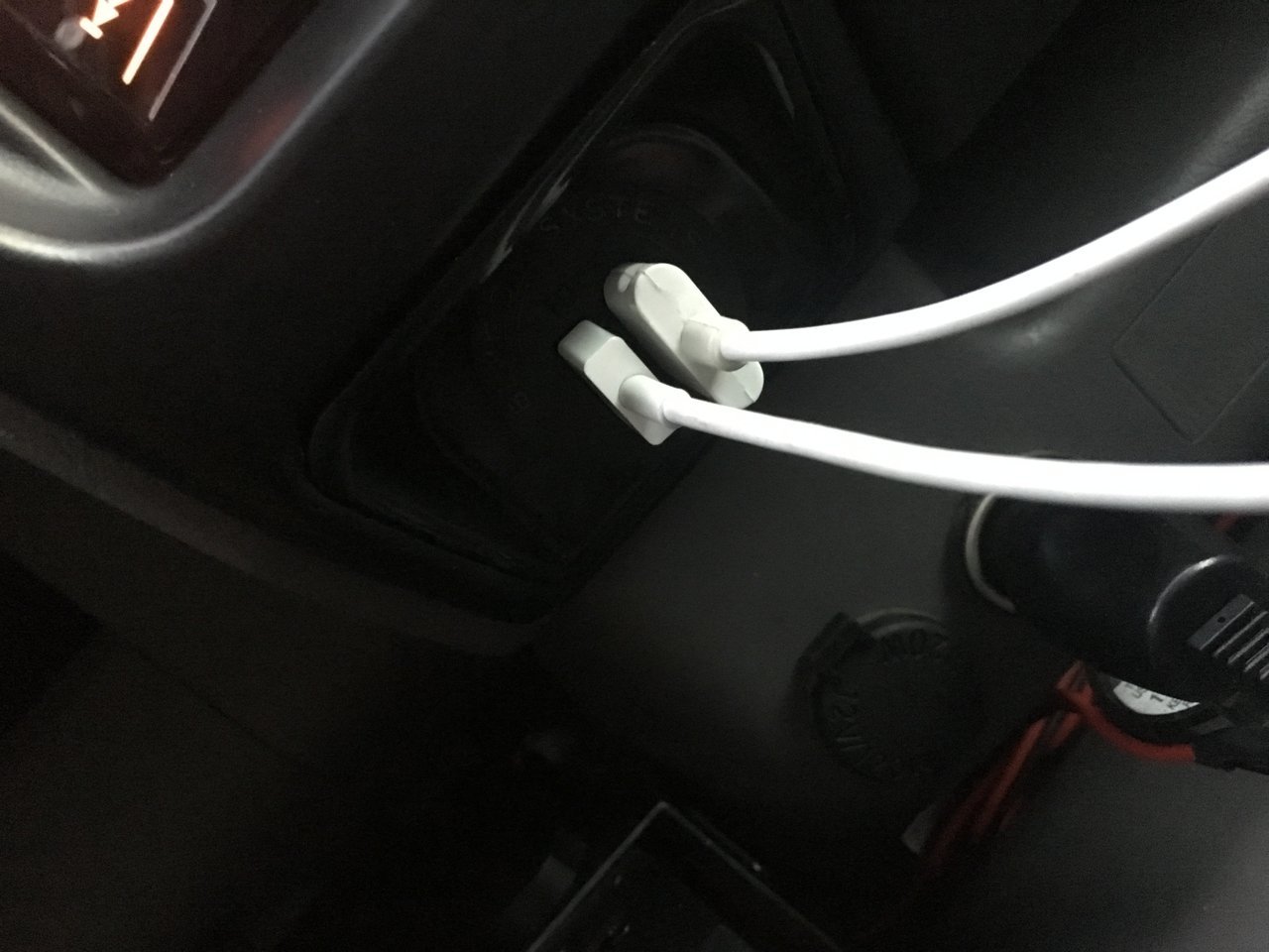

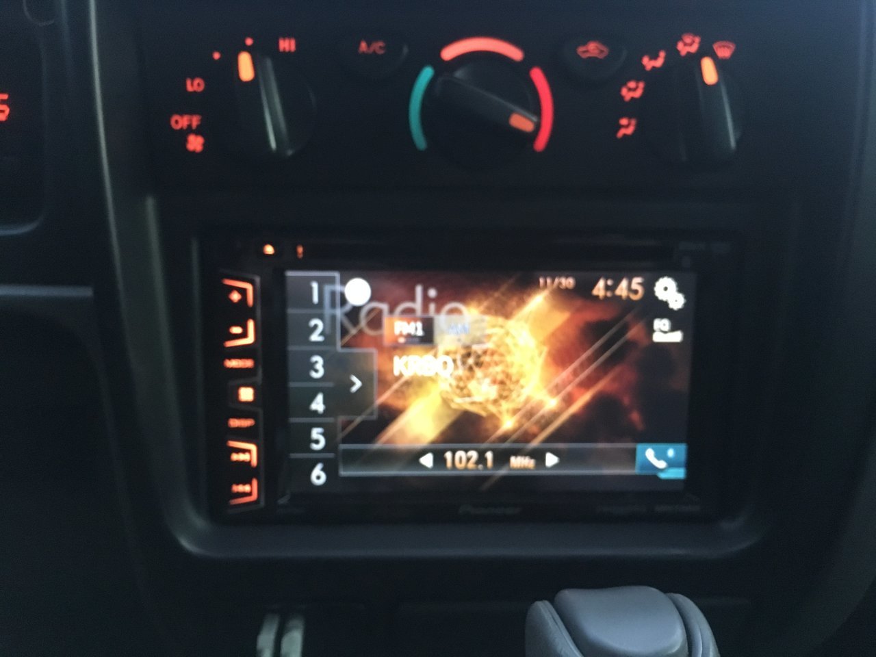

    Added a new pioneer head unit last week and replaced the cig lighter with a blue sea dual usb charger.
