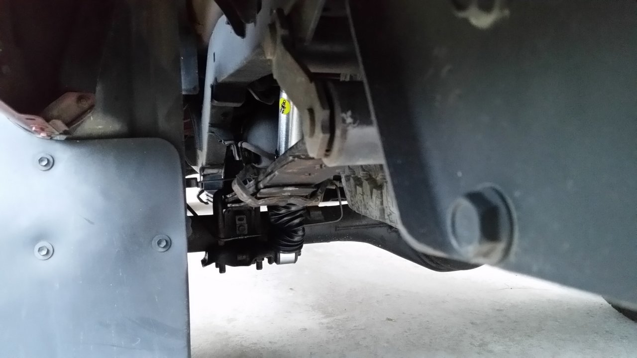

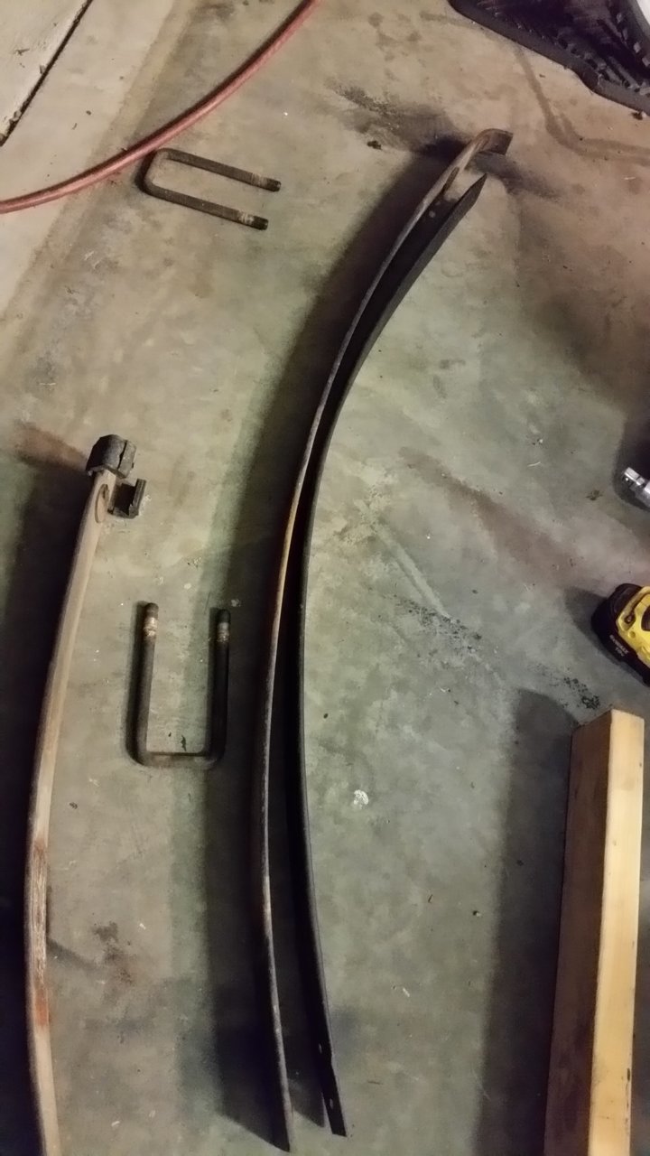

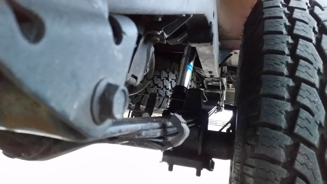

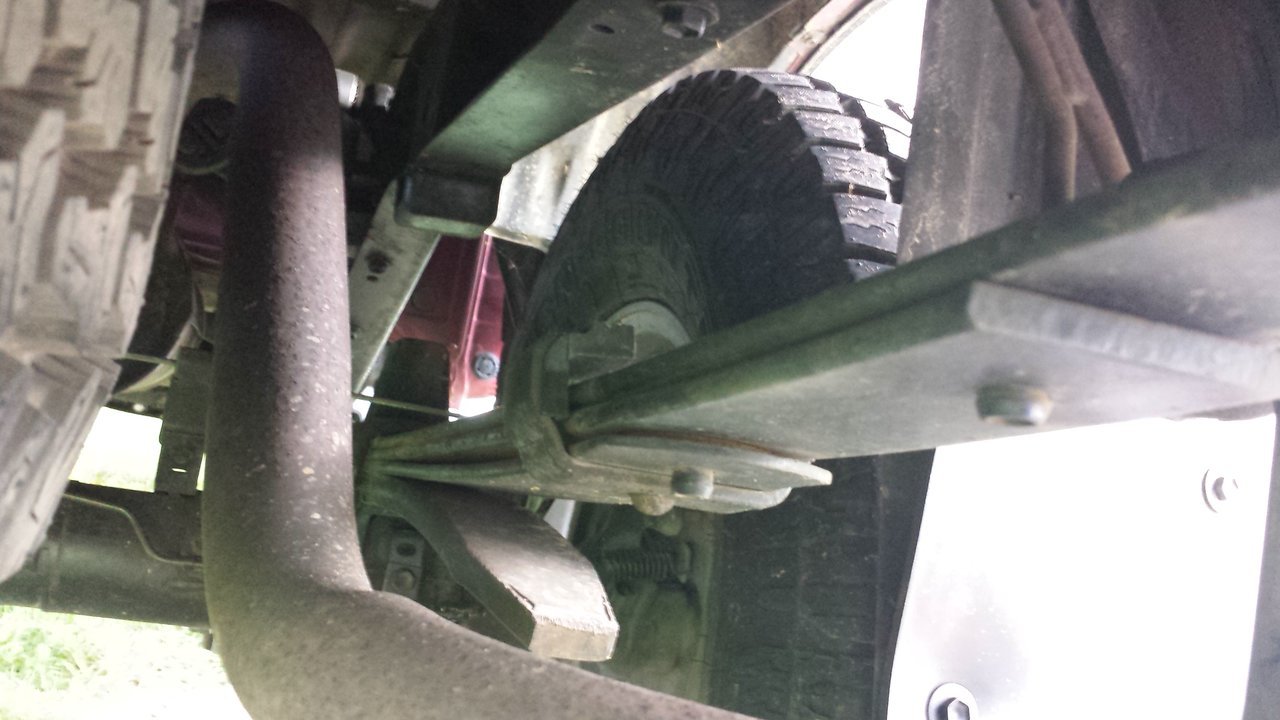

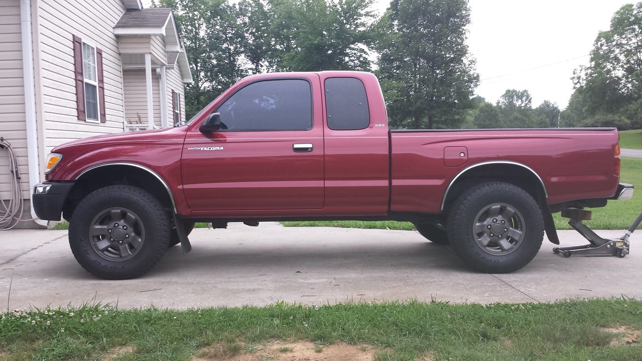

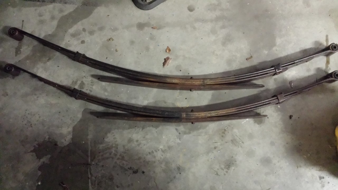

    This is inspired by the 149 page thead. Thread was locked and I don't seem to see folks doing this. But for $40 for springs and some effort I should be able to get my trucks rear back in shape. Truck is a 2000 Tacoma 4wd. I hauled just over 500 pounds to the scrap yard last Friday and it sat the rear and down 1.5" and bounced off the bump stops several times on the way. Truck sits dead even empty and I don't mind a little rake. So while I was at the scrap yard I came across a 92 Dakota with the bed already removed. I've read that the Dakota springs are good donors for someone like me that isn't interested in a 3" lift but wants to add some weight capacity. It was too easy to remove the springs not to get them. I'm considering swapping the 2nd and 3rd leaf with the 2nd and 3nd Dakota leafs and hoping for 1-1.5" read lift with increased load capacity.
    Below is a pic of truck now, 2 pics of stock (flat) springs and last pic of Dakota springs i plan to use.

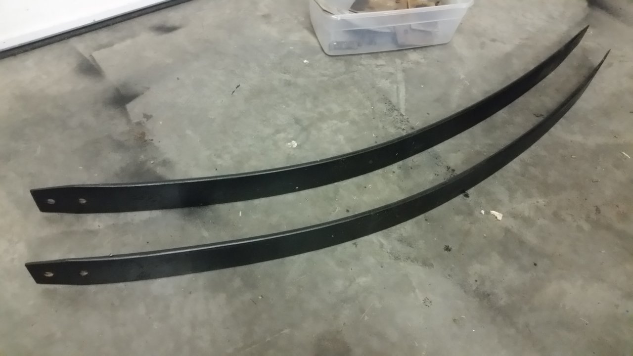

    A little bit of progress. I havery wire brushed and painted the two 2nd leafs. I plan to replace the 2nd leafs from my truck. The leafa off the Dakota are the right length so no cutting required.
    I'm hoping to do this on Friday and hoping for a ~1" lift in the rear which will get the rear back to stock height. If needed, I'll swap the 3rd leaf with the Dakota spring too, but I'm doing one step at a time.

    Tonight I swapped the 2nd spring on the driver side. It's amazing how much more tension the Dakota spring has. If I stand on the single Tacoma spring and bounch up and down, I can easily bounch it to the floor. I can only get the Dakota spring to go 1/2- 2/3 of the way to the floor.
    Spring on right is Dakota. I hope to swap the passenger spring tomorrow and see how much lift I get. Hoping for an inch.

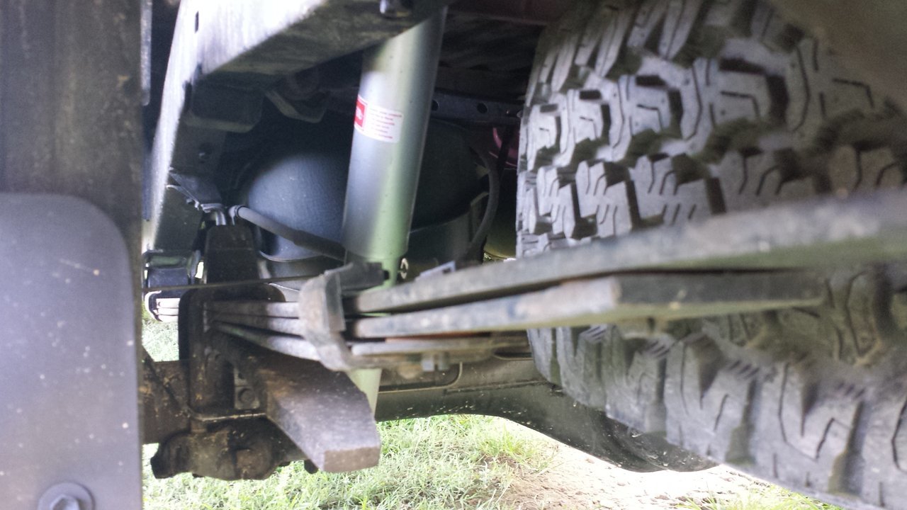

    Got both sides installed this afternoon. I ended up removing the overload which caused the U bolts to be a bit too long. I made some 1/2" long spacers that go between the bottom plate and U bolt nuts to allow the bolts to tighten up.
    Replacing on the 2nd leaf with the Dakota 2nd leaf actually yielded 1.25" lift bt because I removed the overload, I lost .70" so I only gained 1/2" of actual lift but also gained a good bit of arch to the springs. The rear is more firm and no doubt gained some load capacity.
    I still need to bend the clamps back together but wanted to make sure I'm happy with results first. So far, I'm happy but going to drive it a bit. I also just finished installing 5100's on the rear and am in the middle of adding 5100'a to the front.

    I have since swapped a few leads around to gain some lift. My current setup is as follows:
    Main leaf is OEM
    2nd leafs is OEM
    3rd leaf is Dakota
    4th leafs is Dakota
    This has provided about 1.5- 2" lift and rides great with 5100's.
