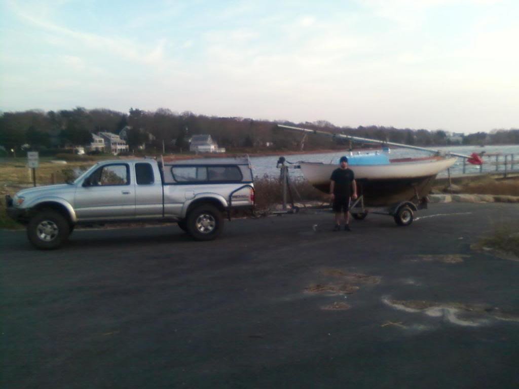

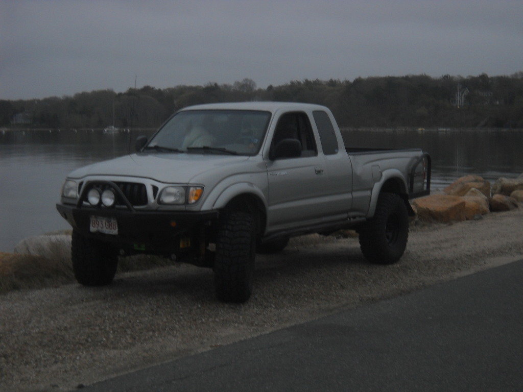

    33's are doable. 33x10.50s you need to hammer the pinch weld over.
    33x12.50s you will need to do a little chop on the fenders. If you do alot of wheeling with the swaybar off you should smash the shit out of the firewall or tub it a tad.
    I have OME 881's and the regular leaf In the rear unless you do another shim to move the axle back a half inch. The OME wont center your wheel wells. At full stuff (without bumpstops) You will also rub on the front of the wheel well.
    x10.50s
