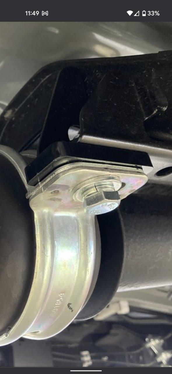

    I was looking at this lift kit for my truck, and noticed it included a driveshaft spacer. Does it need the driveshaft spacer? I haven't seen any other lift kit provide or need a driveshaft spacer.

    If you are referring to a carrier bearing spacer, then yes it is common. My kit came with one. It’s an easy install.

    It would be this spacer

    Yup that’s a carrier bearing spacer.
