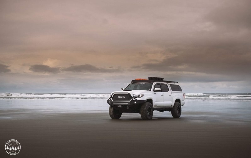

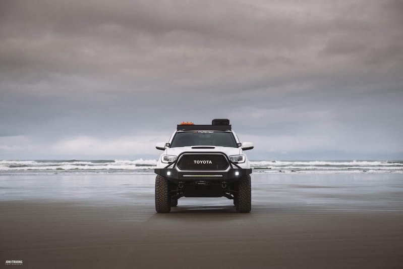

    Great pics! Truck looks awesome! Have you played with the Adjustable Compression and Rebound much?
    Foggy Noggin[QUOTED] likes this.
  8. Mar 22, 2017 at 3:48 PM
    #48
    Foggy Noggin
    Foggy Noggin Well-Known Member
    Aug 24, 2015
    #162623
    329
    Puyallup
    2019 Tacoma TRD Off-Road
    Not yet, no. I left it at the factory setting until I add some weight to the truck.
    I get that. The bp51s aren't ride height adjustable. Just the compression and rebound. It claims it's 2" of lift but on the gen 3, it's closer to 3". Sits taller than a couple gen 2's I've seen with the same kit

    What's in the rear for lift?

    They are ride height adjustable.

    Well technically you can adjust the pre load which may change the ride height slightly But it's designed to be a 2" lift over stock. I don't know a ton about these yet. Just got em. But it's not like icons or king where you can go from 1-3" from my understanding

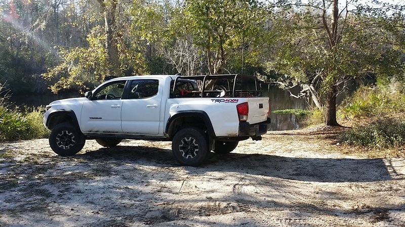

    So if that's the 2 inch lift up front, what rear setup was it. was it the full dakar with one leaf taken out? Looks nice!
