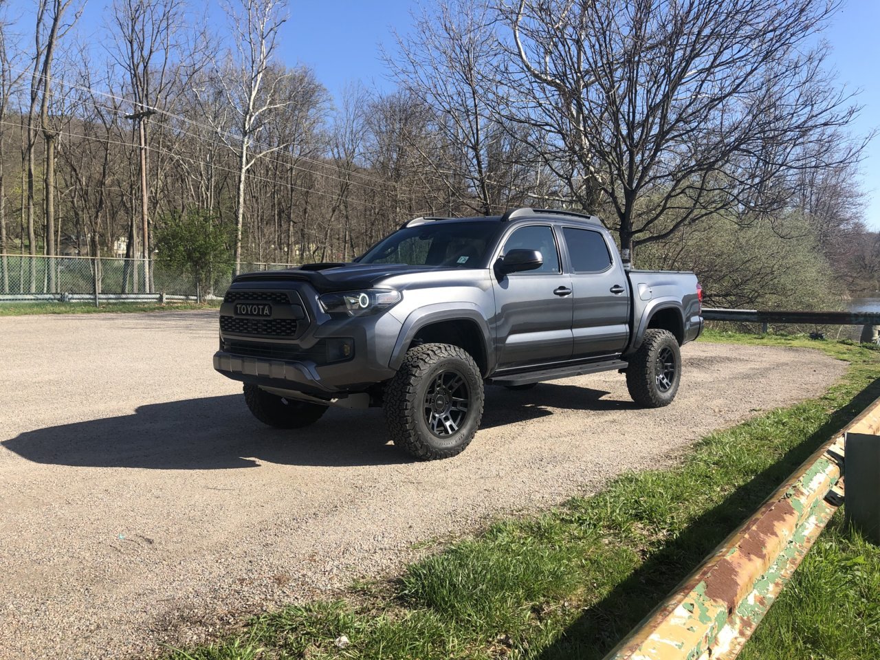

    i can’t imagine this being beneficial for what you are stating in your original post. It isn’t even the full leaf pack it’s just 2 leaf springs according to the link above? What coils does it come with? 886 or 888?
    I believe the dakars are what would work better for you. EL095R I believe. I’m running EL111R and 887 coils with nitro chargers all around, with no weight in bed or up front. Considered the stock load on many sites

    Correct. It also comes with the 888 springs. I still think he should consider the heavy load kit out back
