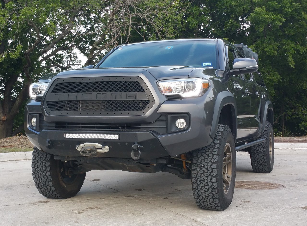

    Been on the truck for about 6 months and 10k miles. OME 9000 shocks all around, 886 coils and SPC UCA's(most likely not needed)up front and Dakars(CS047R) on the back. All ordered from Headstrong at the beginning of the year. Ride is a little stiff but I like it. Probably should have gone 888's since I dint go with a full bumper. The springs have softened a little after I broke the suspension in. Its nice being on a trail and not bouncing forever after a large bump/drop like the stock OR setup did. Makes me feel the truck is always planted on the ground well. Have a full set of steel skids is going on in the next week or 2.

    UCA's?

    SPC UCA's. forgot that. Dont think I needed them but I went ahead and got them because one day I will.

    Nice C4 fab bumper :thumbsup:

    Jason I need those rims and that bumper. I'll swing by this weekend in pick them up :)

    I don't need them, wheels are scratched to shit though. :anonymous:
    Actually the wheels were claimed by my buddy a couple months ago. I will probably sell them to him and buy some new ones and go to 285/295's... I told him the longer it takes the lower the price will go as I continue to scratch the shit outta them.
