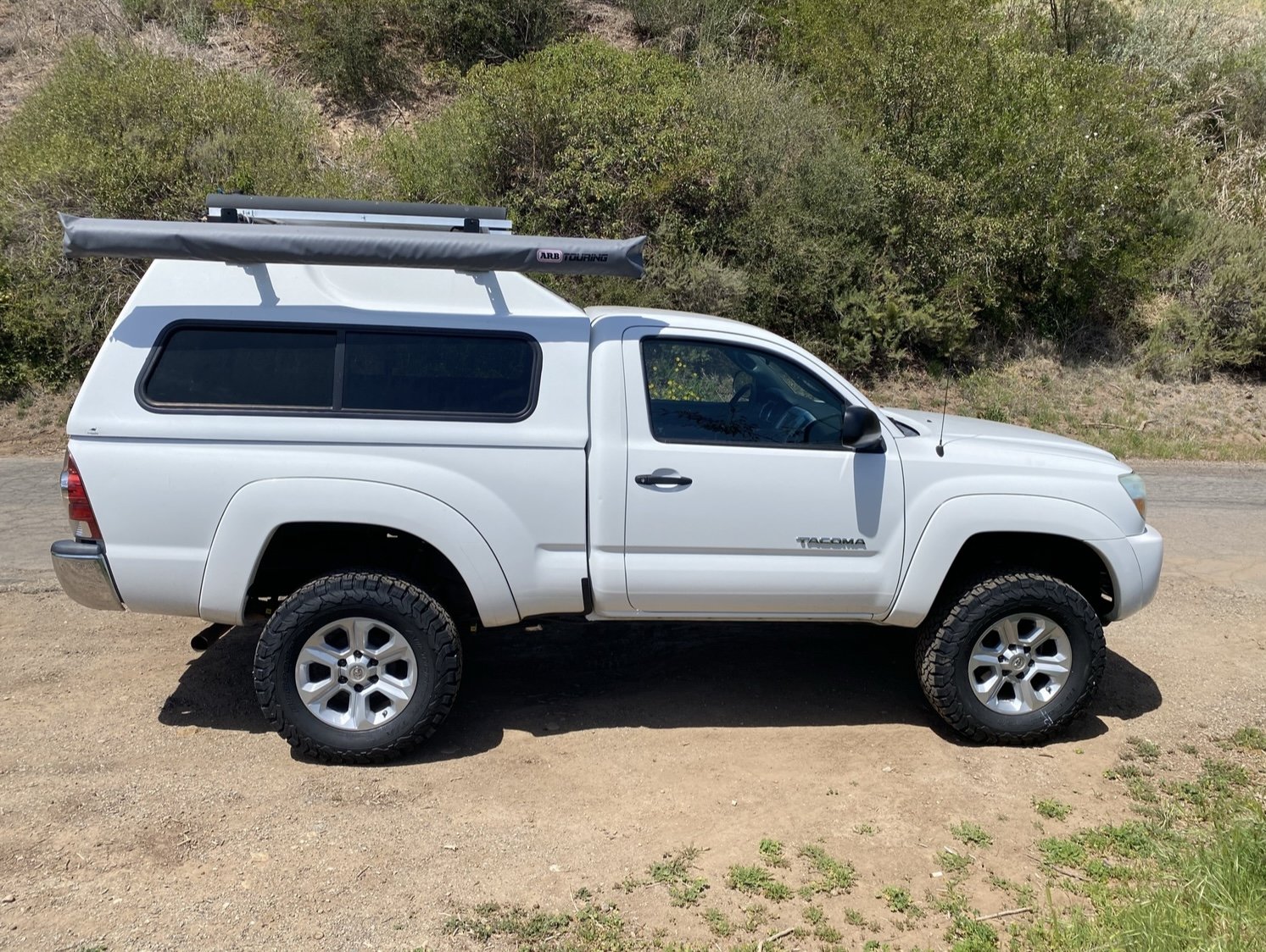

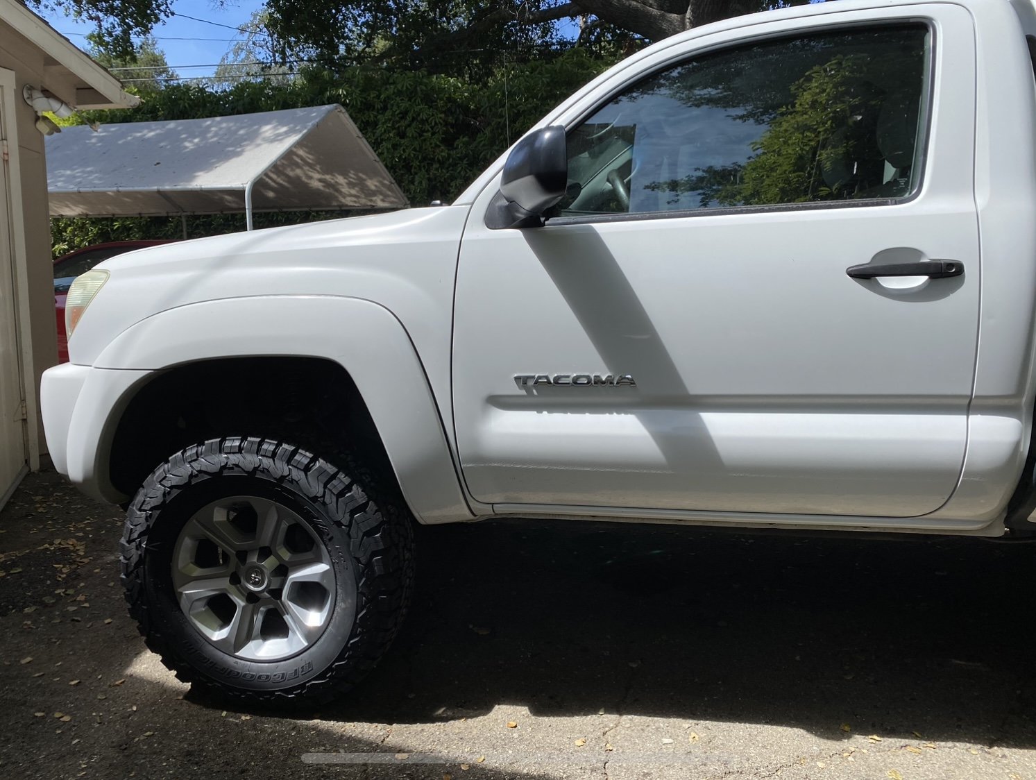

    Does anybody out there have have a single cab gen 2 prerunner with OME suspension? I’ve got 2885 springs on mine and it’s too much lift, no downward travel, too stiff, and caster/camber aren’t great. I think I’m getting 3”+ lift and I’d rather have less.
    would 2884 springs get me closer to 2 - 2.5” of lift? Are there other springs I should consider?

    Thanks for the info ridefreak. My truck is running OME shocks, so there’s no possibility of selecting the wrong ride height. I think my truck is just so light in front that 885s are complete overkill. When I picked out my kit I had a very heavy home built camper in the bed at all times. Now it’s just a shell and some gear in the bed. I’ve got the OME heavy load Dakar leaf springs. The pictures I attached are from before I decided to remove a leaf from the pack, which lowered the rear about an inch from what the photos show.
    I think 884s may be what I need.

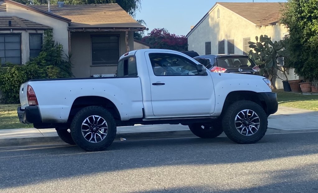

    Here are 3rd Gen sport springs on my prerunner - clear 265 KO2’s well except for a bit of plastic rub up front at full lock.
