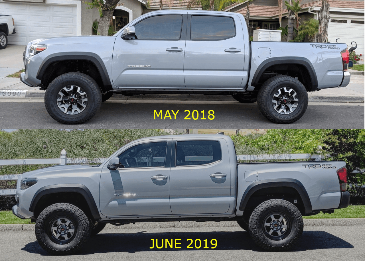

    I tried to do this scientifically to prove what I knew just by looking at the truck. I installed 5100s and 2885 springs to my 18 DCSB RWD. To this point they have 10k miles on them and were installed in May of 2018.

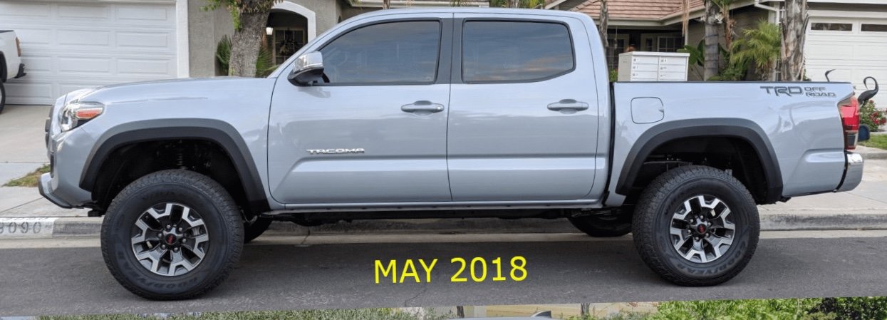

    These are my original front fender measurements in May of 2018 after initial settling/install of the 2885 springs; this is the bottom of the fender to the center of the axle (which removes the tire altogether from the measurement).
    Stock suspension before 2885/5100: 20.25" (left/right)
    Suspension after 2885/5100: 22.75" (left/right)
    The rear with 1" blocks measured 22.75" also.
    My truck initially had 2.5" of lift from the new setup. It was basically perfectly level and I was stoked. I suspected it would settle a bit over time down to 2" which was just about where I wanted it. A few months ago (9 months after install), it was getting nose down a bit, so without measuring after I installed 0.25" strut spacers, which add somewhere between 0.25" and 0.5" of lift. After this it looked level to me again.

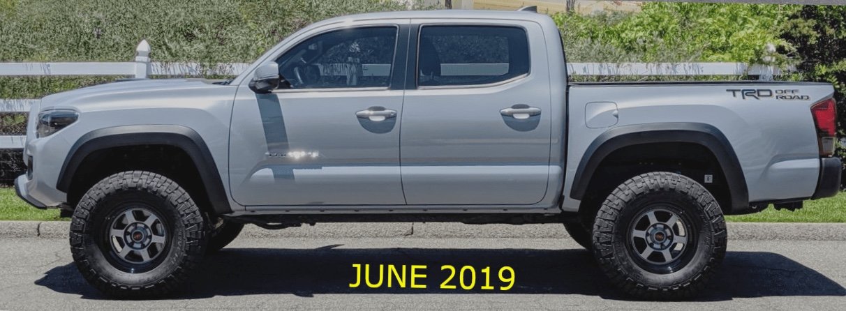

    I took a picture a few days ago, now 12 months after install, and it looked nose down again with a little rake! No added armor, no added unsprung weight, no driver. I'll admit it, this truck hasn't been offroad but 5 miles since I've had it so this is not offroad wear and tear. Here is original install versus recent picture. If you look at the tire gap and the rake you can actually see the settling.
    Ok, I wanted to figure out how much the springs settled. I took some physical measurements and even some pixel measurements on these measurements to confirm axle to fender measurements. I used the rear axle as my baseline so I could trust my measurements.
    My original 2018 measurement of the rear axle was 22.75". My new measurement today, both physical and by pixels were within .1% of the original measurement. So, I trust my measurements.
    Using the same physical measurements and verifying with pixel count on the images, here is where the front is now.
    Original measurements after install/settling: 22.75" (left/right)
    2019 measurement after 10k miles (and with 0.25" strut spacers): 21.8" (left/right)
    Considering the strut spacers add 0.25-0.5" of lift, that means the following:
    The springs have sagged 1.2" to 1.45" over a year
    The springs settled 48% to 58% of their original height
    The springs are now lifting the truck 1.05" to 1.3" over stock after a year.
    Also consider this isn't with 4x4 guts or armor which could exacerbate this. I'm not sure how I should feel, I'm suspecting that we all presume the lift will be pretty close to the original measurement, maybe 10%? I kind of feel like 2" should be 2", say maybe down to 1.8". I need a solution to go nose up again, and something I would prefer to hold steady so my tires that didn't used to rub will keep not rubbing and I don't have to revisit this again in a year.

    Some of the drastic difference from a visual standpoint is your tires look to have gone up as well between your photos.

    I was looking at this suspension setup, so this has me interested. I roughly edited your photos to make them more level, I just tried to line up the curbs as a base point. I know you have measured the sag, but it’s still interesting to look at.
