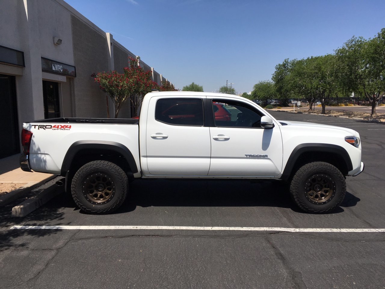

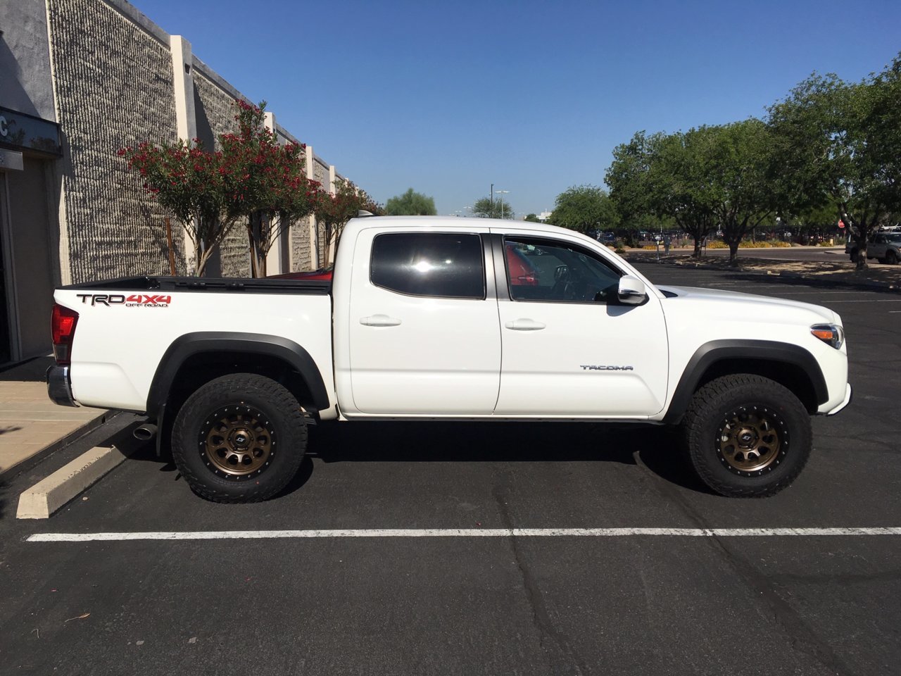

    OME 885s on 5100s with 1/4" spacer on driver side and 1" Maxtrac blocks
    Measured a day or two after install and I believe I got about 1.3" up front... definitely lower than I expected. Will settle more, I'm sure. Want to keep slight rake, not level. Considering swapping 1/4" spacer for 1/2" on driver and shifting the 1/4" to passenger side. Will need to press new studs to fit 1/2" spacer on driver side though.
    No complaints about ride quality or clearance. Good option for the money, but I wish the 885s didn't sag as much.

    You rub with the mud flap after lifting? I see you have the front off.

    Before lift it rubbed with or without mudflaps. After lift it doesn't rub the back of the wheel well during moderate offroading and I think I could probably put the flaps back on. But after seeing how they are mounted and how stiff they are, I'm hesitant to do any rock crawling with them on. Don't want to find out what happens to that plastic wheel well liner when they stuff into the ground or a rock :eek:
    Back ones stay on because it's required in AZ

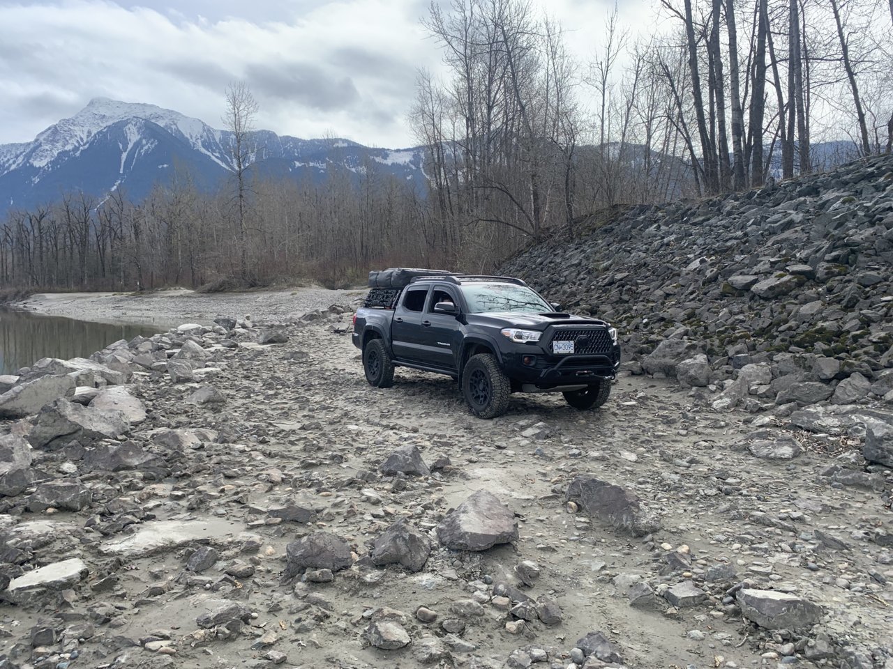

    Hm interesting. After a year, I’m at about 1.8” of lift running 2887 springs and softvalved nitro chargers.
    45 pound stump bumper, winch, TRD skid and steel sliders.
    Got no complaints over here.

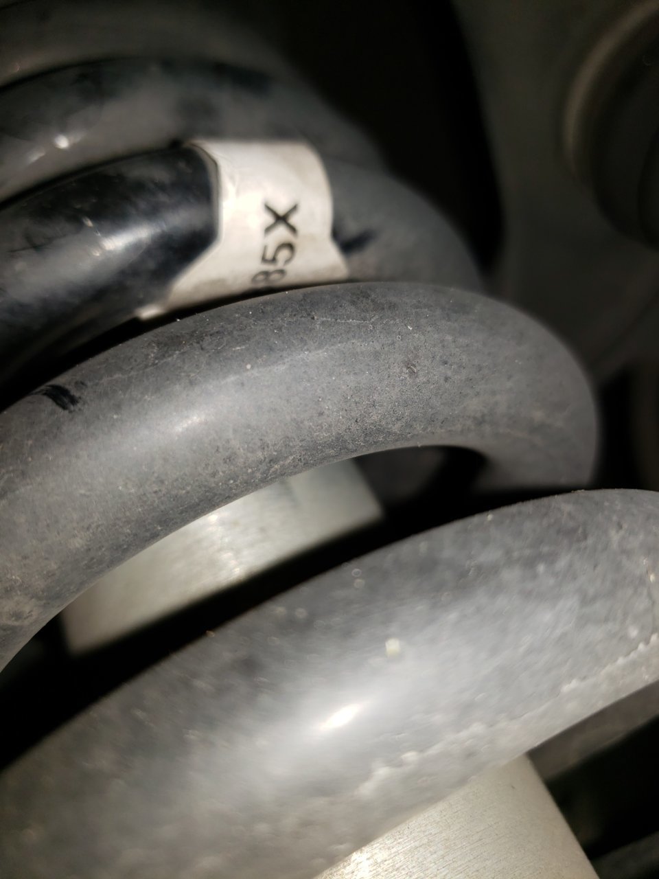

    I have 22.5(drivers side with 1/4 spacer). Been sitting at this level for 3 years. BTW, my coils are 8885X

    Damn thats crazy. My rear deaver aal is at 23.5 front the center of the hub to the fender. Front is barely at 21.5 both sides with 1/4 lean spacer on driver side. How do you know that you got the 885x? Mine were bought from headstrong in July 2021 so not that long ago but crazy sag like many others with OME coils.

    My rear is the same setup and seats at exact height.
    I bought them from HS in 2020. There is a label on them

    Well mine don’t have tags. Looked back to some pictures from unboxing. No tags either.

    I’m at 22 1/4”, stock was 20 1/2”, so I’m more like 1.75” of lift.
