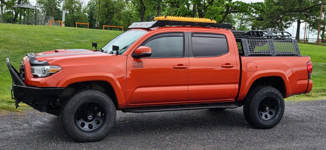

    I'm running a 3" lift with Bilstein and heavy duty coils and springs. I made one mistake when buying, and that was not getting the extended length shocks for the rear. I bought mine through Headstrong Offroad. I also bought the replacement extended travel rear shocks from them. 5100's all around. Heavy coils and heavy OME leaf springs.
