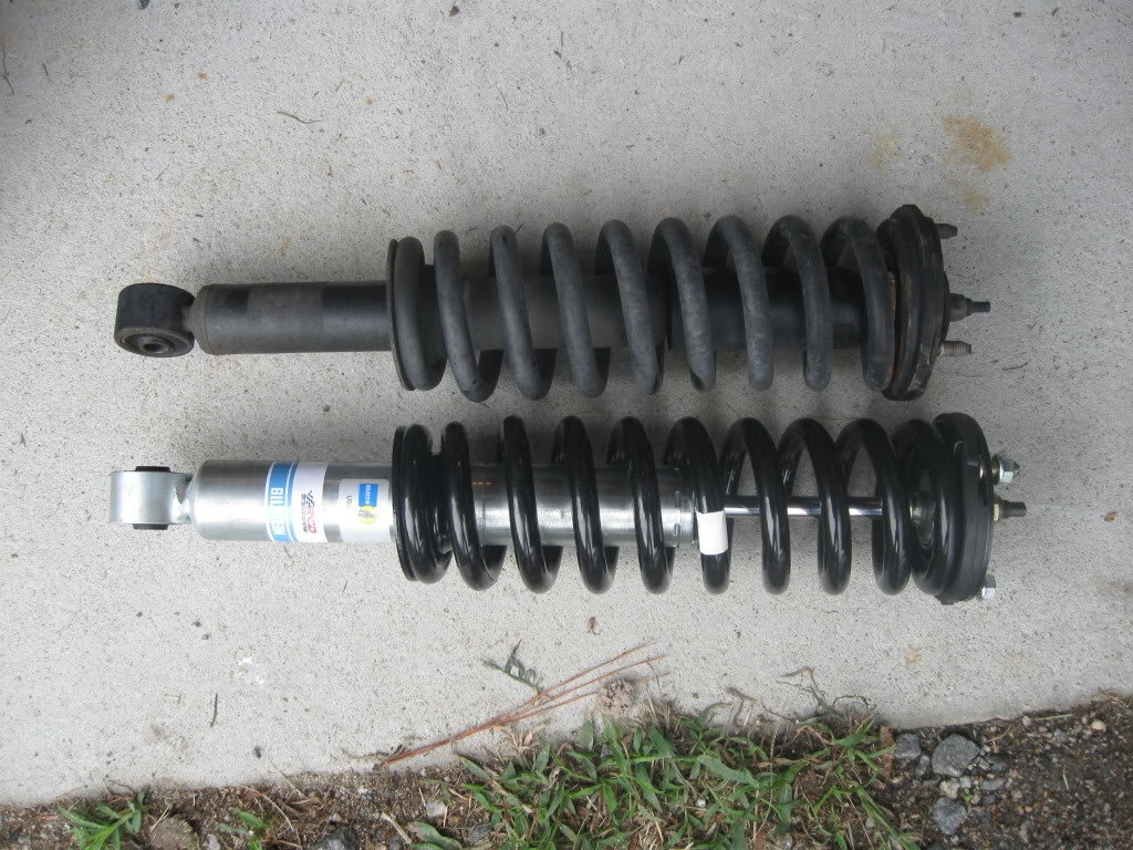

    Finally got bored and put my bilstein 5100s and OME 880 coil on the tacoma. Looks nice. I think it gave me just the right amount of lift for what I am trying to do.
    Here is a comparison of my old shock and coil with the bilstein 5100/ome 880 combo.

    I installed the bilsteins on the lowest setting. I think it gave me enough lift to fits 32s. I got almost 2" of lift in the front. I had installed an AAL in the rear so the rear was a bit higher before. Now it seems all leveled out.
