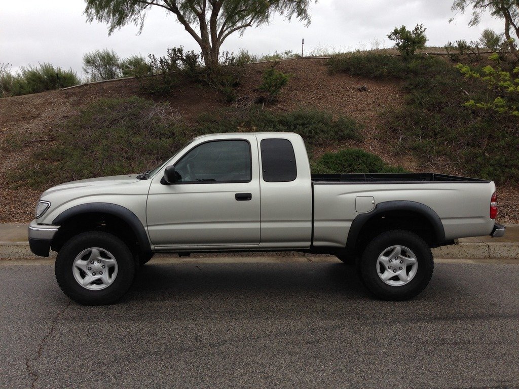

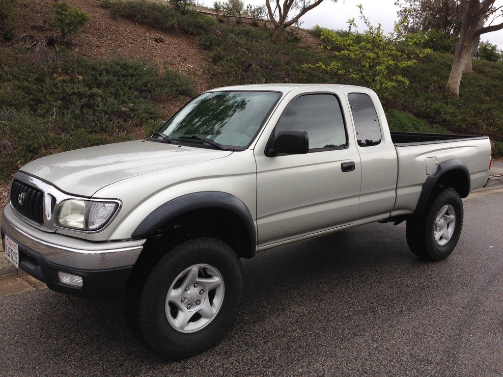

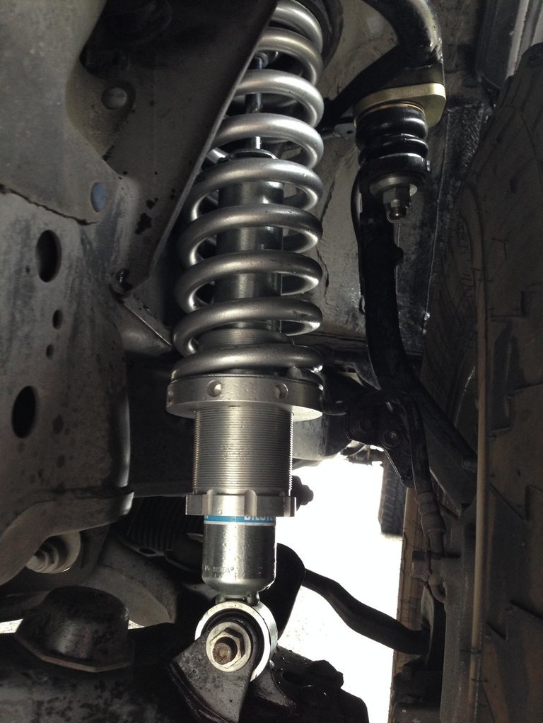

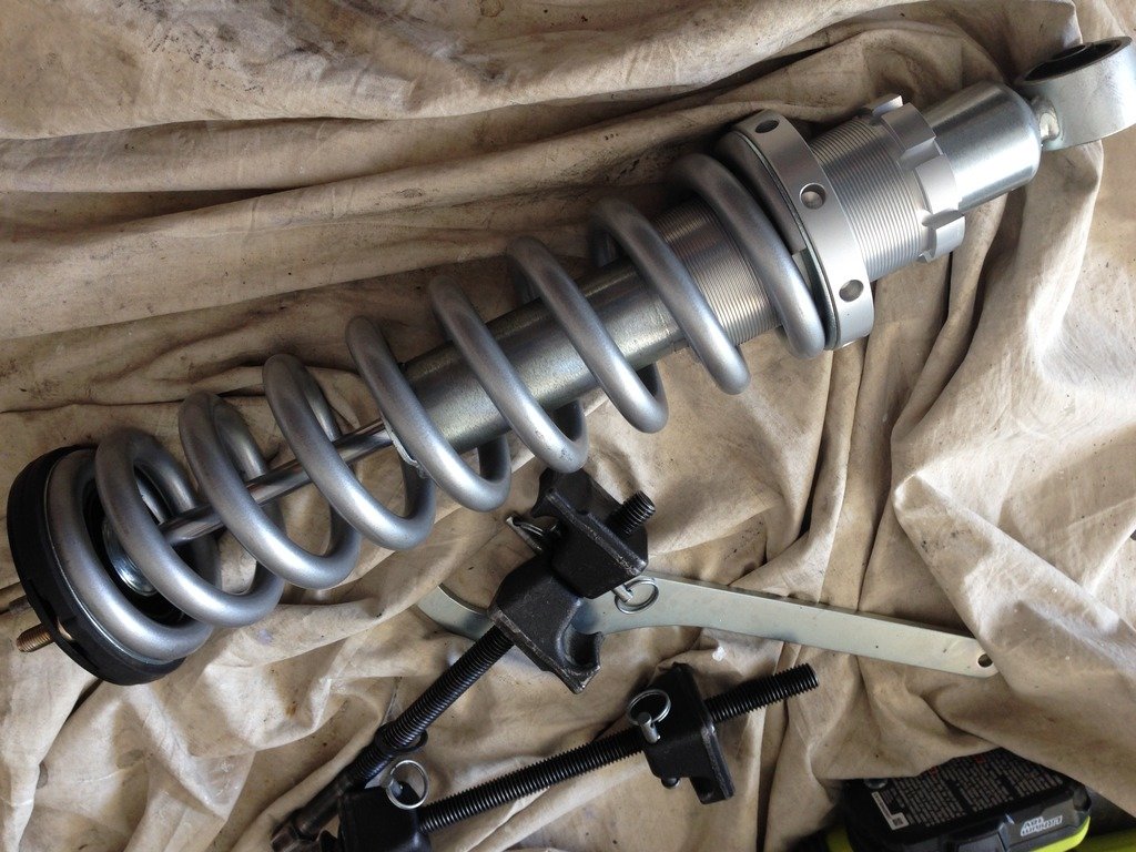

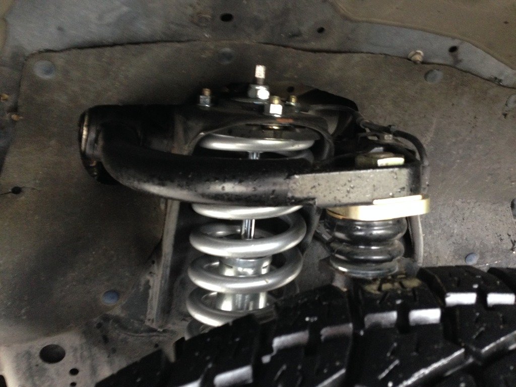

    UPDATE!
    Got the Toytec coilovers installed on my 5100's with the 500lb springs. The 500lb Eibach springs are about an 1" shorter than OME 881's and the coil diameter is thinner. The install went very easily. Only issue was that I set the threads at 1 " exposed which resulted in a stock height. It was a pain in the ass cranking these coilovers mounted for another inch of exposed thread which resulted in about 2"-2.5" lift. If I had to adjust that much again, I would remove the assembly from the truck and compress the springs. Small adjustments are fine mounted on the truck but doing an inch was tiring with all the spring resistance. Right now the measurements are 23" from hub center to fender with about 50 miles driven.
    And the results are............
    A GREAT RIDE! They ride SO much smoother than the OME 881's on 5100's. They dont rattle the truck apart and the stiffness improved greatly with a lot less bouncing. I was really worried about this investment but I am so glad it worked out so well. I am guessing this is due to the thinner springs with less of a preload. The shorter Eibach springs appear to be sitting lower on the shock body than the 881's with the 0 clip setting. Thanks for all the help guys!
