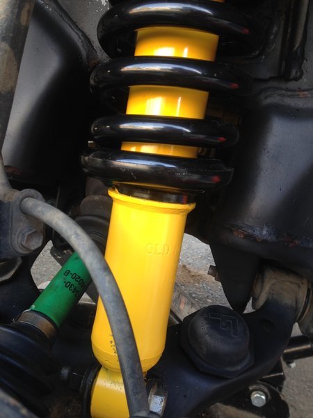

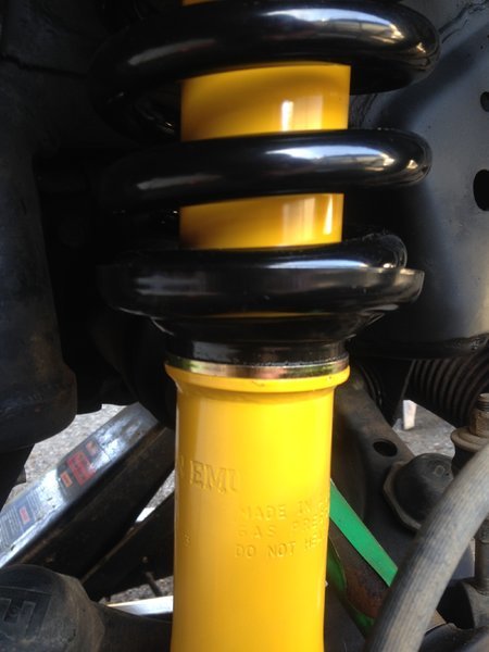

    Currently putting on my OME front struts and noticed this gold washer. Is this the trim packer? Why is it only on my drivers side?

    probably to accommodate for the extra weight on the driver side. Like you and the fuel tank. Ome rear springs are stiffer on the left side as well to accommodate for the gas tank weight
    it looks like a tiny preload spacer to stiffen the spring a hair

    Yes, that's a trim packer. Driver's side has gas tank and usually you, the driver. More weight. Small truck, makes a difference.

    Yeah, it's easier to make the left and right side coils identical for manufacturing purposes, then offer a little trim packer to help with the lean
