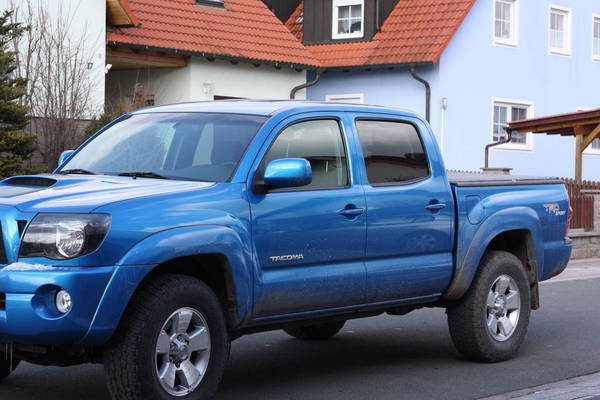

    Pre lift back in Germany

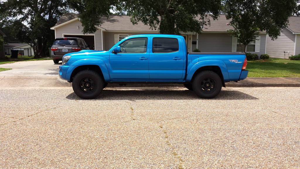

    Post 883 instal

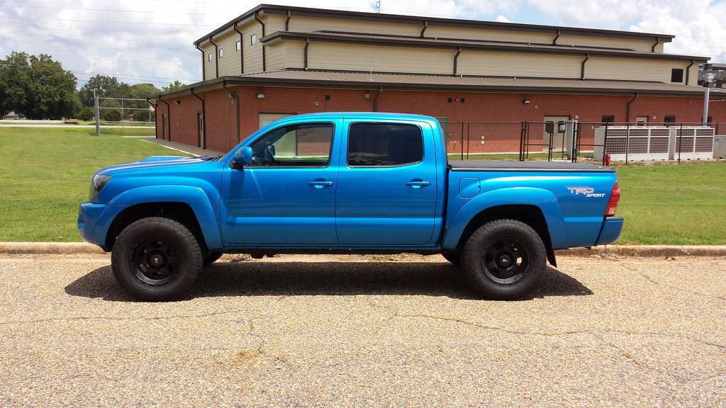

    Post 883 and Pro Comp 7089 instal

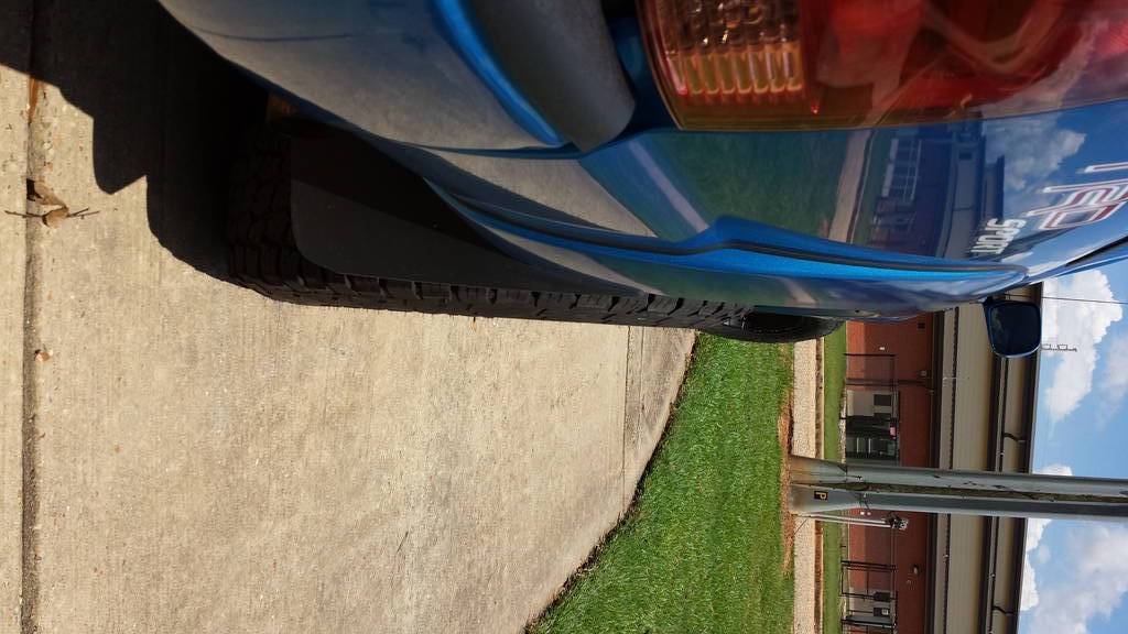

    Pro comp 7089 - 4.5" BS. This is how much the rear wheels stick out now
    1.25" of lift isn't much but all I really wanted to do was level the front end out and hopefully improve the ride with new shocks/springs.
