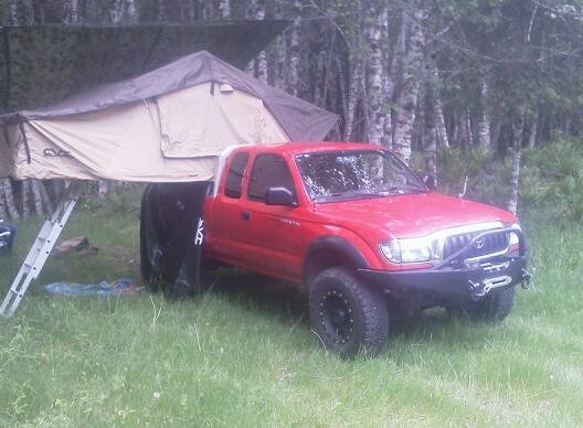

    I had a 03 extra cab, v6. I ran 881s with 265/75/16s. I had a plate bumper with a 8k winch. I was very happy with the set up.

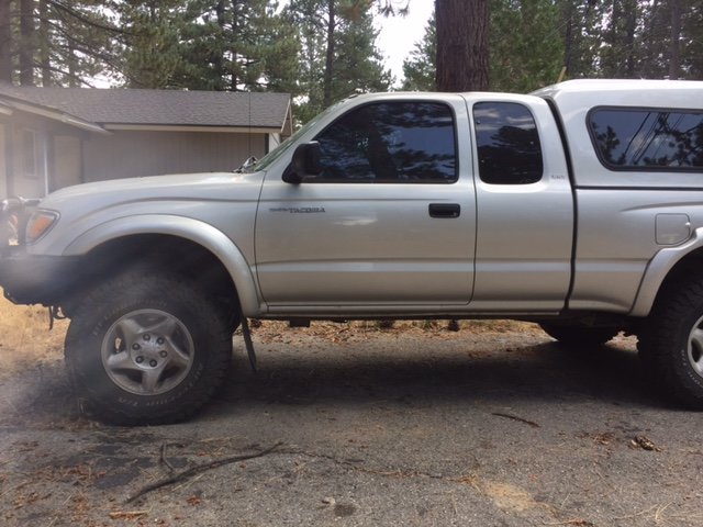

    I have 881s and after settling I've got barely over 1" of lift out of them with NO weight added in the front. If you have weight, stay with the 883s. The 881s are only 500lb springs, not much better than stock and are not recommended for added weight. The 883s are 590lbs and meant for the weight of a bumper, winch, skids, etc. In hindsight I really wish I had gone with the 883s.
