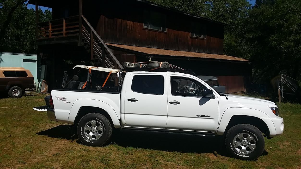

    Currently I am running ome 883's with nitrochargers with the tsb leaf pack. My truck is getting the frame done so it is a good time to take it to where i should have had it before with 2.5" front and an 1.5" aal on the rear. I like the way the 883's ride but hate the idea of using a spacer. That being said daystar makes a poly spacer with a 1.25 lift which would get me where i want to be. The other options are getting new springs (885) or getting some bilstien 5100's to get the additional lift. Any suggestion?
    I also am wondering if i should drop the front diff at 2.5"
    Any input would be great, Thanks

    I put 884 on mine , no alignment issues or vibrations 885 are right at the create problems point ? I have 265 tires for now ,will put one size bigger on soon ,my 2 cents
