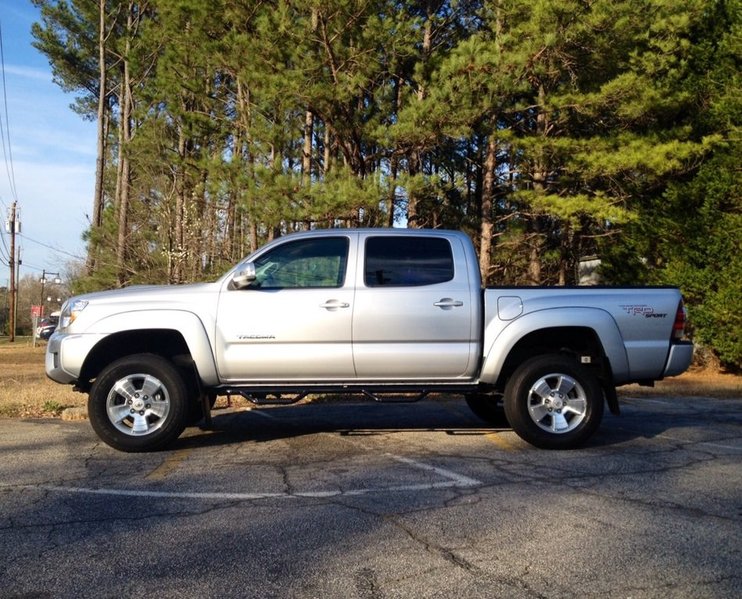

    Though not advised (without new UCAs), here are OME 884s set to .85 on 5100s:
    3" up front, 2" in back with Deaver AAL. Measured from center of cap to fender:
    Stock: Fronts: 20" Rears: 21.5"
    With Lift: Fronts: 23" Rears: 23.5"

    im going to install them at .85 as soon as i figure out what uca's im going to buy. maybe 4" is a little much. for some reason my truck sits considerably lower in the front compared to other 4x4 reg cabs that i see running around

    Are you a little ass low or is it just the picture?
  13. Jul 15, 2015 at 1:40 PM
    #33
    MadDaddy
    MadDaddy Pork Rind Extraordinaire
    Jan 1, 2015
    #145405
    6,844
    53 Miles West of Venus
    Many & varied
    It's the picture. I was concerned after taking this picture so I went back and measured to be sure. Stock: Fronts: 20" Rears: 21.5" With Lift: Fronts: 23" Rears: 23.5"
    T4RFTMFW[QUOTED] likes this.
