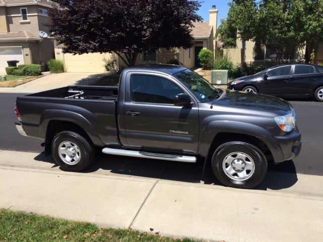

    I have a 2014 4x4 Regular Cab with 5100s set at 0 and 884s. This setup gave me almost exactly 3" of lift.

    do you have any pics of the truck

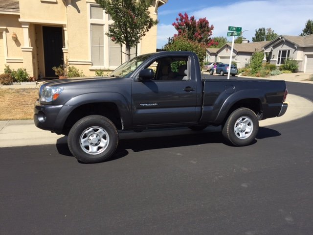

    installed the ome 884s and the billys set at 0, gained about 3.25 inches. they still need to settle but im happy with it
    before
    after

    Wow, big difference in the 2.7 I guess.
    My V6 DCLB (granted, the heaviest config) got 2" dead on with 884s.

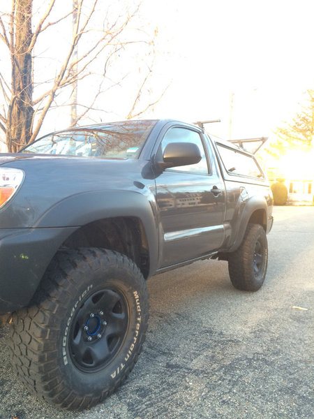

    i have 5100s @ .85 with the eibach 1.6 coils and im just under 3 inches. i think i want to go with 884s so i can set the 5100s back at 0. i also have a RC

    Your truck looks good,
