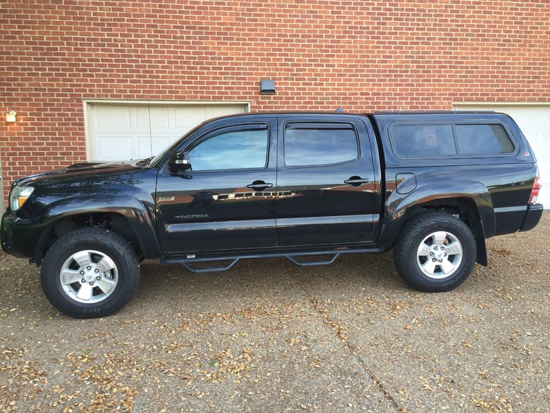

    I searched quite a bit before ordering 884's for my truck, and I never found a whole lot of information. I thought I would share what I have so far.
    My truck is a 2015 DCSB Sport 4x4. I didn't have a need for a full 3 inch lift. The truck is a daily driver, and my wife and kids are pretty short. If I didn't need the full 3 inches, I didn't want to get into UCAs. I already had an Icon AAL in the back. I have a camper and drawers so the rear was sagging by 10k miles. This got me a net lift of around 1 inch in the back. This lift over the stock had the rear sitting pretty high so I wanted it closer to level. The 885s seemed like they would give more lift than I wanted or needed, so I went for the 884s.
    I just got them installed today and went for a speed bump run and then an alignment. I was pleasantly surprised at the numbers they got. At least in my case, the 884s aligned great WITHOUT UCAs. I'm happy with everything so far!
    Front: 884 springs on N140S struts with trim packer on drivers side
    Rear: Icon aal without overload spring, 60091 shocks
    Driver Front: Passenger Front:
    0.2 Camber 0.3
    2.3 Caster 2.6
    0.0 Toe 0.0
    Hub to fender after: (sorry no before)
    DF 22 PF 22 1/8
    DR 22 PR 22.5

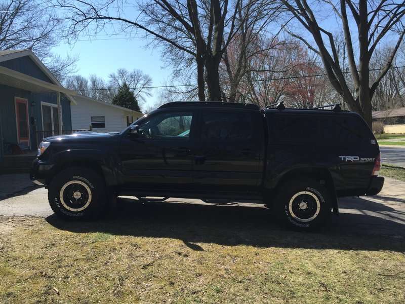

    twinsies!

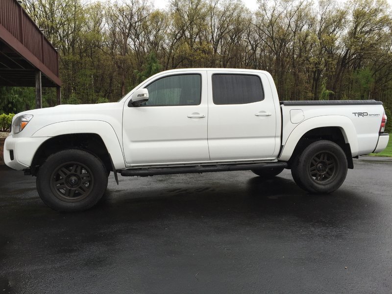

    Hi Matt, Are they the 3 inch nfab bar? I had them and returned them because my driver side was right against the body of the truck.
