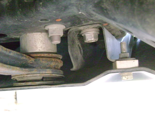

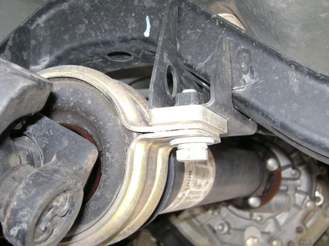

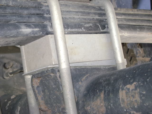

    I went 3" and to save trouble I purchased the diff drops and installed them. There are a few guys on here that don't have them and are pushing their trucks to the limits and aren't experiencing any troubles. They are cheap and easy to install you could always go without and if you start to experience any trouble get them. Here is a pic of mine not as high tech as you would think. Some people are just using washers to achieve the same affect.
    Front diff
    Hanger bearing
    Rear shims under block
    I don't have the UCA's and am experiencing no troubles.
