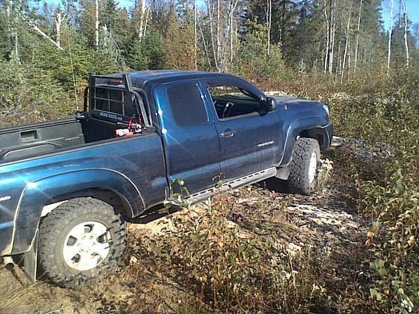

    Im in the same boat kinda... got 5100s in front @ 1.75 and it still sits 3/4 inch higher in the rear... no snugtop or anything... Im looking at getting 844s to bring me up a little more (hopefully 2 inches exactly). Plus the 5100s with the offroad springs the ride kinda sucks. From what i read the 884s are my best bet for a little more lift without UCA issues

    Do you have a pic of the truck from the side- so i can get an idea of the rake. My camper maybe enough to correct the rake you have...so i might just have to go with the 5100s, but I prefer the 884s.....

    Thats before the 5100s... pretty mean rake i had on my truck.
    I know this isnt the best pic but u can kinda see its a little lower in the front then the back still, hardly enough to tell... i can snap you a better pic tomorrow in the light if you like though to give you a better idea
