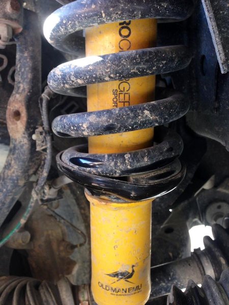

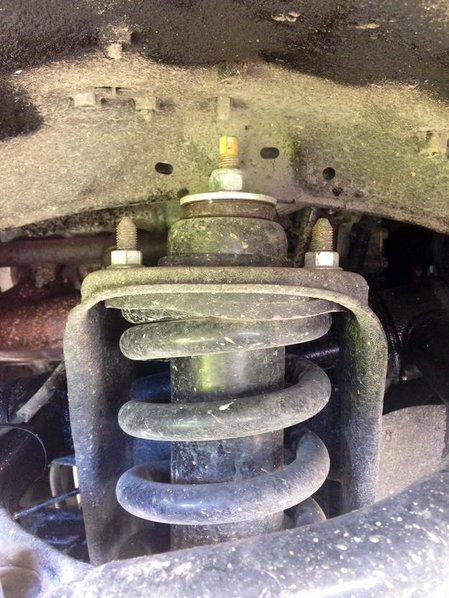

    OP- Can you take a pick of the bottom side of the lower coil seat please.

  12. Sep 9, 2014 at 12:17 PM
    #152
    Rocket67
    Rocket67 Well-Known Member
    Mar 21, 2014
    #125829
    128
    Newfoundland Canada
    14 DCSB TRD Sport 6SPD MGM
    N-fab w/ IPF 968, TRD cat back, 285 & 265 duratracs, pro comp 7036. leer xl
    pics. Running LR UCA and swaybar removed

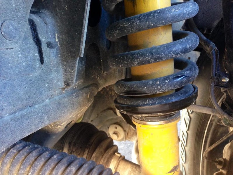

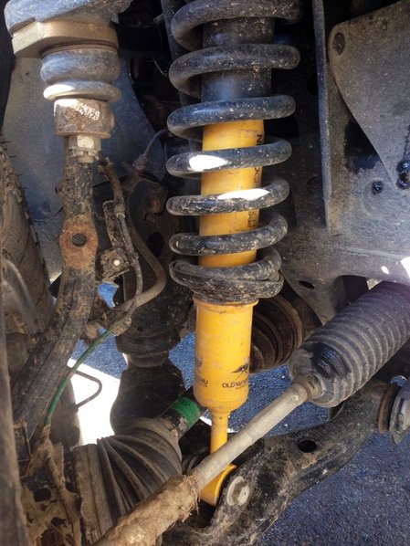

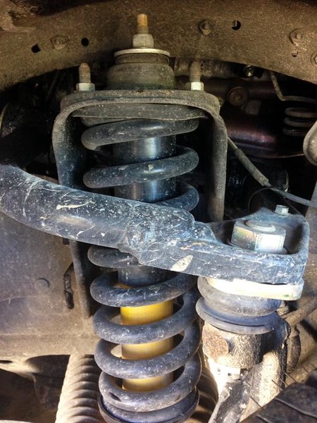

  13. Sep 9, 2014 at 12:19 PM
    #153
    Rocket67
    Mar 21, 2014
    #125829
    128
    Newfoundland Canada
    another
  14. Sep 9, 2014 at 12:22 PM
    #154
    BradyT88
    BradyT88 Well-Known Member
    Nov 3, 2011
    #66419
    36,723
    Wboops. Somewhere along the way I forgot you had OME shocks and not 5100's. The OME's banging seems to be a known issue due to their lack of travel compared to 5100's.
