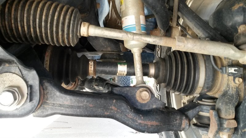

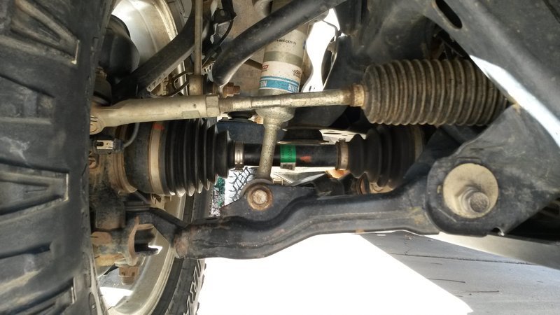

    How the truck sits now:
    R CV angle
    L CV angle

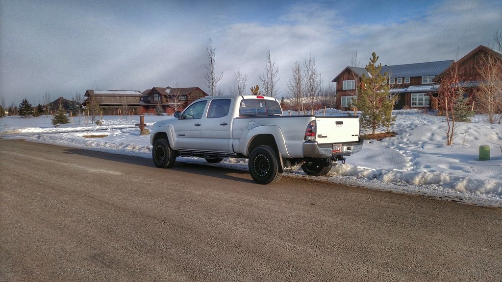

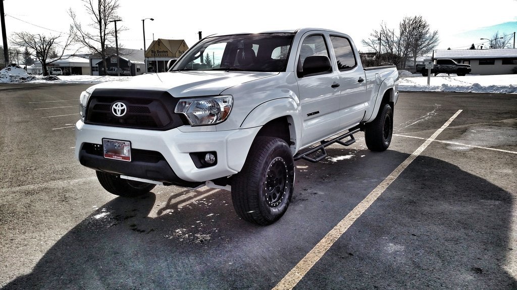

    I'm running 887's with OME shocks. Full set of steel skids front to back and Dakar leaf pack. Only running 265/70/16 tires right now though.
    Photo to show the ride height

    Looks really good. what's on the rear?

    Here's a couple more photos on more level ground. I've never really taken much for straight on level side photos. Though I think I've got some rake.
