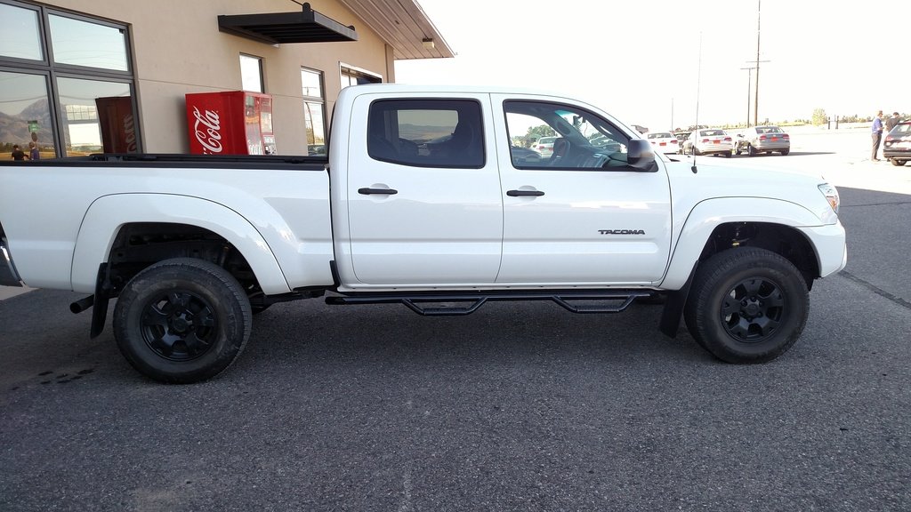

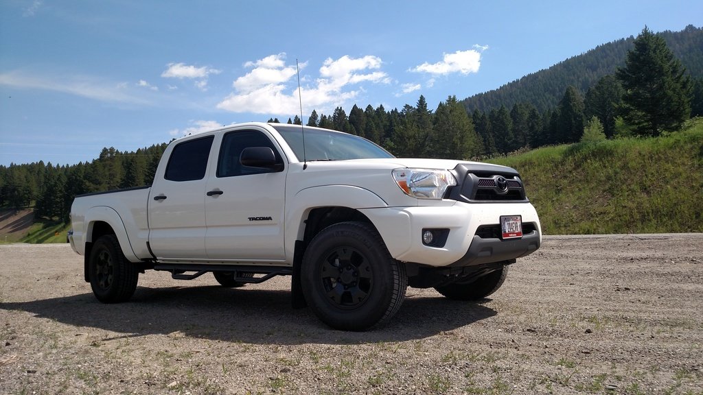

    Wow I was looking at old photos of my truck. Here's a profile of before and after the lift. OME 887's and Dakars.
    Can very clearly see the gap between tire and wheel well change.

    887's with no weight up front can go 2.5-3"
