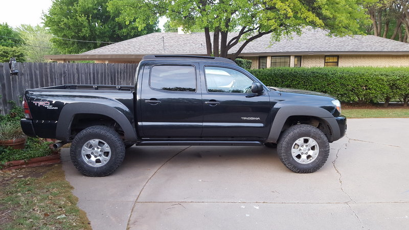

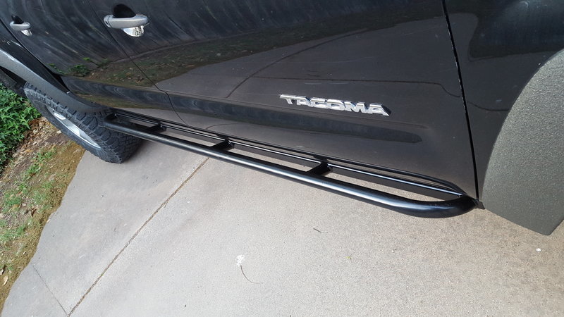

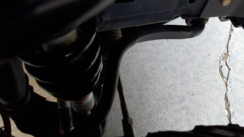

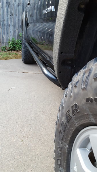

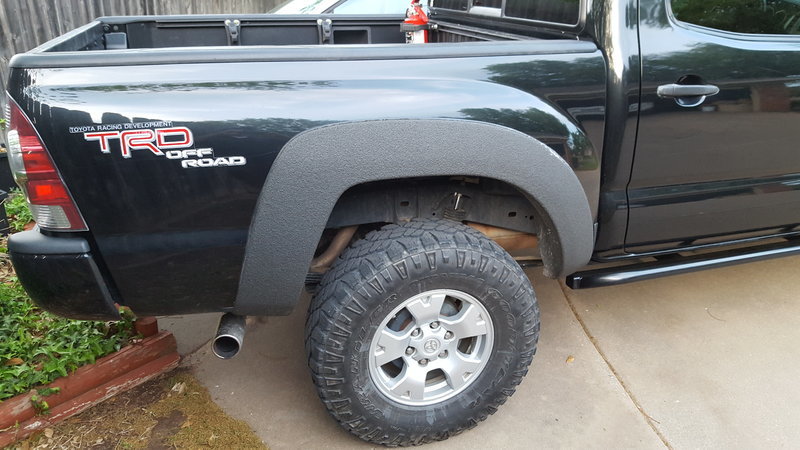

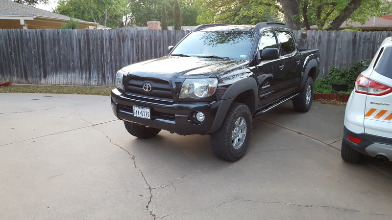

    Thanks for all the advice and pics of your trucks!! Lift finally done.
    also got the sliders at the same time from shrockworks
    Went with 887's and went ahead got UCA's
    1/4 in spacer for drivers side lean
    1 1/2in wheels AAL in rear
    Front L=22 1/2 gained 1in (change is from bilstein's set at 1.75, rear TSB pack)
    Front R=22 1/2 gained 1/2in
    Rear L=24 gained 1 3/4in
    Rear R=24 gained 1 1/2in
