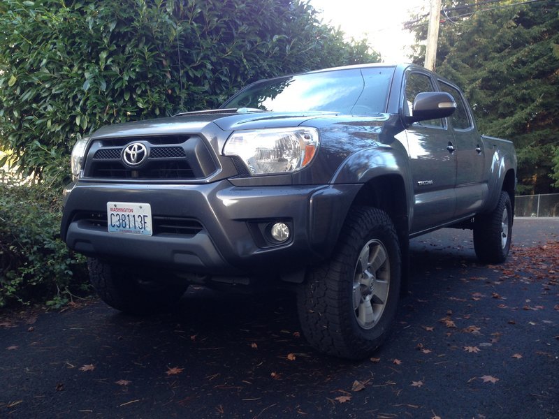

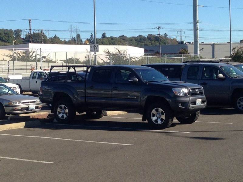

    IMG_1163.jpg I got 1.75 with 885's on 5100's at zero. I put .5 spacers on top and got 2.5 exactly. Go with 887's or do what I did.IMG_1085.jpg

    265/70/17. I'm going to get bigger in a week or so. I have been doing way more off roaming than I thought I would. Ordering BP-51's this week.

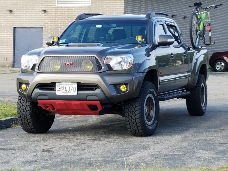

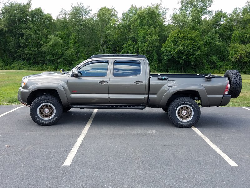

    My truck with OME 887's on 5100's with ICON 2.0 shocks in the rear and the ICON 3 leaf progressive AAL in the back. Also have Camburg UCA's up front, ball joint type.

    The front is not noise high it's just the pic. The front is actually about 1/2 inch lower

    3 inches up front
