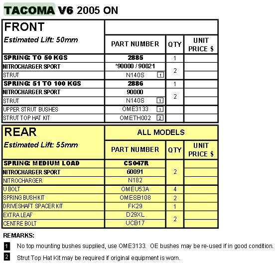

    Yes. The OME product guide states 885 coils will provide an estimated 50mm (2 inches) of lift with up to +110 lbs extra weight. That +110 lbs could come from a steel bumper.
    So a double cab running 885 coils, sans extra weight, provide about 2.5" of lift. Which is what a lot of folks do around here. Agree.
    To your point that with extra weight, it may help with the OME shock topping out issue. That's quite possible.
    I see exactly what your saying.

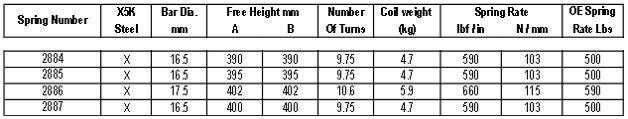

    It's worth mentioning that OME markets TWO DIFFERENT shocks for the Tacoma. The
    90000 and the 90021.
    As I understand it the 90021 is lightly valved... That's the one I had. It's quite possible that the 90021 is garbage and everybody should buy the 900000 cause it's great. Maybe it would be better for folks who are having the speed bump problem. I don't know...
    All that said, there is no way in hell I could recommend the 900021 product based on my experience.
    Thank you. Thanks for contributing to my understanding. I understand the OME coil better now.
    Hopefully this thread will help someone who is trying to make a decision.
    I hope I don't sound too bitter. I'd settle for my $300 back. I also see no reason to comment any further on this issue from me. If anybody searches they can read and decide for themselves...
    Some useful screen grabs from the ARB/OME product catalog which I referenced...
