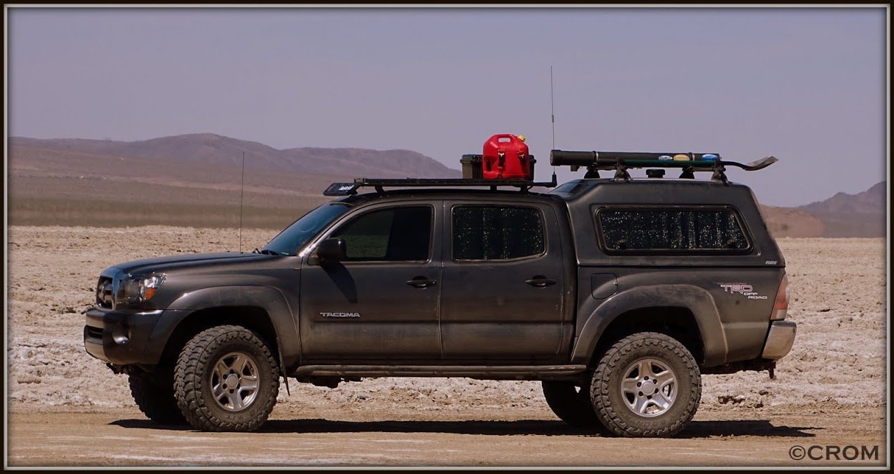

    33.5"... Toyo MT's 255/85/R16 on 4Runner Limited wheels.

    You end up at about 2 1/2" front lift God of Conan ?

    I think so. I failed to take good measurements pre / post lift...so, my bad.
