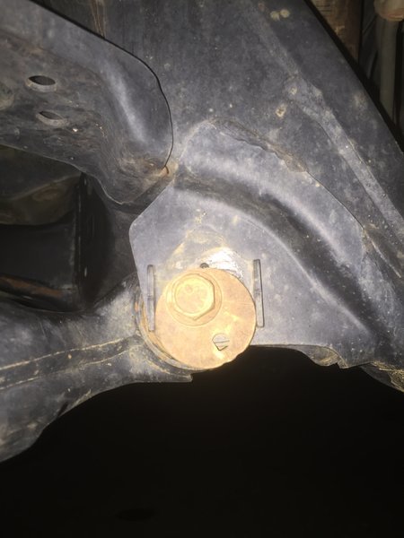

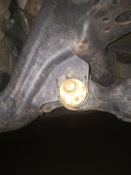

    I can not stand the "slam down" from this kit. I am really confused why this happens and how it will only happen on some trucks. I am even more confused about what happened with my truck. I installed the lift with stock uppers, and had the problem. I then installed Icon UCAs and it went away, and I was so excited! I then took it to get it aligned again and still no problem! Then I started hearing a popping sound and a terrible noise when I went over a speed bump, turns out the shop forgot to torque down the LCA bolt on the drivers side. I got the issue resolved with them. However, the "slam down" is back...:frusty::frusty::frusty::frusty::frusty::frusty: I do not understand how this could be possible!
    The only thing that I see different is the cam tab. As you can see in the picture where it use to be compared to where it is after the retorqued it back down. Could this affect the "slam down"? Should I take it back and have them put it back to where it use to be?
    This is the passengers side, I can't if it slipped or not.
