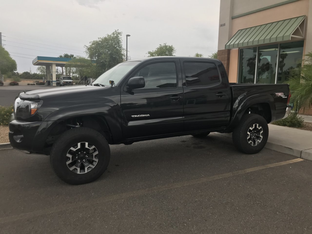

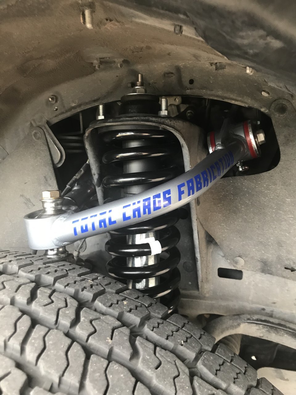

    Just installed 885’s on fresh 5100’s (set to 0 of course) paired with some total chaos UCA. Rides like a dream. (I had a spacer lift before from the previous owner). No complaints. Planted, compliant, not a single clunk or odd noise, even after hitting speed bumps at speed. Rides really really great!
