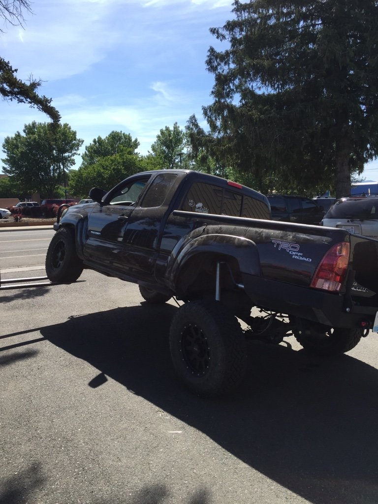

    Any one else start to get a drool when they see this flex :drool::drool:

    Not me. It's an access cab.

    i did say flex though, dcsb 4 life!
