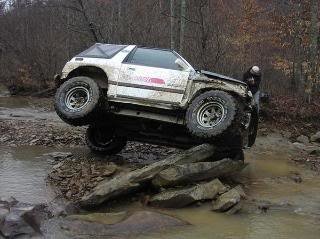

    I have the adjustable ones on now. Don't like them at all. I do have them pre-loaded a lot due to my plate bumper but hard is too harsh for my liking. I have had lifted YJ, Tracker, Ranger, Ram, FX4..I must say my Taco rides the roughest considering the $ put into it.

    that flex tho :spy:
