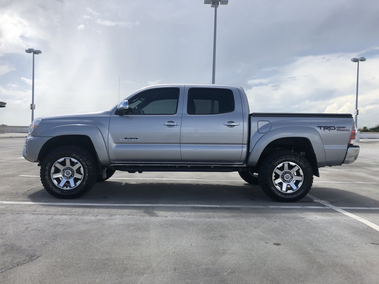

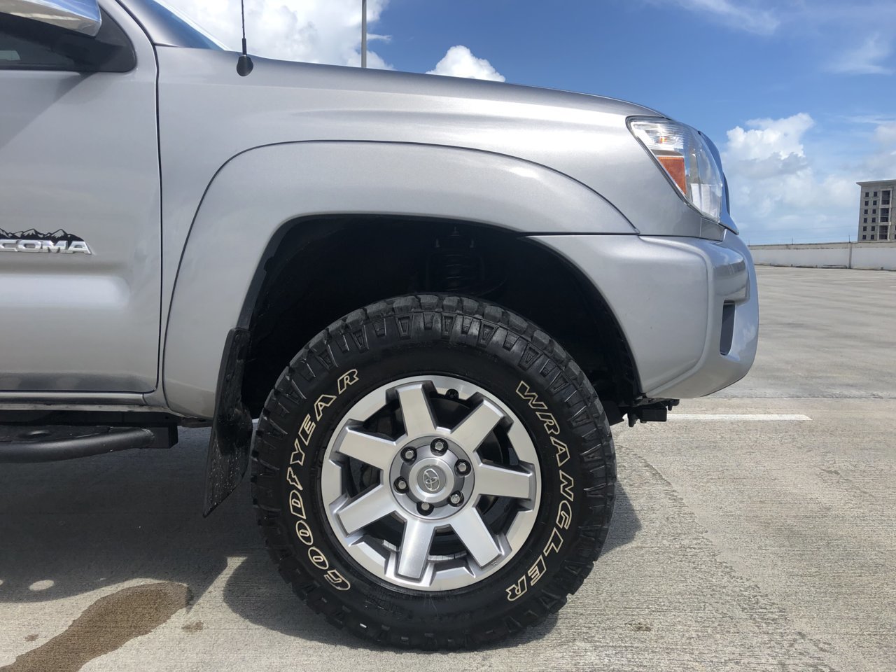

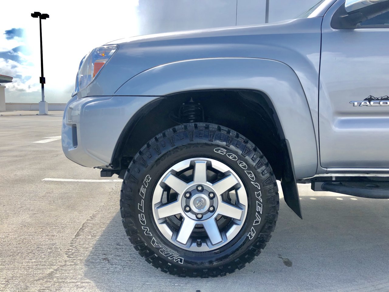

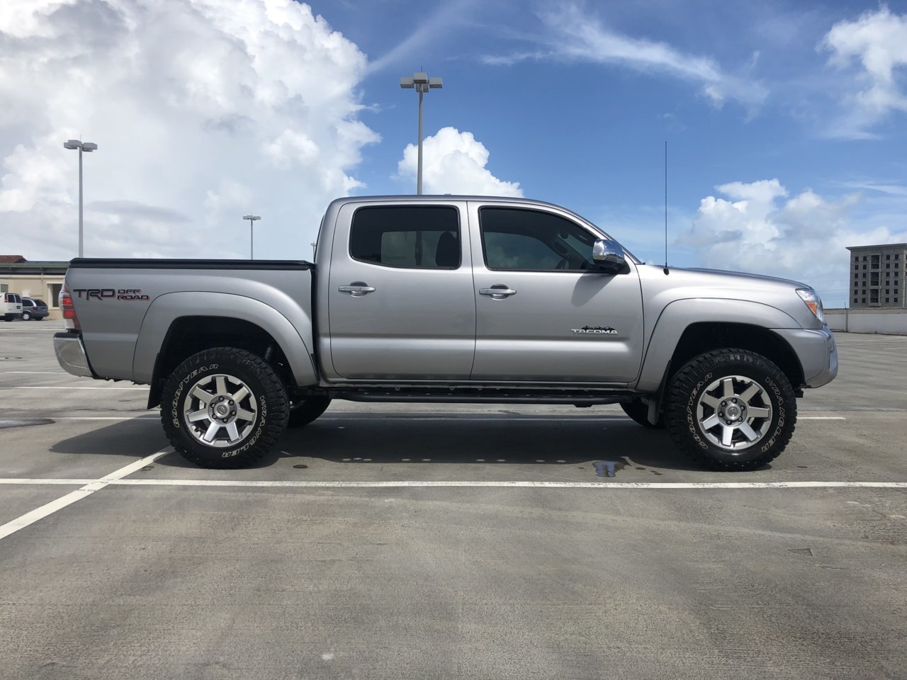

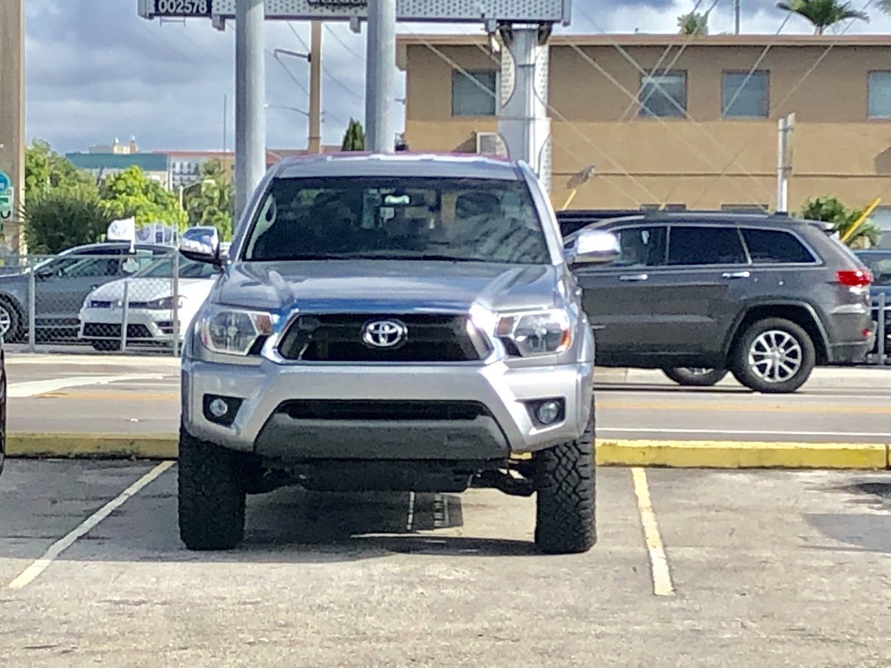

    Hello,
    I have a 2015 DCSB TRD 4.0 4WD with 265/70r17 GY Duratracs "C" & the following suspension. All measurements taken with the vehicles fuel tank full, if that matters.
    FRONT:
    Bilstein 5100s at "0",
    OME 885 Coils,
    KYB top hats with long studs,
    1/2" drivers side top plate spacer.
    REAR:
    Bilstein 5125s,
    Wheelers 3 Leaf AAL with factory overload leaf in place,
    1/2" Toytec spacer plates which bolt into thew leaf pack.
    Ride height specs (hub to fender)
    LR: 24.00 / RR: 24.00
    LF: 22.25 / RF: 22.50
    Even with a 1/2" drivers side spacer I still have a 1/4" lean but it's not noticeable at all.
    Ride Height specs (ground to fender)
    LR: 38.75 / RR: 38.75
    LF: 36.75 / RF: 37.00
    To those of you running this set up would you mind posting your ride height specs?
    The OME 885s replaced a 2" spacer that was previously installed on the original struts. I don't have any before specs but I expected more height from the front set-up I currently have.
    Thank you.
