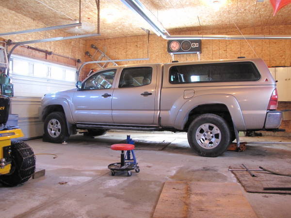

    does anyone have a photo of their truck with 885's up front and the tsb in the rear. I want to make sure it is level???? please post!

    ^^^^ the canadian has 885s look at his gallery but he added new Dakar leafs also I like his cedar shell
    U might be nose high with only tsb and 885s .. U will need an aal + tsb
    Just get blistein 5100s set at 1.75 and u will be level With tsb

    You are going to be nose high, but I wouldn't preload those springs. Just get an aal and you should be fine.

    Funny i have the 5100's set at 1.75 now and trust me it aint even close to level. about 1.5 high in the rear

    Kick them up to 2.5 then

    This is 884's on sport 9000 shocks with stock TSB rear. Did not take any measurments , just this picture before adding the aal. Looked pretty level to me but I can not be 100%. The floor in the picture is sloped to the door. Sorry best I have.
