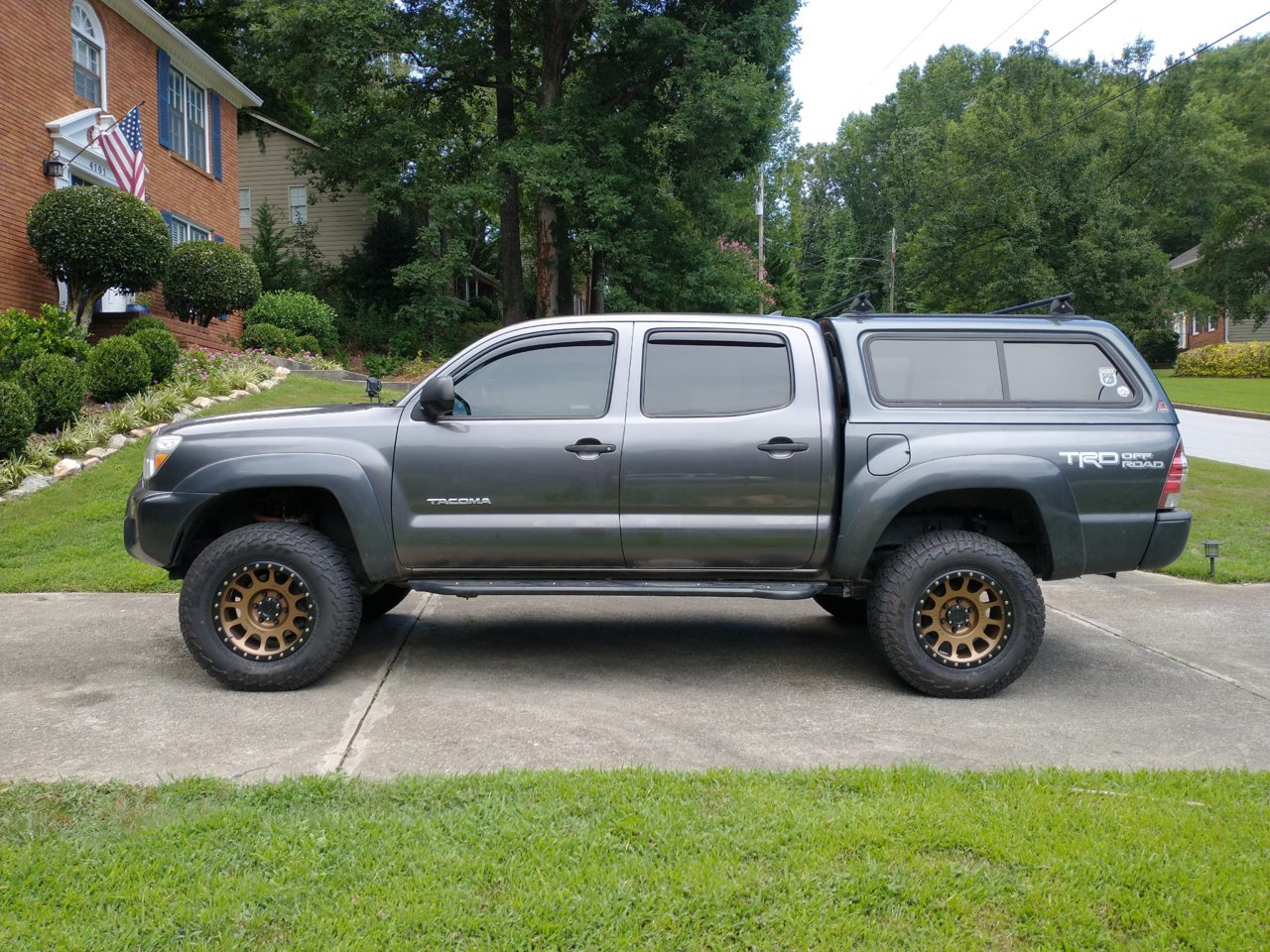

    I had 5100's with 885's. After the US offroad low pro bumper with winch (steel cable), the front started to sag more. The ride was still nice and comfortable. I changed over to 886 springs and while the height is great and where I want it (higher than the 885's ever were even with stock bumper), the ride is much more stiff. But its not soo stiff as to be a bad ride in my opinion. My winch and bumper combo probably weigh less than others on the site though.

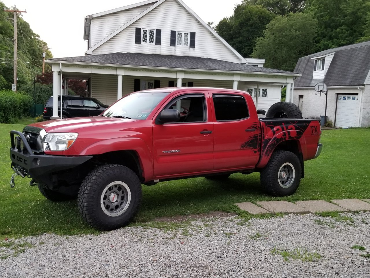

    I actually have a set of 886's for sale, they were on my 2013 Tacoma BAJA dcsb with a steel Demello winch bumper and 12.5k lb winch with steel cable. I had 3" lift set at zero. It rode firm, not harse but that's also because I had 285 75 16 load range e tires on it. I lowered it back down to 2" with the 887's and went back to 265 75 16's because I tow and haul daily. Let me know if you'd be interested in buying the 886's, they are just sitting in my garage. $120 for the 886's. Only 10k street miles on them.

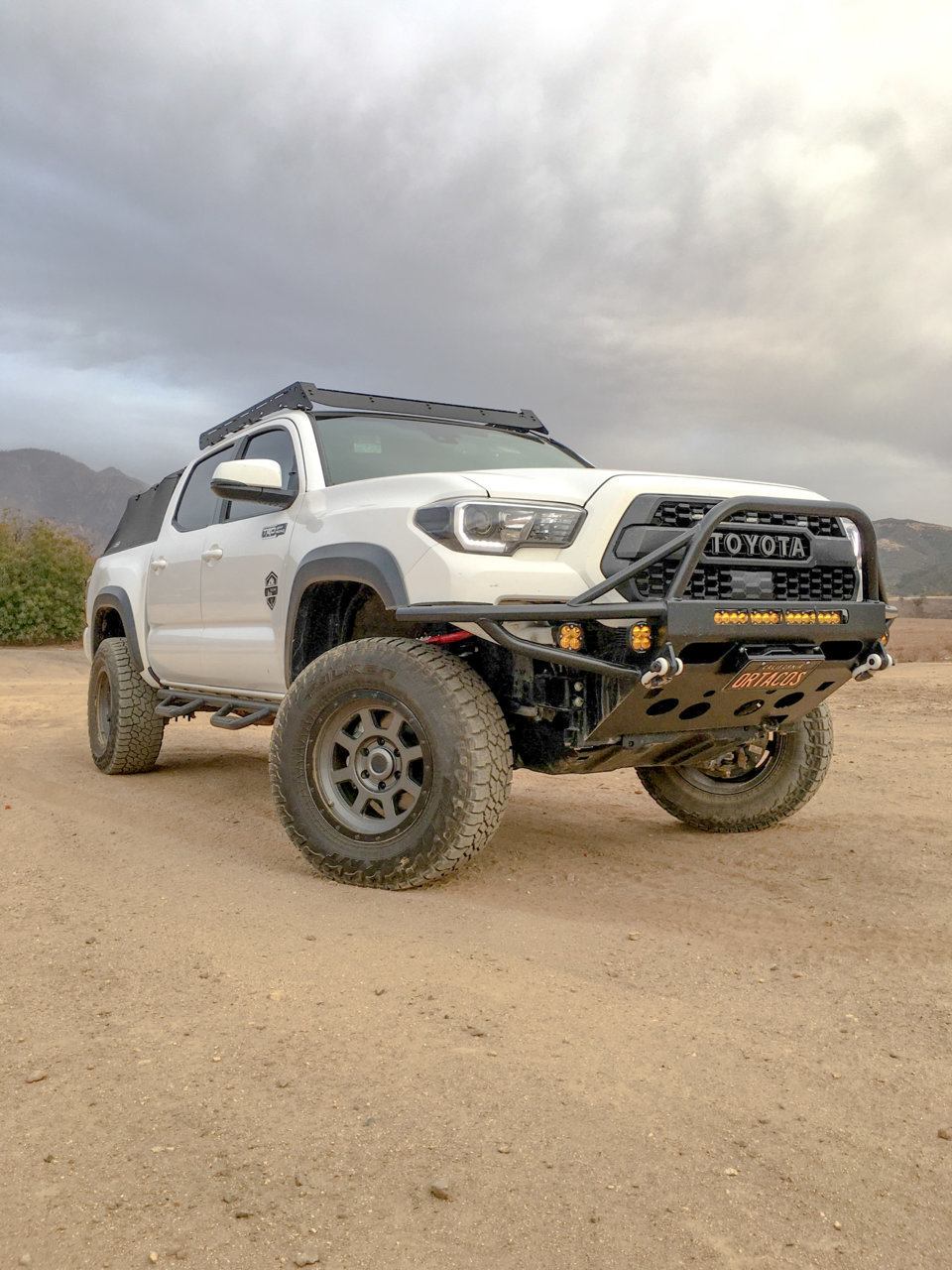

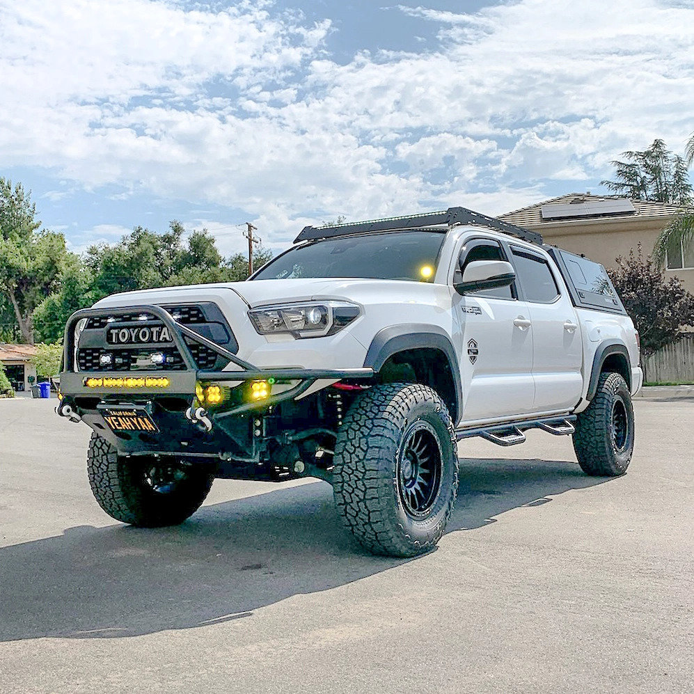

    If you are thinking a front bumper in the future the 886 will be good. I don’t have sliders but I have a front bumper and that wasn’t enough. Rode a little better when I got my skid plate.
    set the 5100s to zero for sure
    here is mine.
    Front:
    5100s
    886
    JBA UCA
    Rear:
    Icon 3 progressive AAL
    5160s
    (RSI smart cap camper shell, roughly 200lbs)
