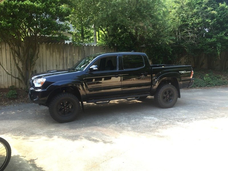

    Looks good man! You go with 285 or 265 tires?
    Me and a buddy installed mine last Wednesday... Loving the ride!
    But kinda wishing I went with 285s when I bought tires a few months back, the 265/75 just don't quite fill at the wheel well all the way. I am enjoying the 17 mpgs with the 265/75 tires though!
