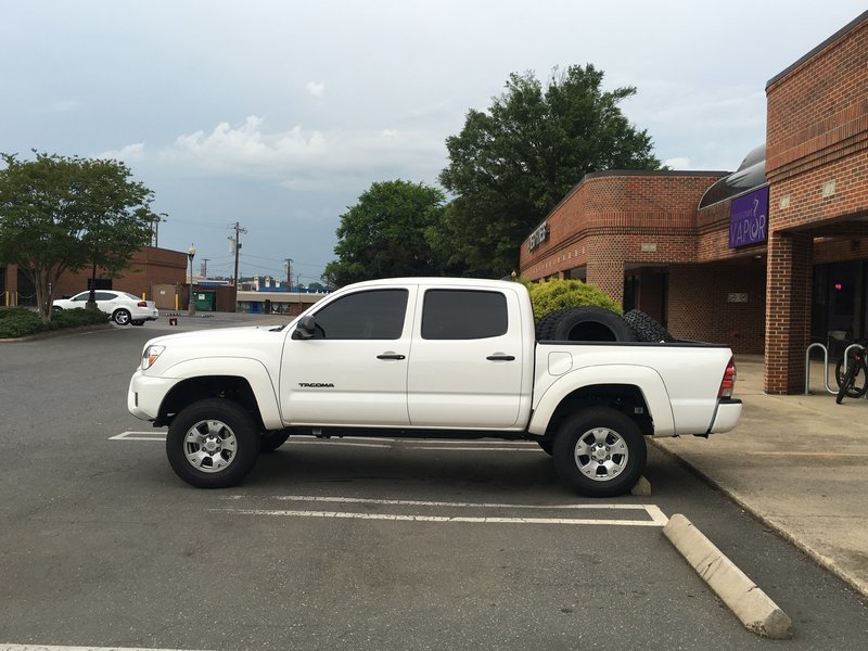

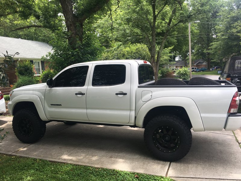

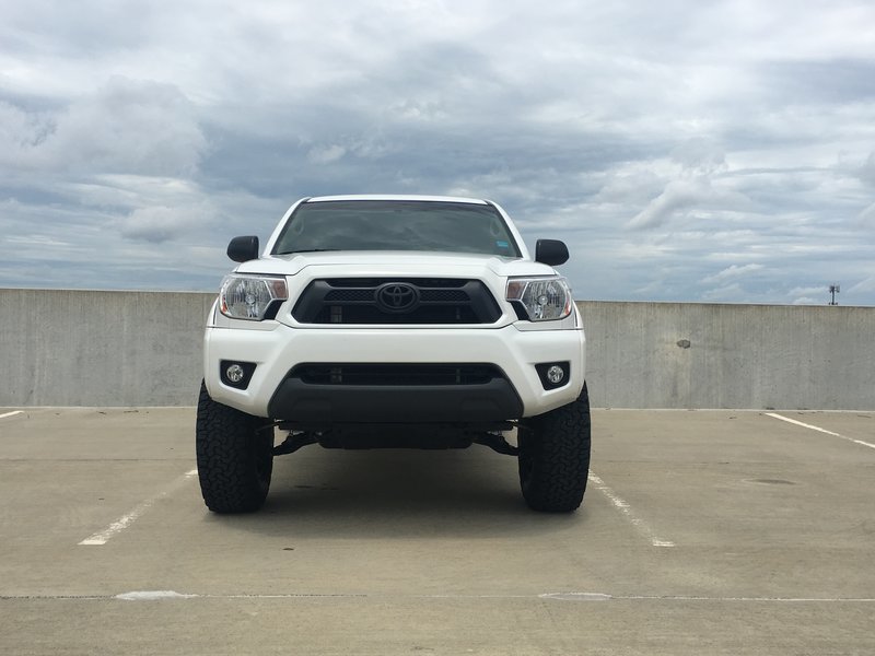

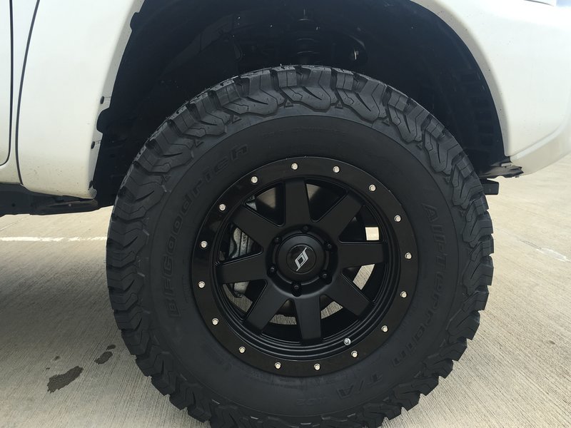

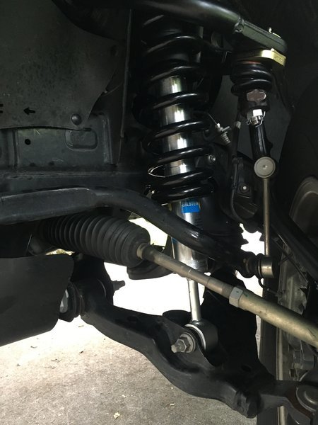

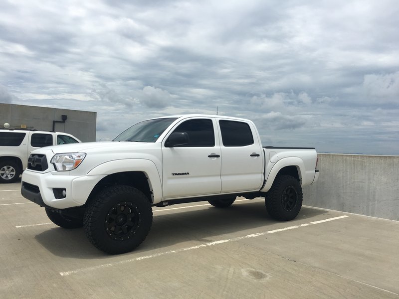

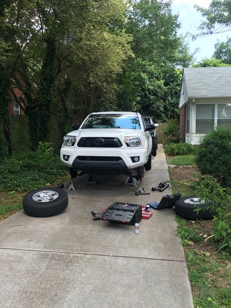

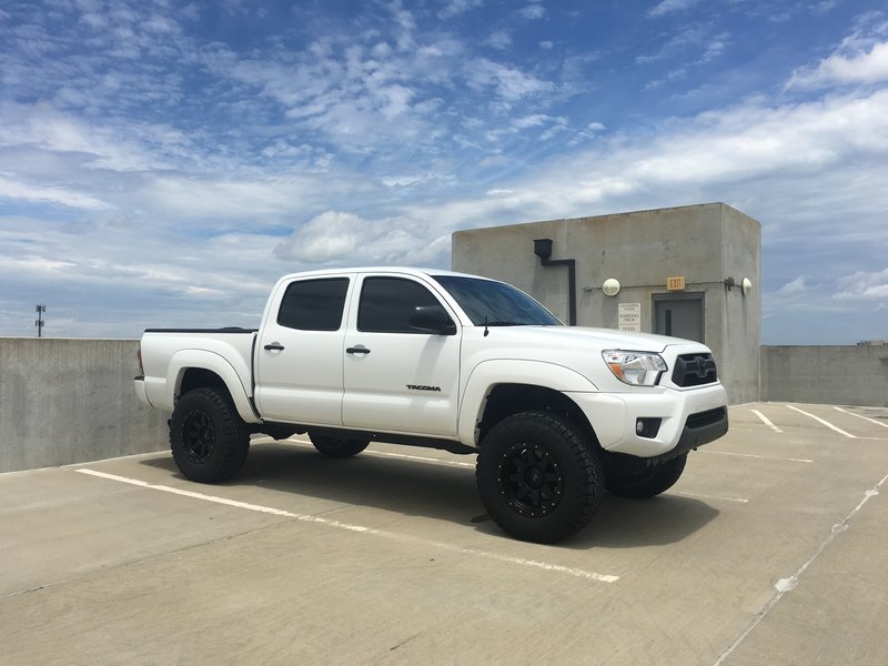

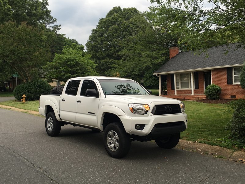

    Finished up today with rims and tires. There are some pics after lift install with stock tires and then today with the 285s. Huge thanks to @ajohnson for all the help with the lift install yesterday.
    5100s (4)
    OME 887s
    LR UCAs
    Driver lean spacer (headstrong)
    Deaver AAL
    285/70R17 BFG KO2
    17x8.5 scs sr8
    VR812, Tibetan Nomad, JDB02 and 5 others like this.

    Looks great!! Did you end up rubbing at all? I had to have a cab mount chop done and even still rub a bit at full lock in reverse...

    Thanks! I have not trimmed anything yet. I'll definitely trim the inner plastic and go from there.

    I was a bit leary on cutting anything due to sometimes you end up with jagged/rough edges. I used a heat gun(wife's pink crafting heat gun) lol. And with a little heat I molded it where I needed it. Just a tip.
    By the way Truck looks good. :thumbsup:

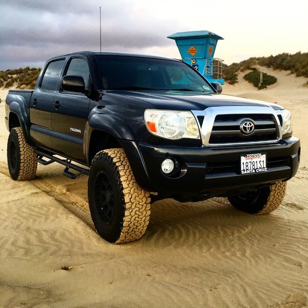

  18. Sep 11, 2016 at 9:20 PM
    #278
    Svizzusi
    Svizzusi Lifted 2009 4x4 DCSB
    Apr 23, 2015
    #153785
    69
    Steve
    San Luis Obispo, CA
    Bilstein 5100/ OME 887/ 285/70/17 BFG KO2/ 17" ProComp 7032/ OME Dakar/ LR UCA/ Superbumps/ AllPro Flip Kit
    3" Lift
    5100/887/dakar/LR UCA
