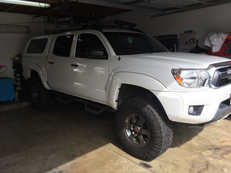

    I just did it this morning 1/2 in spacer on driver side and 1/4 spacer on passanger side got back my 3in of lift in the front
    Before
    Left and right even 2 3/4
    After
    Left and right even 3

    I'm running 285/75/16 duratracs , bilstein 5100 ,ome 887 coils with 1/2 inch spacer on driver side and 1/4 inch spacer on passanger side LR upper control arms.
    Rears I have bilstein 5125 with allpro expo leaf pack with the 3rd leaf pulled total lift witch gave me just under 3in lift with the snugtop rebel on
    Measurement from hub to fender
    Right front 23 inches
    Left front 23 inches also
    Right rear 24 7/8 inch
    Left rear 24 3/4 inch
    I also did my alignment today
    Right and left camber 0
    Toe right and left 0
    Caster right and left 3.0
