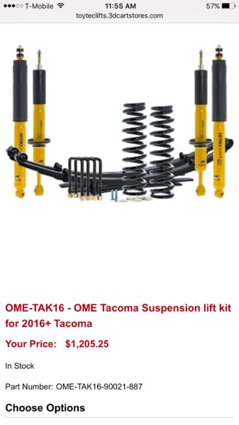

    Has anyone order this kit?

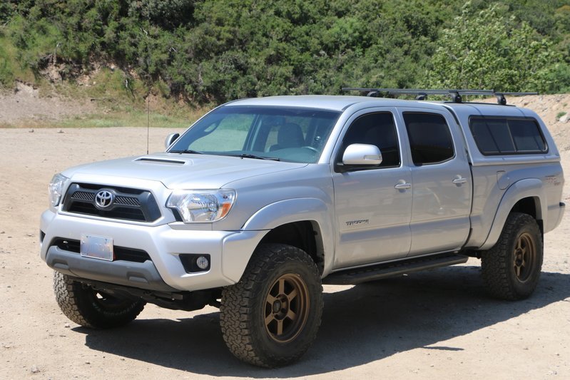

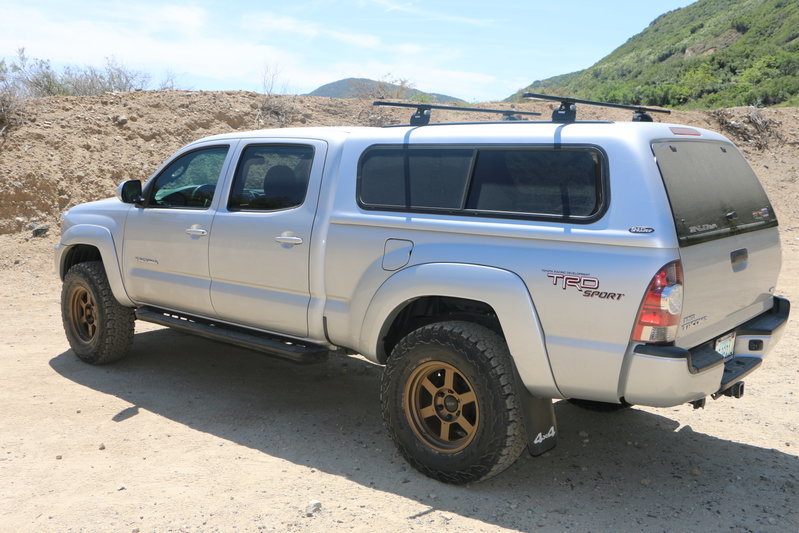

    6182958864_IMG_3597.jpg I recently lifted my taco with 5100 and 887 shocks and couldnt be happier, installed a wheelers 3 aal in the rear and installed RRW type 4 wheels with some bfg 285-70-17 had some rubbing issues, had to remove mudflaps and I'm going to have to do a cab chop, but at the moment I did my alignment and raked the caster 3.25 degrees so I can get some added clearance, after the cab chop going to bring the alignment back to 2-2.5 degrees caster IMG_4434.jpg

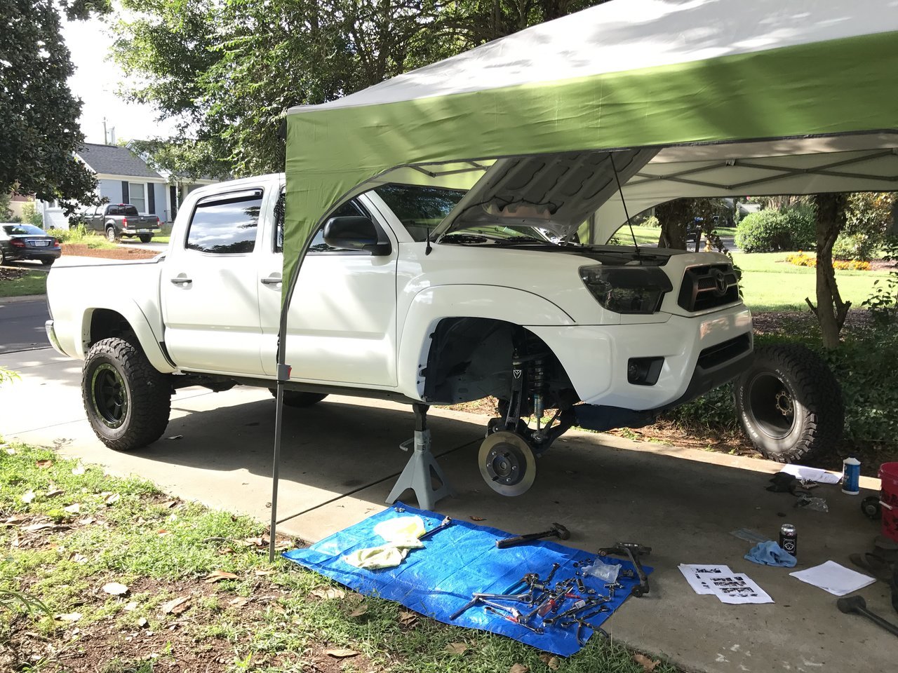

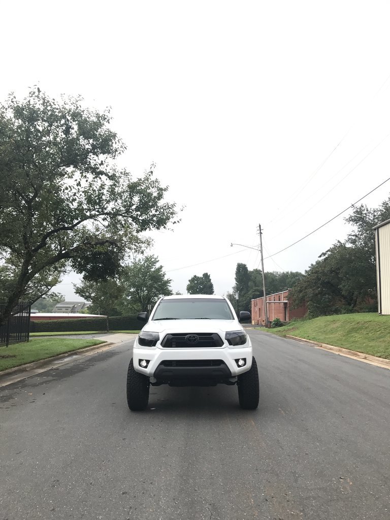

    I've been running 5100's with 887's and SPC Light Racing UCA's for about a month now on my 13 DCLB TRDOR and i LOVE it. Rides better than stock I think. I'm still waiting on my bumper (8 weeks on a 4-6 week Pelfreybilt lead time :rolleyes:) but I'm expecting it to settle a little and smooth the ride out some when I get that on, but I'm happy now even with a stock bumper and no armor. I did the Dakar AAL in the back and it sits a little higher in the front but I think the bumper will flatten it out. I'm still on stock Rugged Trails until they wear out. I'd say with the current setup I'm at just over 3" in the front and right at 3" in the back.

    That stance is sick.
    Looks bad ass
