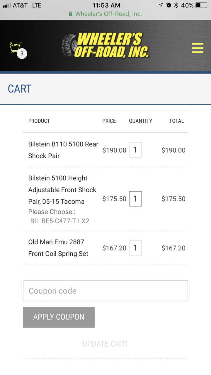

    Hi guys
    I really need your help. I read all the tread and i'm totally lost...i'm french so i don't understand everything. I need to change my coil and shocks. I currently have OME 2885 with nitrocharger for many years, my truck is a 2008.
    I want to go with the 5100 and the 2887 but i'm not sure about the right parts number for the Bilstein. I'm also lost with the rear one. I have Dakar leaf pack...do i need to go with the extended one or not.
    You can't imagine how you help me!
    Thanks
  10. Nov 11, 2017 at 8:54 AM

  11. Nov 11, 2017 at 9:22 AM
    #391
    getpsycho
    getpsycho Active Member
    Jun 17, 2010
    #39073
    30
    Quebec
    2008 TRD Off-road
    Thanks!
    Are you sure about the rear one? On the wheeler website they said to don't use this shocks with less than 4" lift?
  12. Nov 11, 2017 at 9:39 AM
    #392
    TacoTRD78
    TacoTRD78 Well-Known Member
    Jul 27, 2015
    #160390
    6,749
    John
    Stuart,fl
    15 tacoma trd off road
    4X Innovations Sliders Tech deck Bilstein 5100's OME 885 CB radio install Rear diff breather mod After market front bumper lights Redline hood struts Shorty antenna door seal protectors Glove box/ Center console motion light Trailer harness plug relocation mod/Edit SOS HC rear bumper Ditch mount Lights with CBI brackets morimoto fog lights
    Im running it with my dakars and so far so good you could op for the 5125’s
  13. Nov 11, 2017 at 10:07 AM
    #393
    getpsycho
    Jun 17, 2010
    #39073
    30
    Quebec
    2008 TRD Off-road
    Did you change the bump stop?
  14. Nov 11, 2017 at 10:58 AM
    #394
    TacoTRD78
    Jul 27, 2015
    #160390
    6,749
    John
    Stuart,fl
    Yeah super bumps front and rear extended brake lines in the rear
