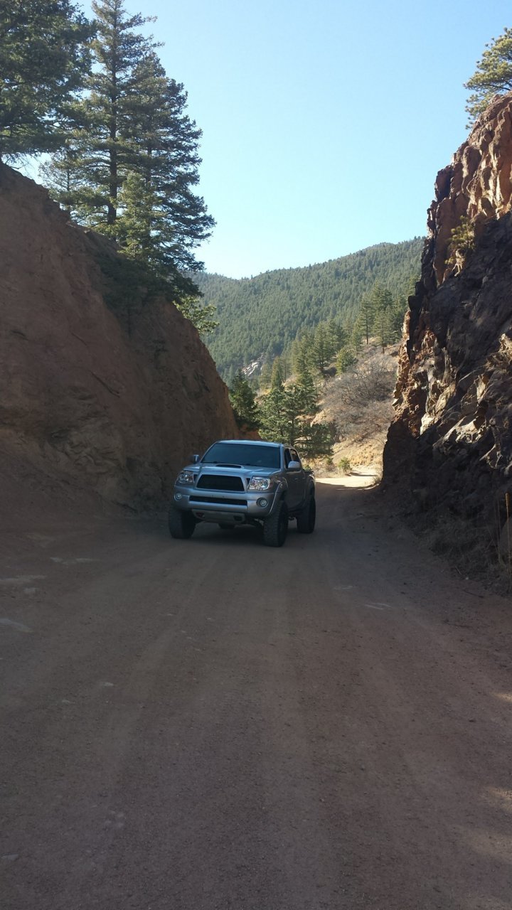

    I know every truck is diff. But I am running 887 with stock UCA'S alignment is in.
    If your not running any xtra weight up front I'd go with 887's.

    You have any pics?

    Kind of distant, but I think you can get an idea of the stance. Look at my profile pic

    Nice, what I’m looking to do also. Thx for posting.
