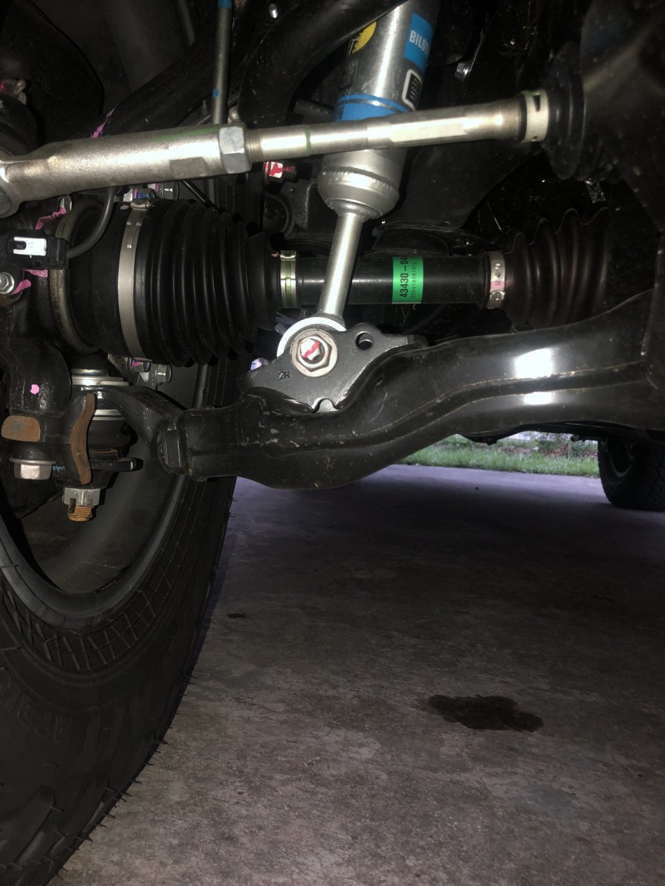

    Lol at your CV. No biggie if you wheel, you'll grenade the actual CV before the fins run through.

    Lol it looks insane eh i thought it did.
    This is the first time ive done suspension work so im not familiar. I just installed the coilovers and the ucas and thats how it looks.
    Would a dif drop even help

    No. Skip the dd.

    Lol how do i correct it then. Would alignment help

    You can do the boot slide mode to help separate the fins. Your lift will also settle some which will help it out.

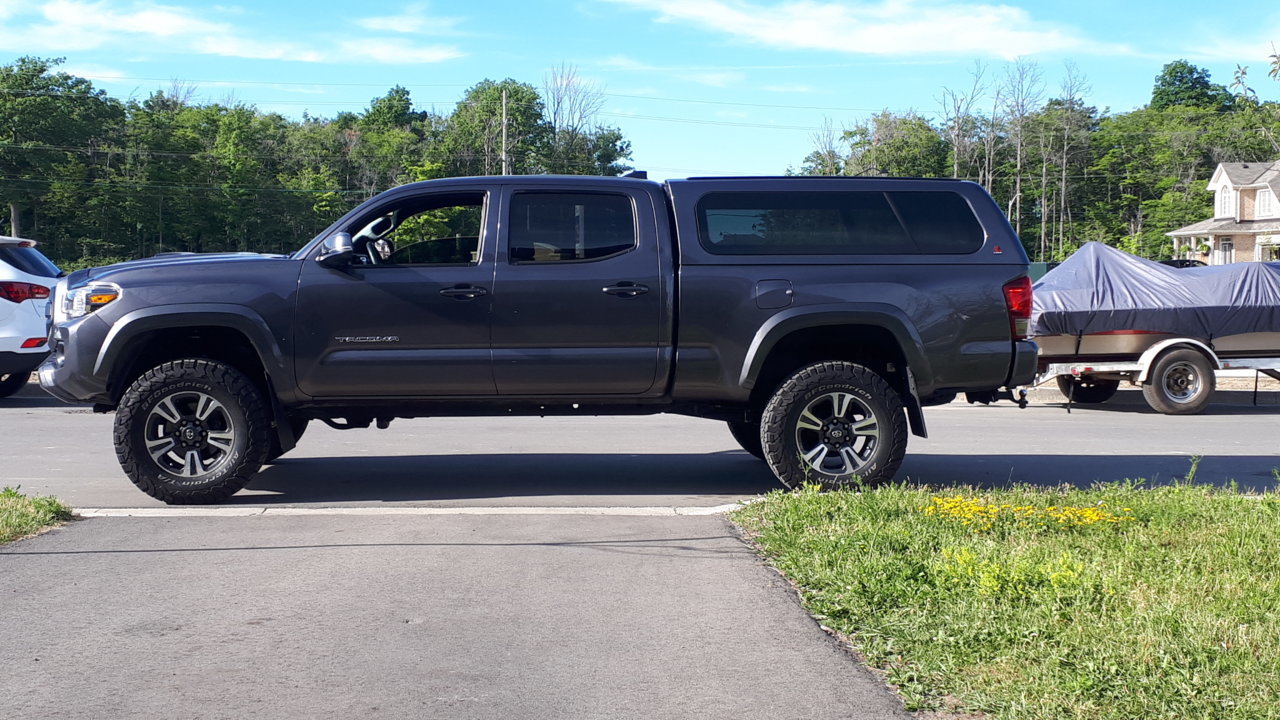

    20180621_180727.jpg 887/5100
    1/2" top plate on drivers 1/4" on passanger
    Spc uca's
    Ome nitros/ HD dakars
    275/75/17
    Carrier bearing drop
    I put a dif drop in cuz my cv angles are bad, i need to deal with that. Might take the top plates out if it doesnt settle an inch
    I have the ecgs bushing but didnt install it yet cuz it was just me and another set of hands would be better.
    Took it for a spin and no sign of any vibes yet
    Sits a tiny bit high in the back.

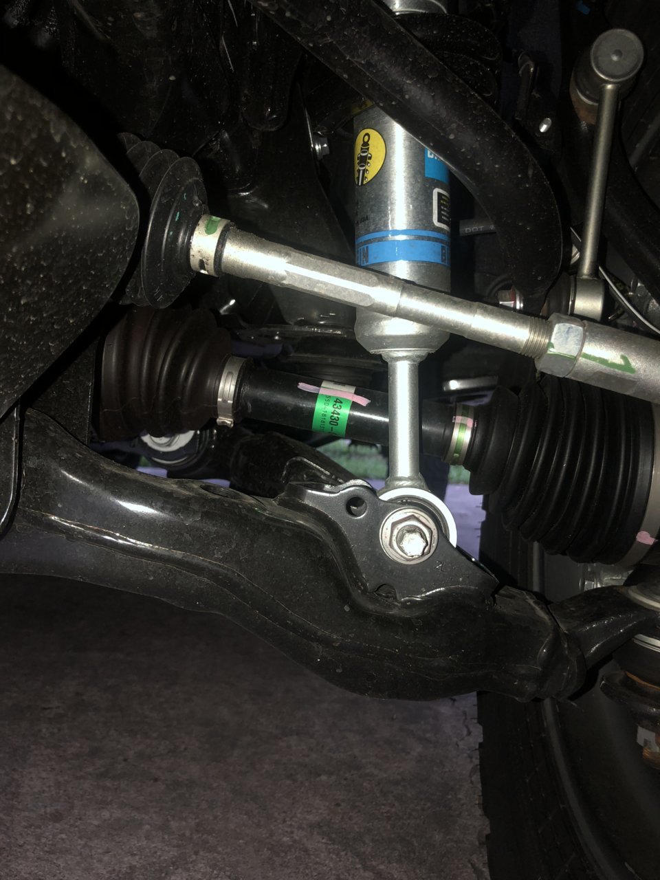

    To be completely honest, I don’t recall exactly. But I remember looking and not being shocked when I picked it up. Here is their current state...
    Passenger
    The truck isn’t on perfectly level ground at the moment though. Passenger side is very slightly elevated

    Wish mine looked that good lol
