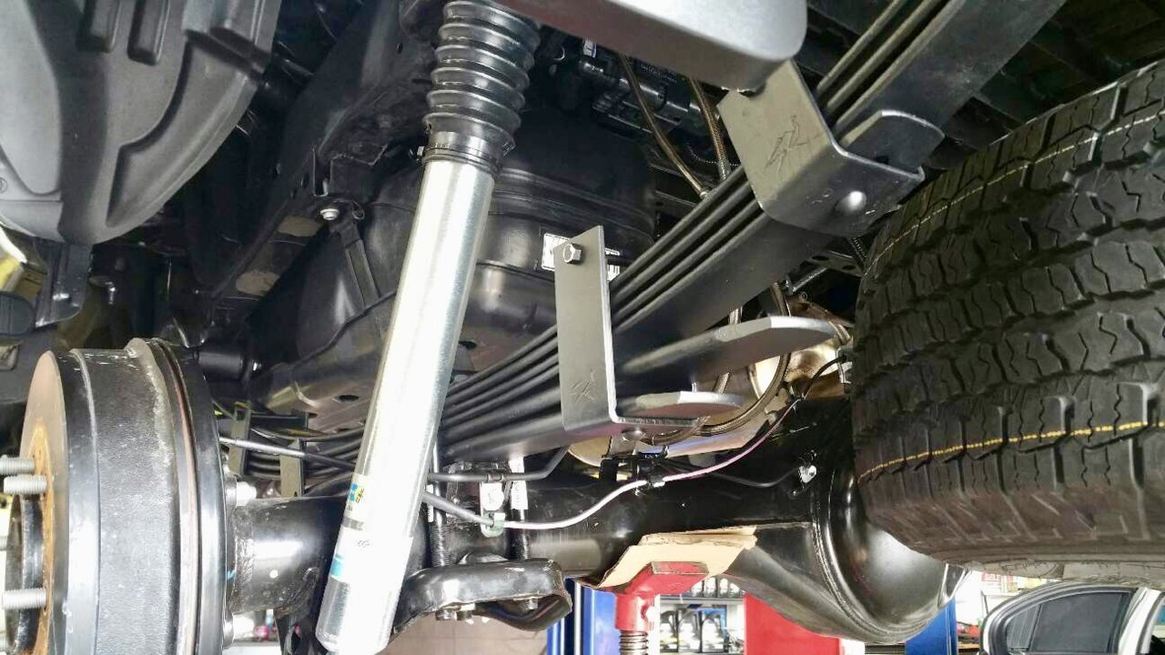

    does anyone know if 5100s in the rear without any lift blocks or aal is bad for the strut?
    I just put mine on and then realized that they might over compress since I didnt accommodate the extra length with any sort of lift. I have 1.5" aal on the way but I just wanted to put these struts on while i didnt have anything to do..
    am i going to mess them up driving around like this for a few days till my parts show up?

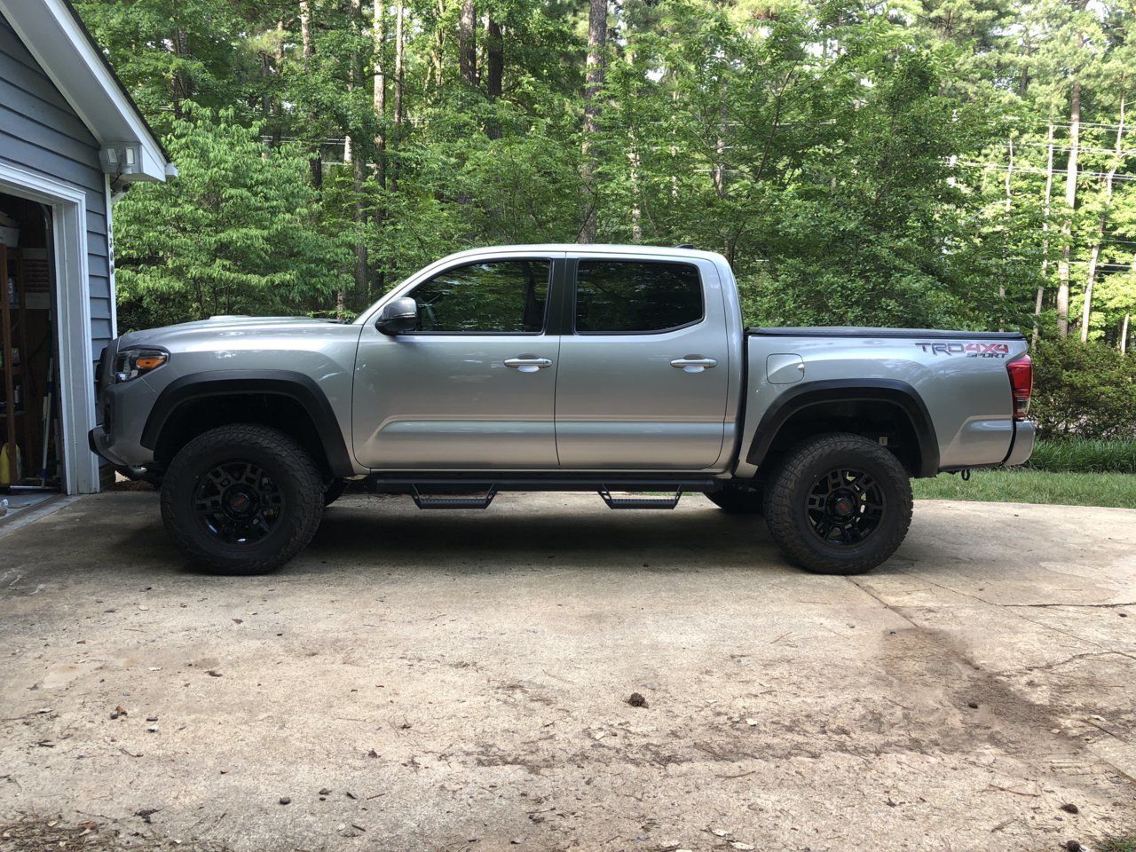

    figured i would toss a pic up here ...finished the 5100 and 887 install today. Gave me about 2 inches after settling, have a 1.5" progressive 3 leaf in the back

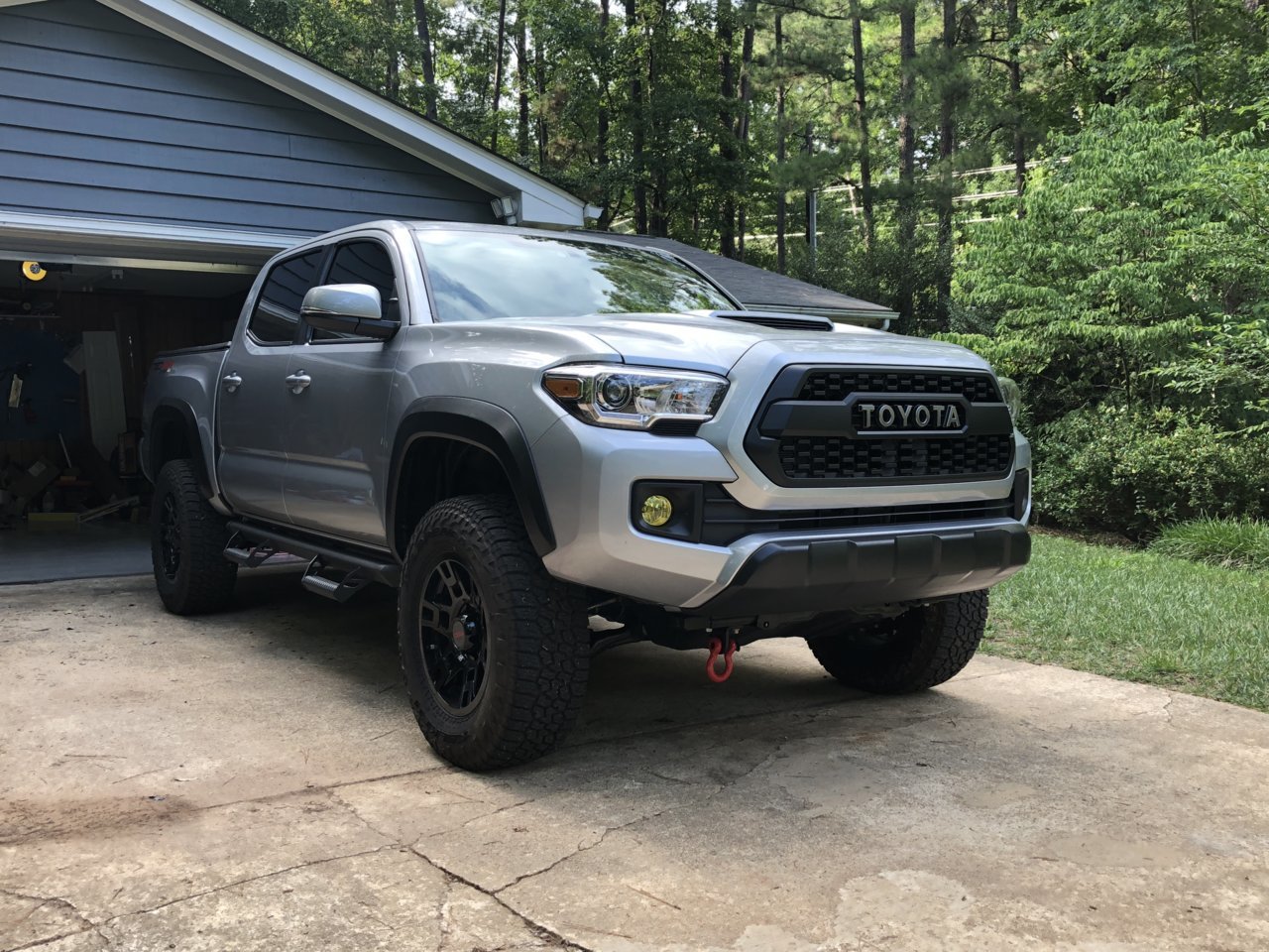

  20. Jun 28, 2018 at 8:09 AM

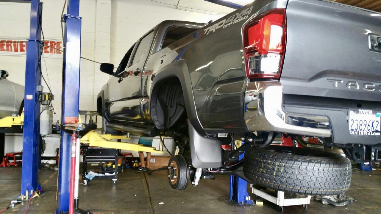

    Did mine last weekend with 887s and Dakar Medium in back. Ride is so good, but started to notice the vibration yesterday while on a very smooth road. Guess the needle bearing replacement will be sooner than I'd hoped. Would have done it during the suspension install but I ran out of time.
    On the lift to get the lift...
    One side done...

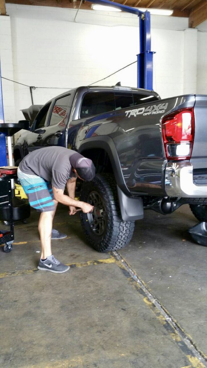

    Getting that last wheel torqued....
    Success...
