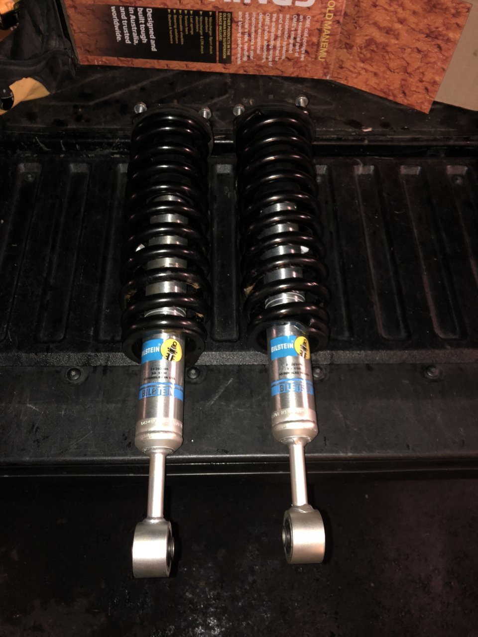

  11. Jul 5, 2018 at 8:00 PM
    #591
    Canadianguy91
    Canadianguy91 Well-Known Member
    Mar 18, 2017
    #213622
    2,219
    Sean
    Halton Hills, Ontario, Canada
    2016 Limited
    Krown undercoating, Protect a plate, blindspot mirrors, Reese stainless steel towing ball, Bakflip MX4 tonneau cover, Tufskinz tailgate letter inserts, Console organiser, Tinted windows, LED interiors, Bed lights, Hood lights, Black Canadian flag decal (@bfeth), Oem bed mat, WeatherTech floor liners, Arctic Claw XSI tires, Recovery Shackle, Ultimate LED turn signals V3 @mesojdm, OEM TRD Off-Road tow hook, Bilstein 5100's with ARB's Old Man Emu 2887 coils, ICON progressive add a leaf, General Grabber ATX tires, Fuel ripper rims, Auxbeam F-16 H11 Led headlights, Borla S-type catback exhaust with black tip, custom powertray, vinyl badge inlays, (@rrentrop), Rear diff breather mod, Redarc trailer break controller https://m.youtube.com/watch?v=qqN7m1pc6AA
    No sticking with stock
  12. Jul 5, 2018 at 8:01 PM
    #592
    Canadianguy91
    Mar 18, 2017
    #213622
    2,219
    Sean
    2016 Limited
    Step one done!
    Was cool cause I was actually able to do these myself with a little help
    TRDOBSESSED likes this.
