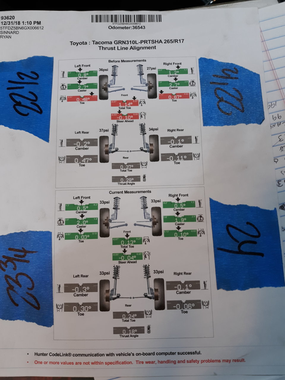

  11. Jan 1, 2019 at 3:55 PM
    #651
    jsinnard
    jsinnard Well-Known Member
    Feb 4, 2009
    #13279
    6,679
    J
    Virginia
    16 QS DCLB OR 4X4
    I did. I ran the stock UCA when I had 885 and alignment was ok, once I bumped up to 887 and SPC UCAs, the alignment is so much better, easier to get back towards factory spec.

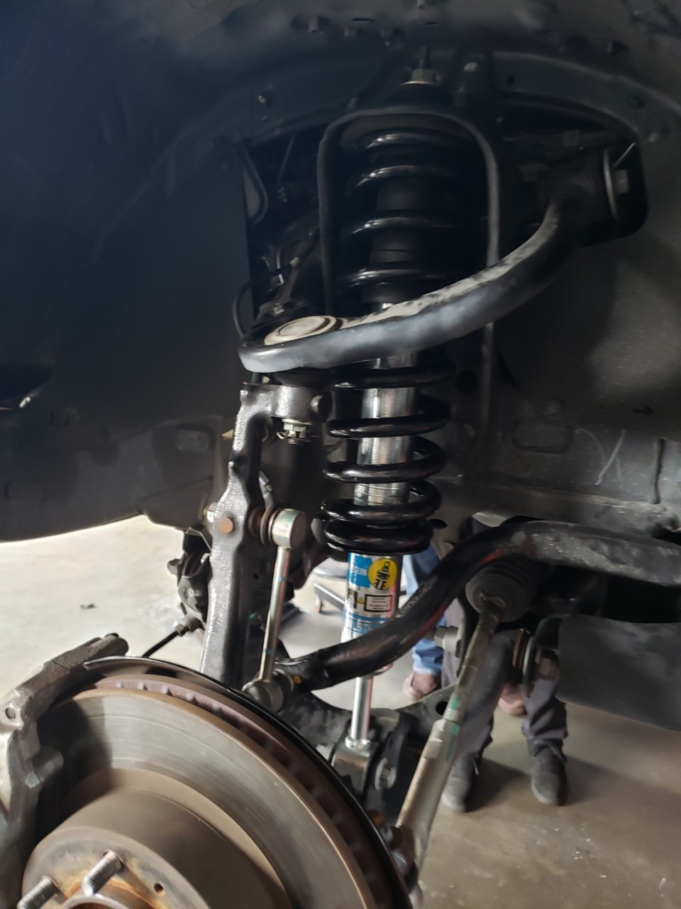

  13. Jan 2, 2019 at 4:20 AM
    #653
    jsinnard
    Feb 4, 2009
    #13279
    6,679
    J
    Virginia
    16 QS DCLB OR 4X4
    Still waiting for the 887s to finish settling but I'd say right between 1/2 and 3/4 inch.
